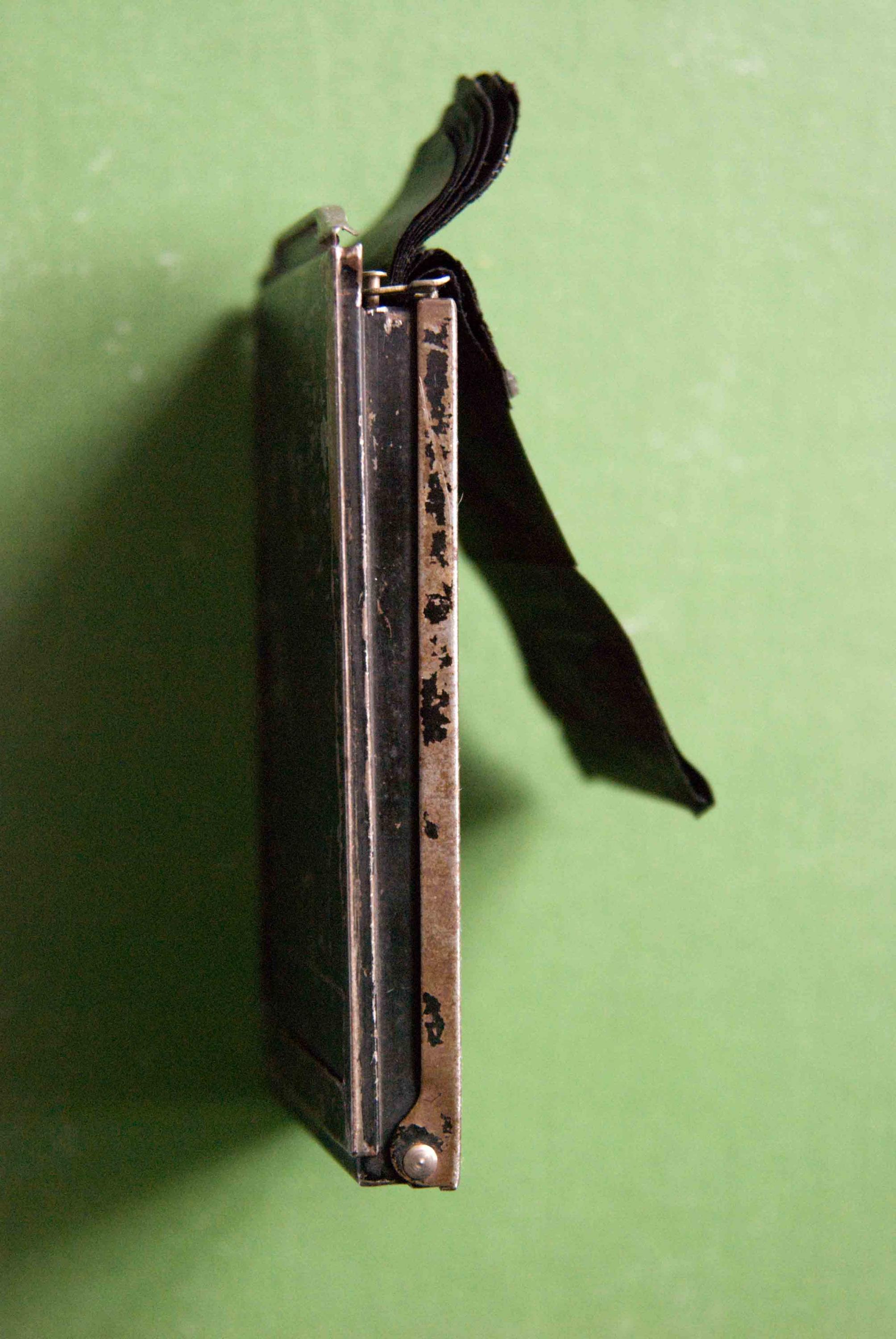

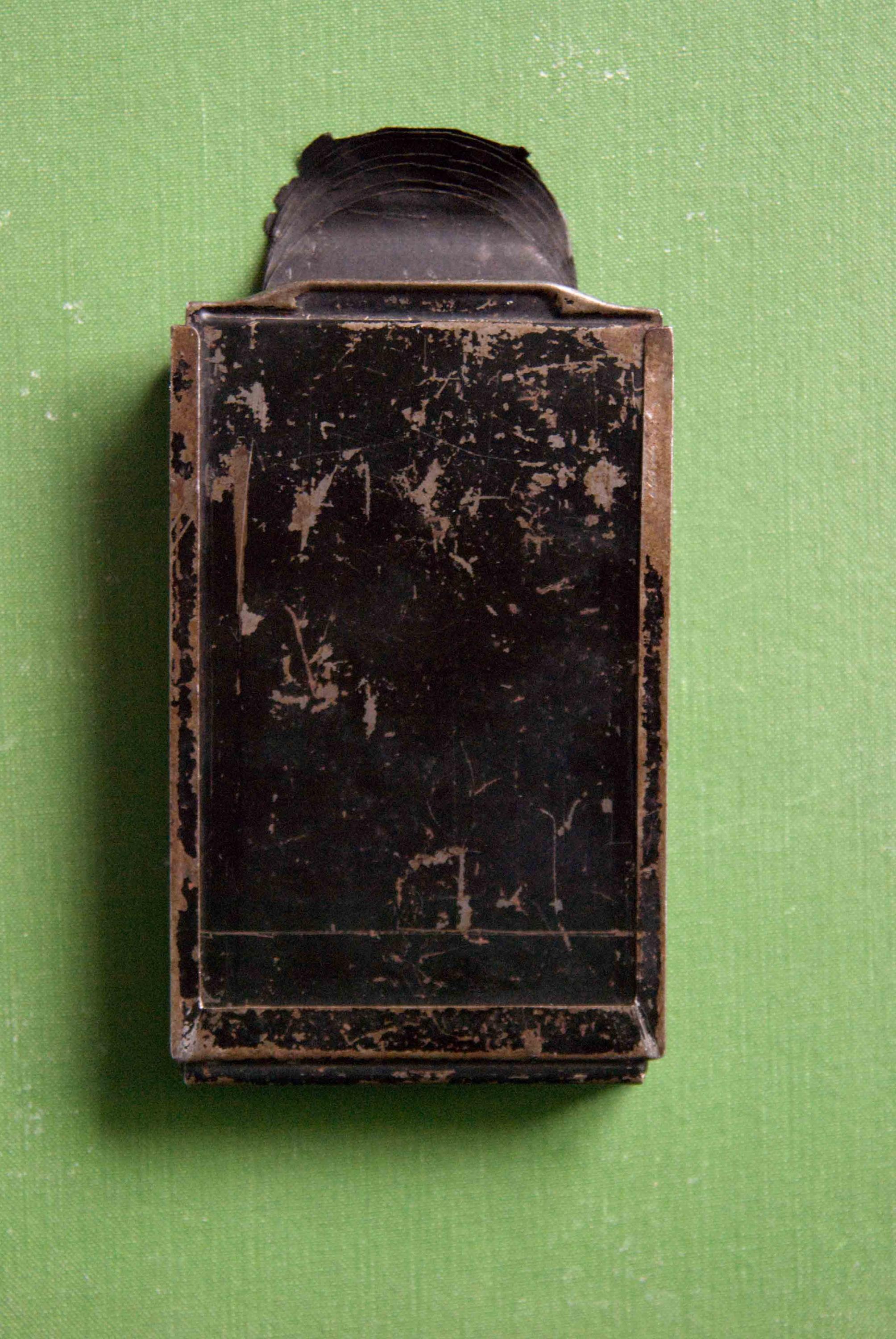

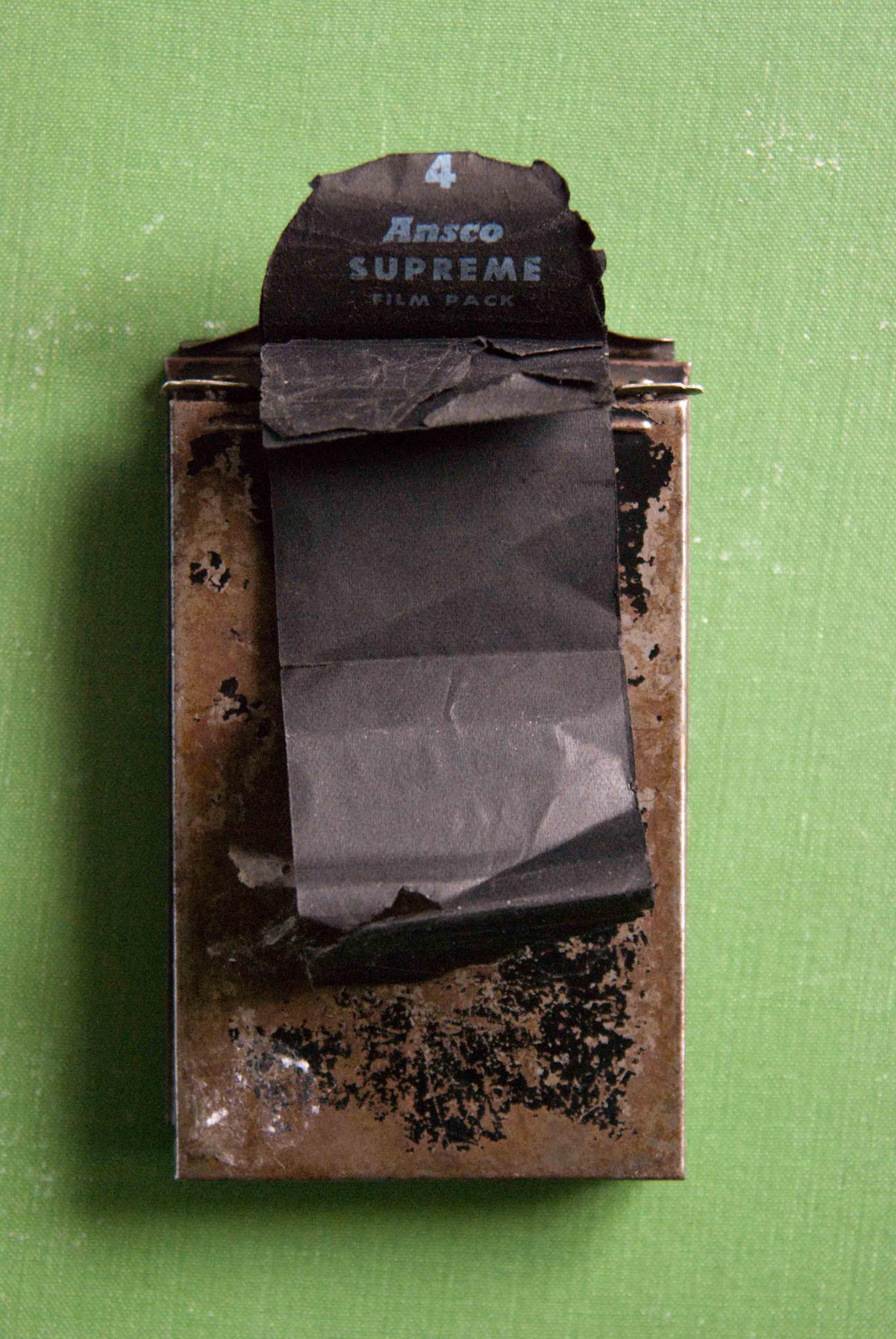

I've uploaded some shots of the pack, so you can get a look at it.

You should be able to "rob" the pack of an individual sheet of film to develop and test the exposure. The Ansco pack will probably much the same as a Kodak film pack. Based on a Kodak pack, after exposing a sheet pull the tab that moves the sheet to the back of the pack. In the dark open the pack holder and remove the film pack. Then open the the film pack by removing locking end and take out the single exposed sheet and process it. Reassemble the film pack and put it back in the holder. Be careful when opening the film pack because the metal parts of the pack are sharp and you can cut yourself very easily.

On the Kodak film pack after you have made your exposure you pull the tab out as far as it will come. You can then either tear the tab off or leave it attached. So I would expect that if the number 12 is showing then 12 exposures have been made - most Kodak film packs held up to 16 exposures. From the pictures you posted it looked like three exposures had been made and No. 4 was ready to be used.
I pulled one of the tabs today to see if the sheet pulls out, but instead it ran backwards and underneath and to the back of the pack on it's own. and then you remove the tab, so it looks like the ones at the back are probably broken rather than exposed.

All film packs are designed to work as you indicated. When the tab is pulled the film is moved to the back and a fresh sheet is ready for exposure. To remove the film it is necessary to slide the removable part at the top near the tabs, take out the sheet i nthe back and replace the sheath.
Add some potassium bromide to the developer and yo are likely to find the film usable.
