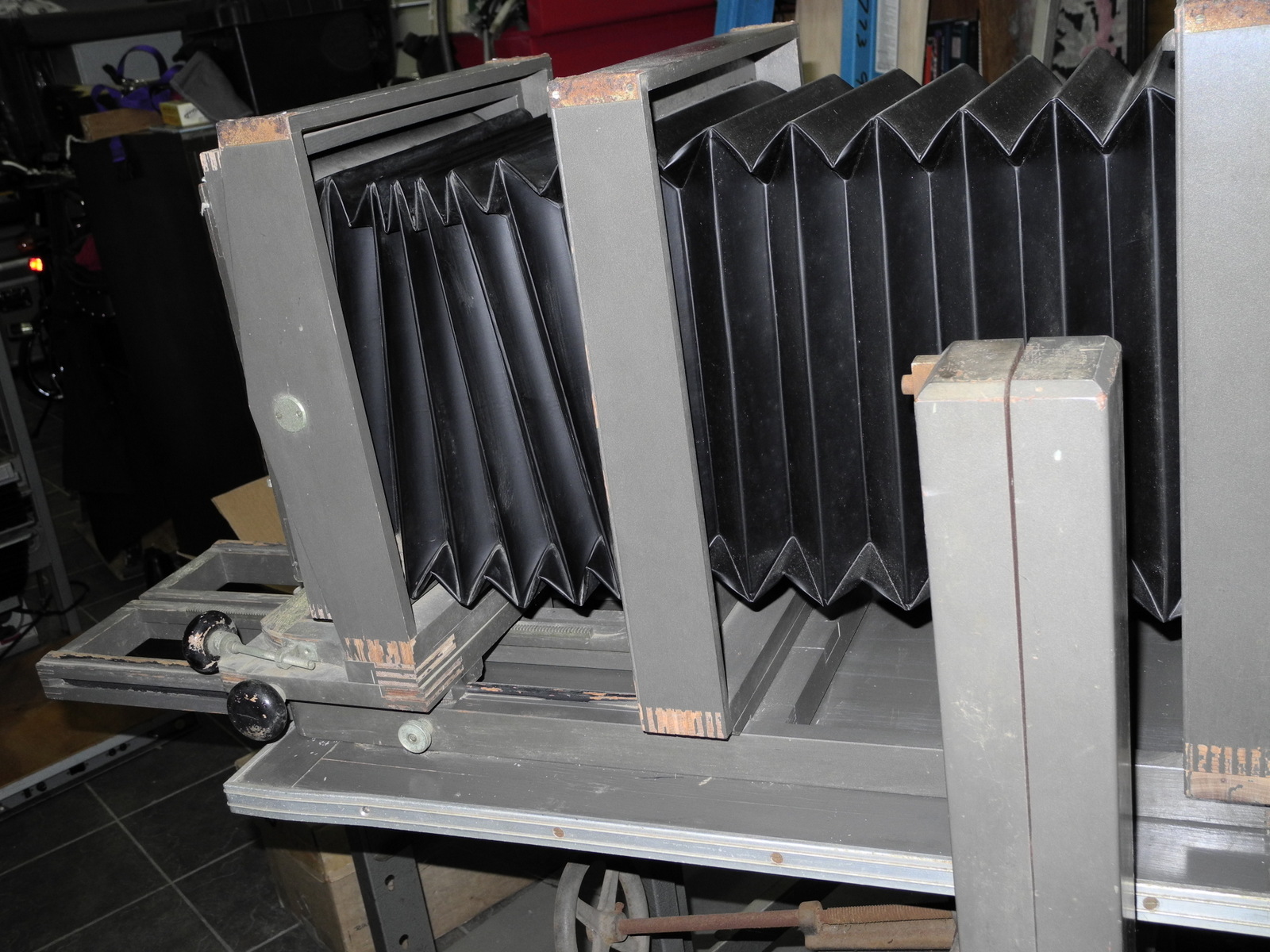

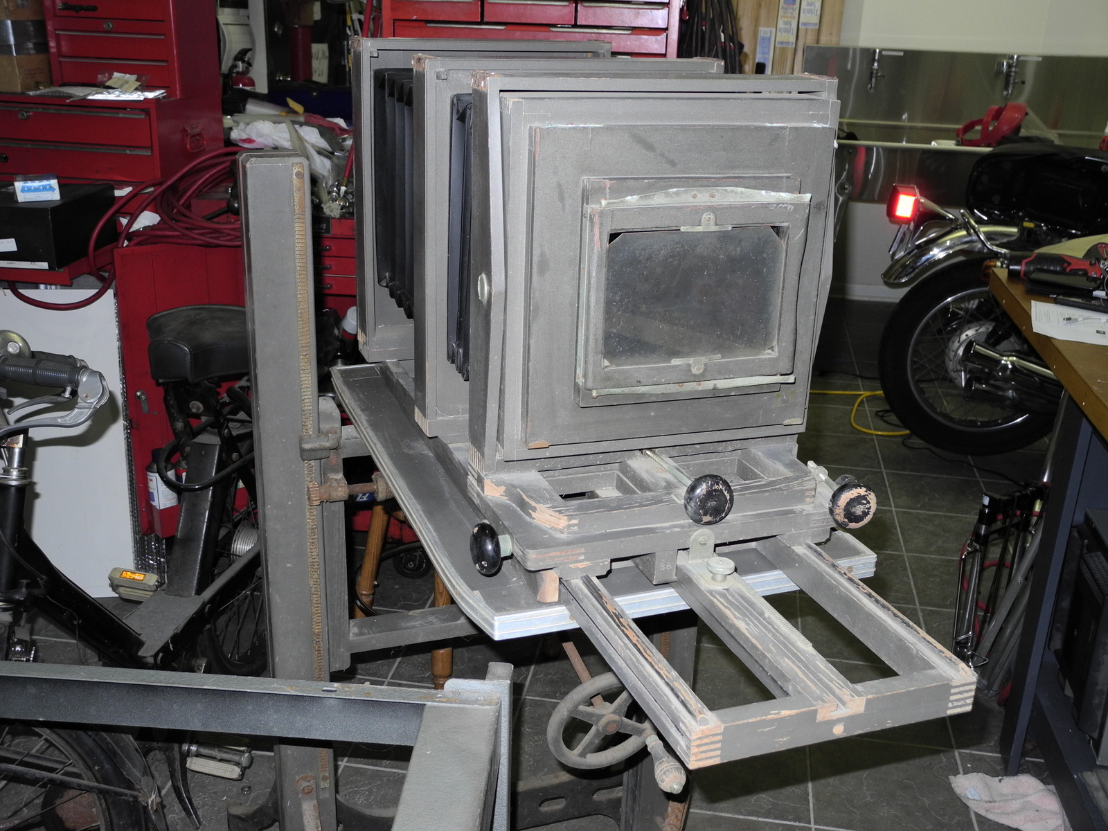

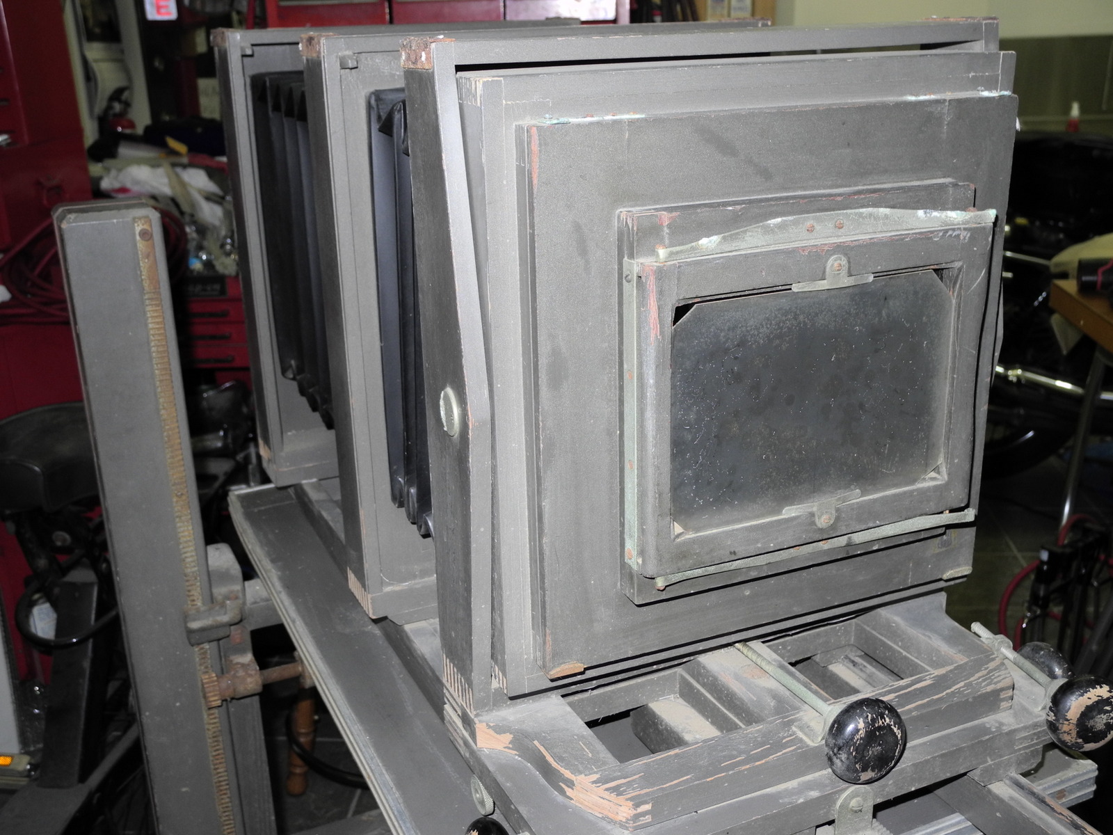

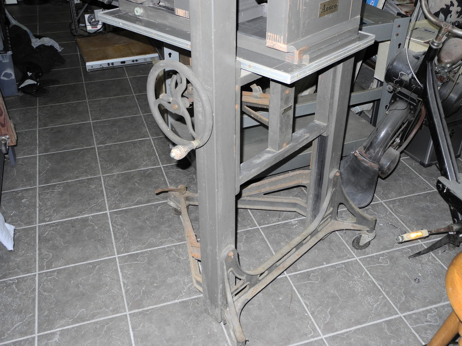

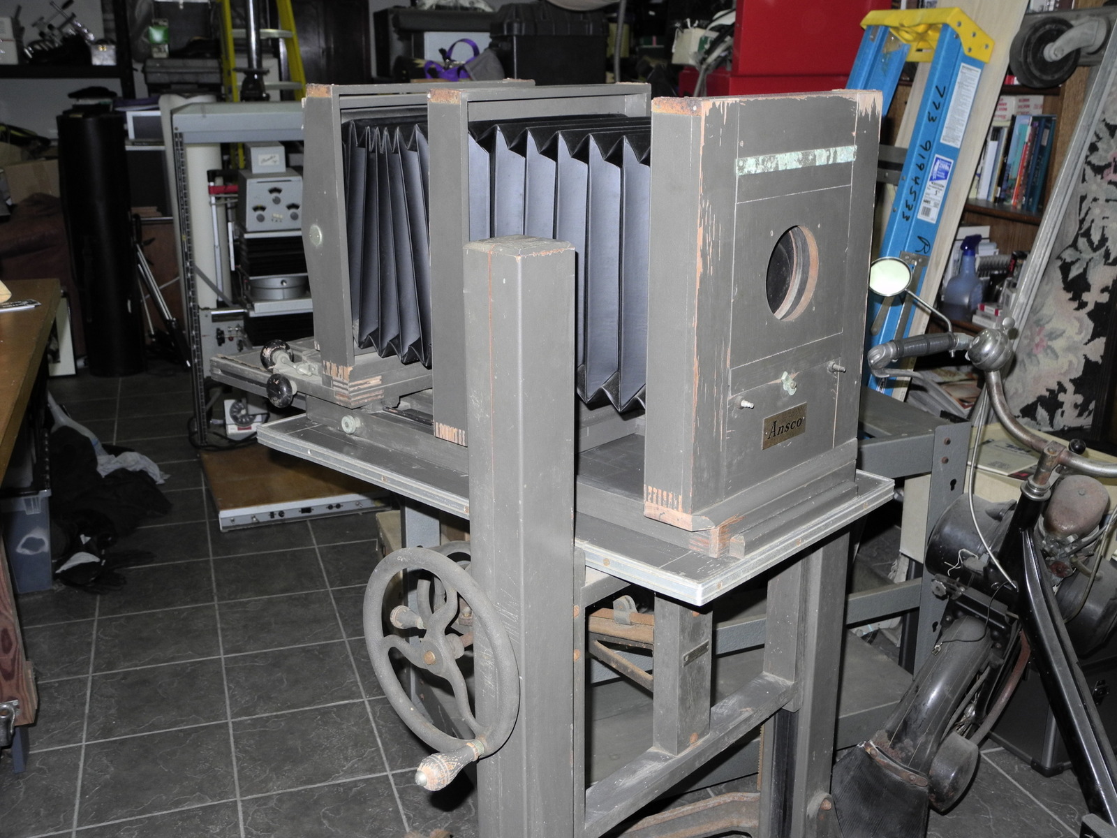

Today I brought home an Ansco Studio #5 has #38 stamped on bottom. The bellows are excellent. Everything works except rear focus gearing. I bet I can fix that. BUT it is ugly. Factory grey peeling all over with plenty of rust. The thing is fairly tight with the joints swelled and paint gone.
I do want to shoot with it and it came with a working 4.5 inch double piston Packard. I have a few barrel lenses.
It needs oil on all moving parts. What type of oil is good? Thinking not motor oil as some will drip onto unpainted wood. Olive oil? Linseed oil? Ideas?
The bellows are so nice and extremely tough, that I do not want to remove them. I could scrape the existing paint, but it seems to be coming loose all over, except under the standards near the bellows.
I could scrape and repaint grey or I could be an idiot and try to 'improve it' with natural wood finish.
I have read quite a bit here about refinishing horrors and endless projects.
What do you people think?

First, the camera looks very nice to my eye. Looks like it just needs a gentle cleaning and minor metal work.
If you really intend to use it, my sincere advice to you is to do absolutely the minimum necessary to get it in usable state and then, use it! Perish the thought of stripping paint or doing anything like it until you've worked with it for at least a year (or 100 sheets of film).
Also, if you do decide to strip or scrape the paint, do not even think about doing it with the bellows in place! It really is not difficult to remove the bellows.
This advice is based upon my experience with several restoration projects. The last, an 8x10 Kodak 2D, took me full two years to complete...it was a tear down, strip and complete refinish. Yeah, it was beautiful when completed but, in retrospect, it was not worth the effort. Contrast that to one of my first restoration projects, an 11X14 Century studio camera...completely disassembled and cleaned everything and then put it back together...total time: about three weeks.
