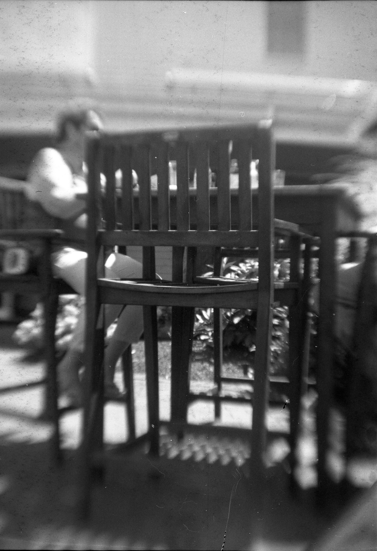

What I got:
(shot was hurried, a bit blurry, my fault)
Now, in retrospect, when first spooling the film, I experienced a little odd feel, and dismissed it on account of the camera being of cardboard.
Actually I can produce a B setting on the camera by removing the front of camera and manually stop the round metal mask mid-swing. I did that to clean the lens last night, and will do again to get the wax paper sighting.

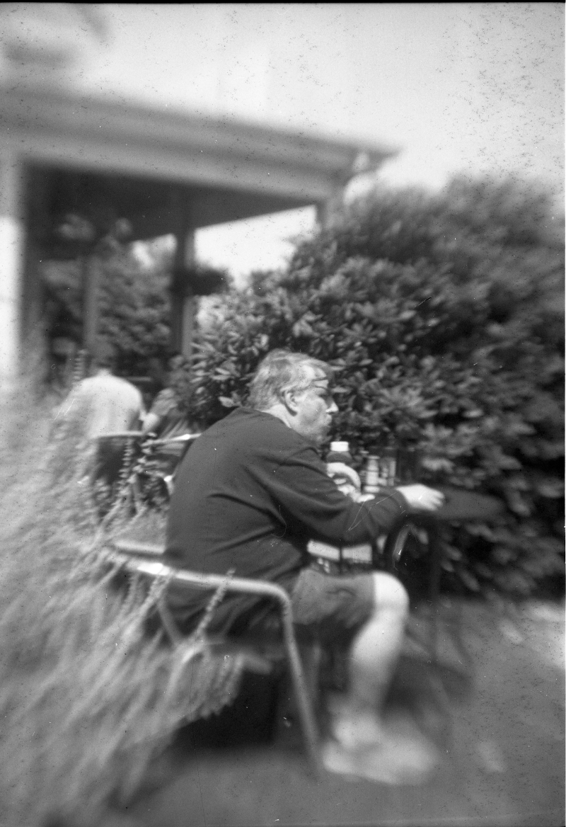

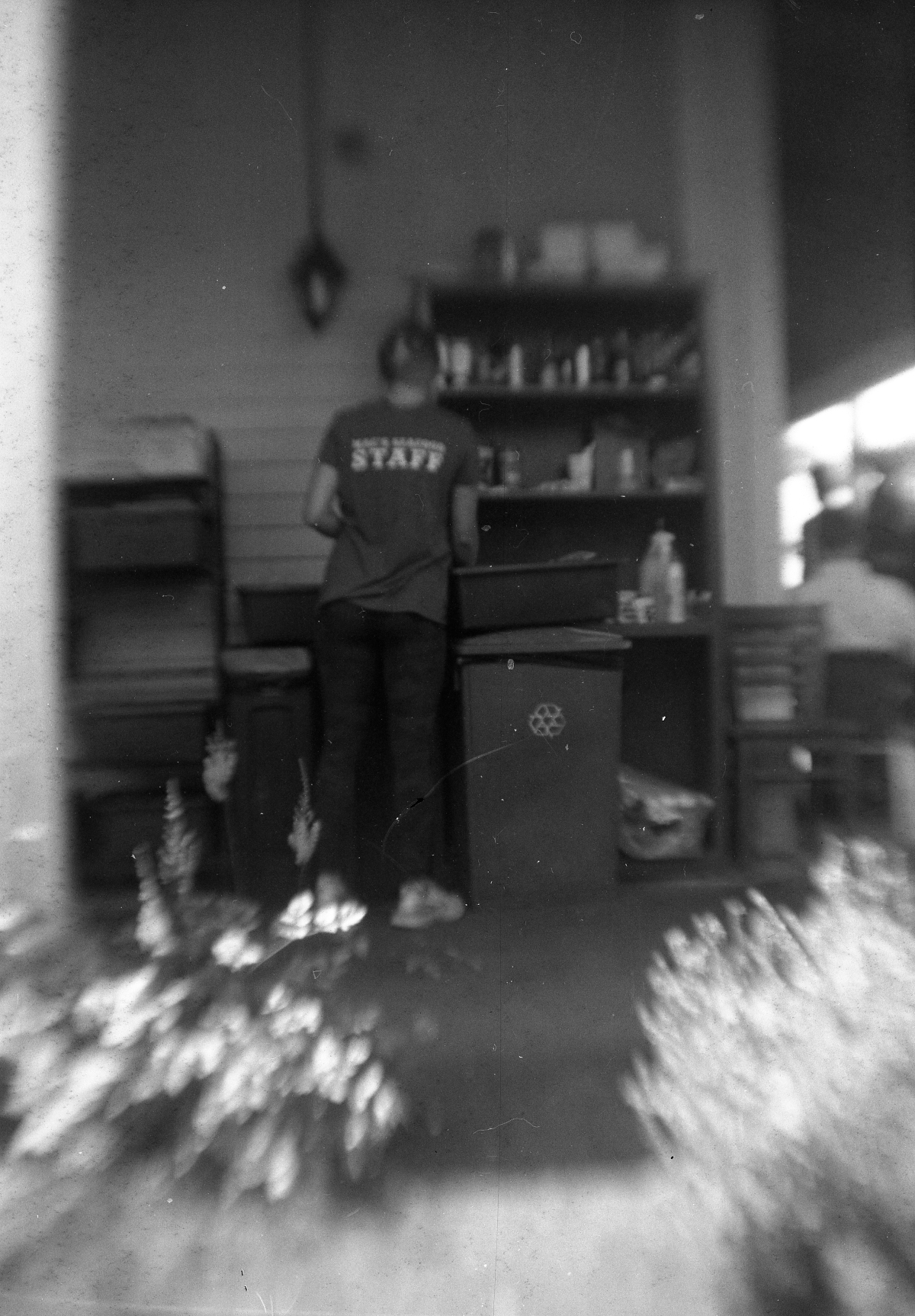

Well @jnantz and @Donald Qualls, the concave part of the lens faces the film side, so I have a flipped-lens box camera?:smile::surprised:
One of the other frames, a person sitting at dining table, is very flipped lens style, to the point of being dramatically interesting:
Update: I compared this lens with the other, same Shur Shot model, so lens is flipped.
What to do now, set back to normal?
