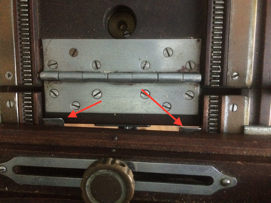

2. Please take a look at the pic - it appears that the front carrier is slightly off track.
And also the tabs seem to be bent.
Should I remove the front folding extension to get the tracks aligned and what are the tabs for?

Do some more careful checking. While the track on the left has 7 teeth showing and the right has 8 the gap between the sections appears wider on the right.
As long as the standard remains square to the base and/or camera back when zeroed and moves smoothly across the gap I would leave it alone. If the standard is not square when zeroed or binds at the gap then I would adjust it so that it does.

The tabs are stops. I'd presume they should be bent at 90 degrees to the long dimension.
The carriage should work smoothly and I'd think that the gaps not being equal will not allow it to work right.
At least one screw's been replaced, the crosspoint on the left should be a straight slot.
I would take the front ext off and take a look, the way one stop is straight and one bent suggests it was dropped.
Poll the hinge entirely and see if there's any damage to the screw holes too.
I notice the slotted screw on the left isn't aligned with the one below it. Check the rest of the camera
to check the other screws, if the slots are parallel then someone/ had that apart too*
*Some older cameras had all the screw slots in line when they left the shop as a sign of good craftsmanship.

My Ansco 8x10 frequently gets off track and mis-aligned like yours is. I don't know why or when it happens but it does. Its easy enough to get straightened out. Mine doesn't have those tabs.
