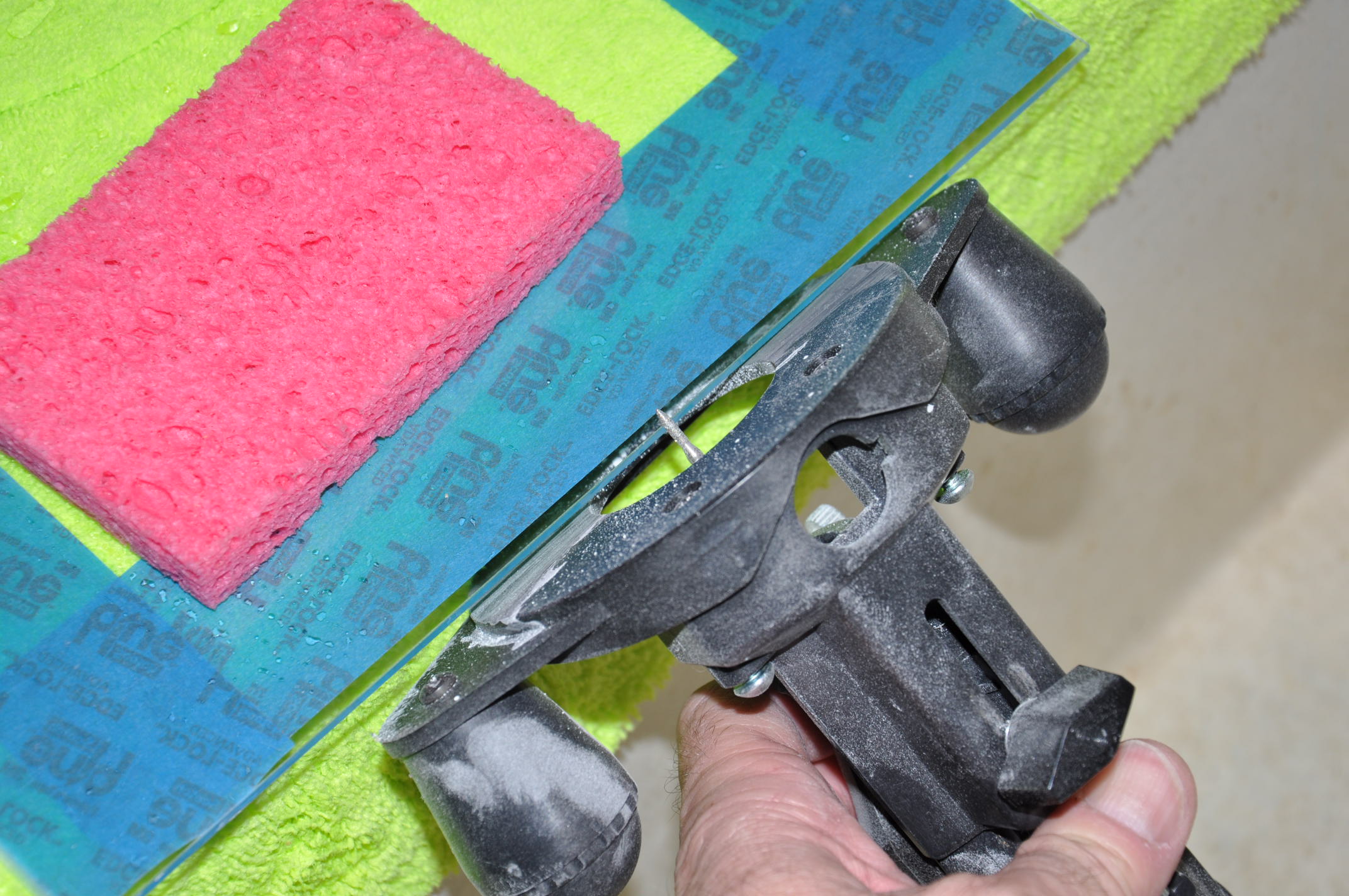

I recently got $600 worth of 3mm x 10"x10" AN glass for my Durst enlarger. Crazy how after they shipped it I was informed they could not bevel the edge. So I did it myself. The glass was just as sturdy and any other 3mm glass and the hand beveling went fine, though very time consuming (top photo).

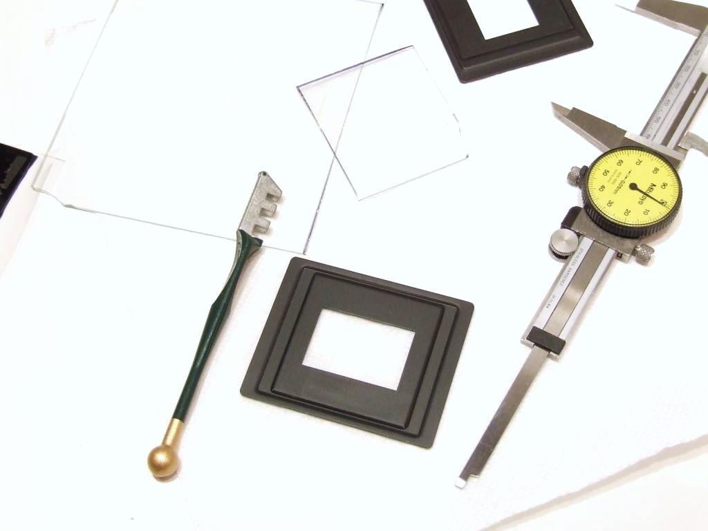

I have also successfully cut thinner AN glass (bottom photo) but with great care as it can crack easily.
