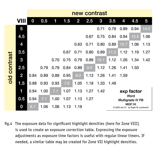

I think the question was if highlights are affected if one switches from one grade of paper to another. Well, if you follow AA's way of printing, 'expose for the highlights and correct the shadows with contrast', then they are! But, that's not a job stopper, because you can easily compensate for it with a customized table.
Ralph,
I see in the image that you attached is compensation for the same
type of paper that I use. Could I use these values or should I perform
my own tests with my setup ?
Thanks again !

Ralph,
Thanks again !
The contrast values you see in the table are ISO grades not filter numbers. If your system is calibrated to ISO grades, you can use the table as is. Otherwise, you need to do your own test.

You are right that the table is only a guide, but it is a very good one. The whole thing about visual inspection is OK, but it has its own set of problems. Tired eyes see things differently than fresh eyes to name one. These tables are not the only way to print, but they help to cut down on subjective analysis and make printing efforts more consistent.

Ralph's chart will save you money by getting you there faster - it can help you make a satisfying test strip with best exposure in the middle and with darker and lighter choices.
