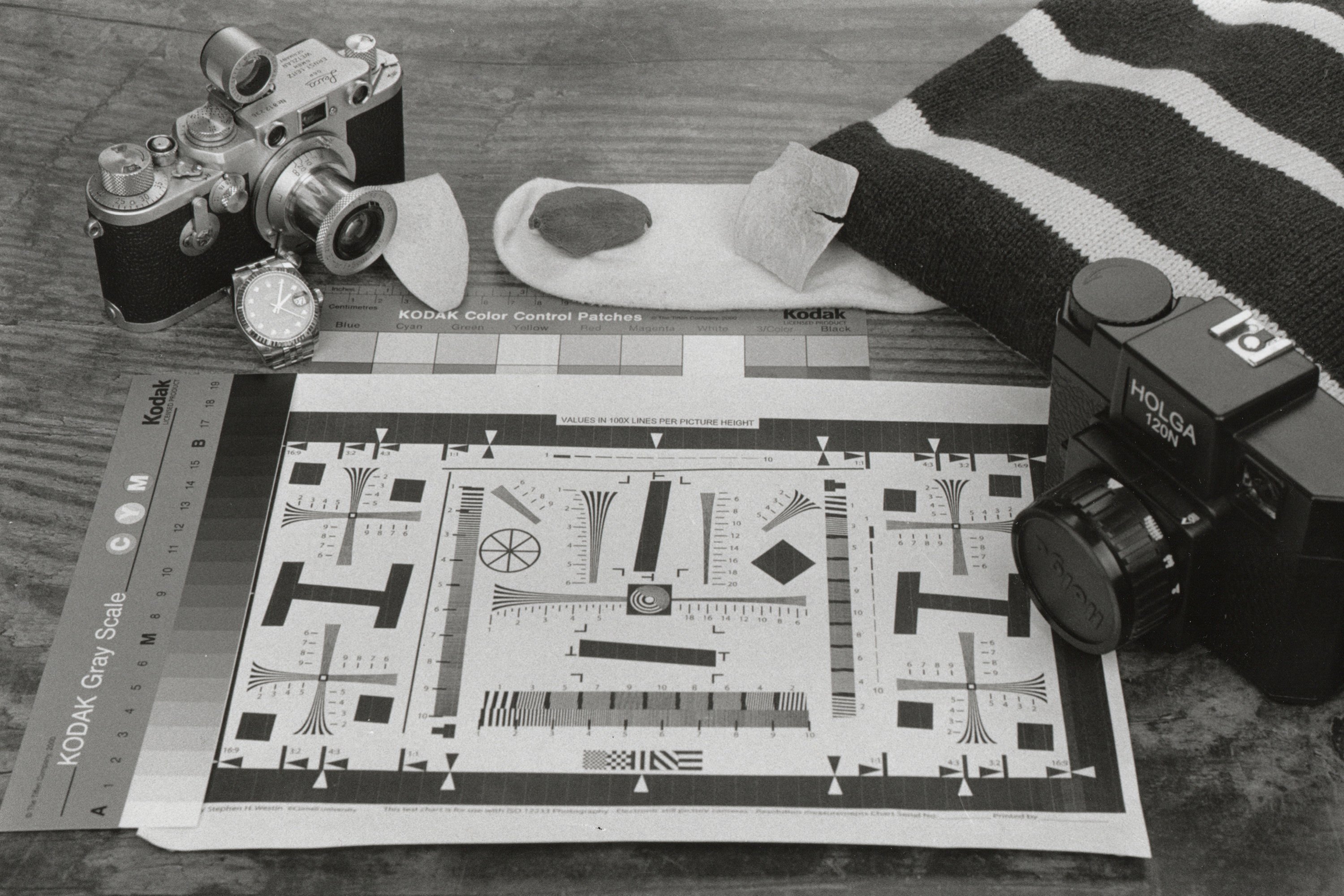

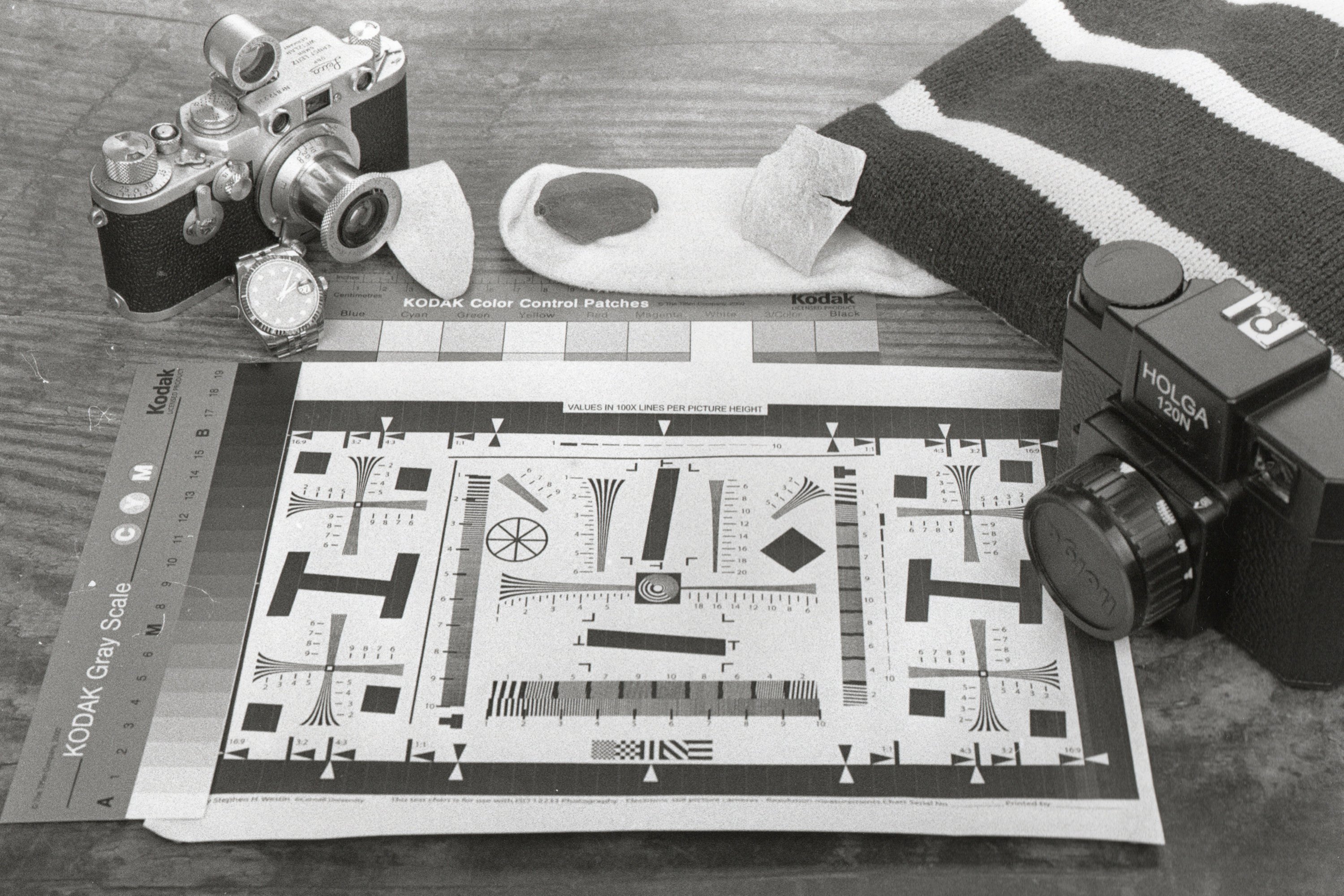

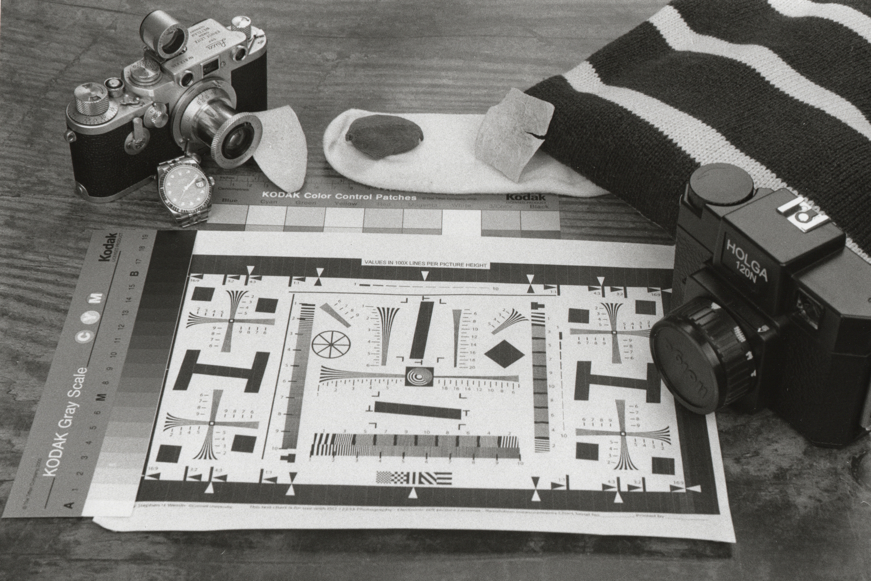

Here's another "unscientific" comparison of 3 developers, this time around with HP5+.
Here are the three print scans (8x10 on resin coated, different print times trying to match the highlights from the step from the gray scale on the left).
(After clicking, if you use the "open in new window" arrow at the top right you can see it at max resolution allowed on this site to fit size restrictions).
D23:
HC-110:
Rodinal (semi-stand):

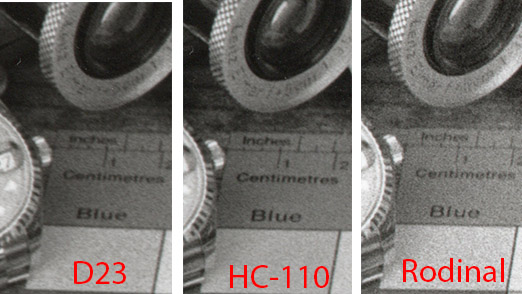

A detail from the top left:
and one from the bottom:
Things that stand out to me:
  • Rodinal semi-stand shows a gradient in the density from bottom to top, could be a side effect of stand development?
  • Rodinal semi-stand has greater shadow detail
  • Rodinal is obviously grainier, while D23 and HC-110 are pretty close, with D23 having a slightly finer grain.
  • Based on this comparison, I don't see a reason to switch from my usual HC-110 developer to D23. They are very similar to my eyes on the actual print at this size.

Thanks for the link from the other thread.
Developers are always a personal taste and from your test I would be happy with any of them. I do like your D23 if only because it is such a simple to make developer at home, yet produces great results.
pentaxuser
May 9, 2005
19,983
Daventry, No
Thank you, sterioma... It's refreshing to see a test without film scans.
Thanks Sterioma and, yes, I agree wholeheartedly with Juan on his comment above. Both the D23 and Rodinal seem to give a more contrasty and maybe for that reason, a brighter look which I like but that is just my opinion. Others may prefer the lower contrast of HC110 which gives the greyer look
However I thought that these pictures "rang a bell" in my head and for good reason. Thyey appeared in an earlier thread and there I declared for D23 and in those pics having looked at my comments there I stick by what I said. The Rodinal one especially loses highlight detail.
So presumably other factors are at play which changes things?

Nice comparison! Interesting to see how close the D23 and HC were. How long did you leave the Rodinal to develop, and did you do many inversions? I'm a fan of stand Dev with Rodinal, usually do 60mins with 2 inversions at 30mins and never had any density gradients as far as I can tell. That said, your test seems much more scientific than any I've done. Great contribution.
Lachlan Young
Dec 2, 2005
4,945
Glasgow
The unevenness of the Rodinal example is almost certainly an artefact of (non-)agitation - and the more open shadows are likely because it didn't develop to the same overall density - highlight density, curve shape and effective shadow speed all have a set of interactions which may not be as clear-cut as you might assume.

I did 60 minutes with 2 inversions at 30m, dilution 1:100. I think here it's easier to see as there are other prints to compare it to. All of the 4/5 negatives of the strip developed with Rodinal had the same pattern.
