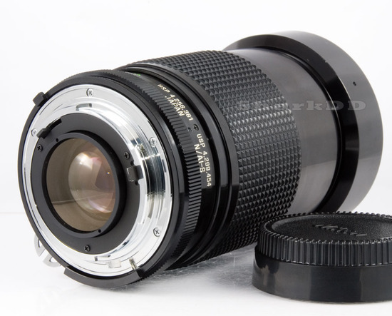

So I found a supposedly rare and exceptional Vivitar Series 1 28-90mm f2.8-3.5 in Pentax A mount. I was shopping for a lens in that range and this one was in mint condition at a great price so I picked it up. I tried it out on a Pentax digital body and found that it was overexposing. I put it on one of my Super Programs and opened the film back so I could watch the aperture and sure enough, it is closing almost imperceptibly more slowly than it should. I mean, you really have to be paying attention and watch several times to really be convinced that the lens has a problem.
I sent an email off to Vivitar and they replied very quickly that this lens was made before the company was bought out by another so they conveniently washed their hands of the problem, ststing that they would not attempt a repair.
I figure that I'm not into it for that much and a repair may exceed the value of the lens so I might just attempt it myself. Has anybody here ever disassembled this lens? I've spent some time poking around for a tutorial with no success. Can anyone point me to an online tutorial or video of this lens being torn down or reassembled?

If it is not an expensive lens and you can cope with failure then have a go yourself. Looking at a photo of the lens it looks fairly easy to get near the shutter leaves. The smallest drop of lighter fluid on the end of a needle will spread like wild fire on the leafs. So don't splash it around or flick the aperture arm quickly. Just move it slowly and keep the lens on its side till it does. Let it dry then the leafs should work freely. The lighter fluid un-glugs the old oil. Too much lighter fluid will remove the oil and the leafs will go dry so use the smallest drop you can. I have fixed a few like this and they are still working fine. Good luck.

Ctrout, from pictures on the web you may need to remove the rear element to prevent accidental damage, this will depend on the camera mount system. The screws that hold the mount ring to the lens barrel may be set with a thread locker that has to be dissolved to remove the screws, finger nail polish remover should work for this. Extra fine powdered graphite can be used on the aperture blades to improve their operation.
When removing internal lens cells their exact position must be maintained on reassembly. Some lens use stop ridges inside the lens others use stop rings that must be unscrewed before the next lens element can be removed. Count and record the number of turns. The outermost elements may have shims under them, they must be reinstalled on reassembly.

Will we (I) ever see a picture of the rear of your lens or do you feel competent to tackle it?
ctrout
May 25, 2012
46
As I have read elsewhere and based on the parts diagram of the lens, it appears that the diaphragm is located behind the second element and is accessed through the front of the lens. As soon as I get my hands on a proper spanner, I'll probably just tackle it myself. If I'm going to be involved in this hobby, I should probably eventually start learning how to do some of the more common maintenance tasks. I mean, if I was able to keep F-4s, F-16s, A-10s, and F-15Es flying for 21 years, I don't see why I couldn't take a crack at this mechanical device.
