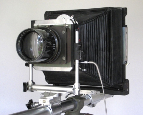

Here is a pic of a 36cm Heliar on a Norma with the lens pushed away from the front standard by an LPL mouse-trap (rat-trap) shutter, which will go as soon as I find a Heliar lens flange - There is need to push the lens away so it clears the Sinar Shutter
The front standard does not slip even when a bit of forward lens tilt is used - No Jim, you have got too many already!!!!
