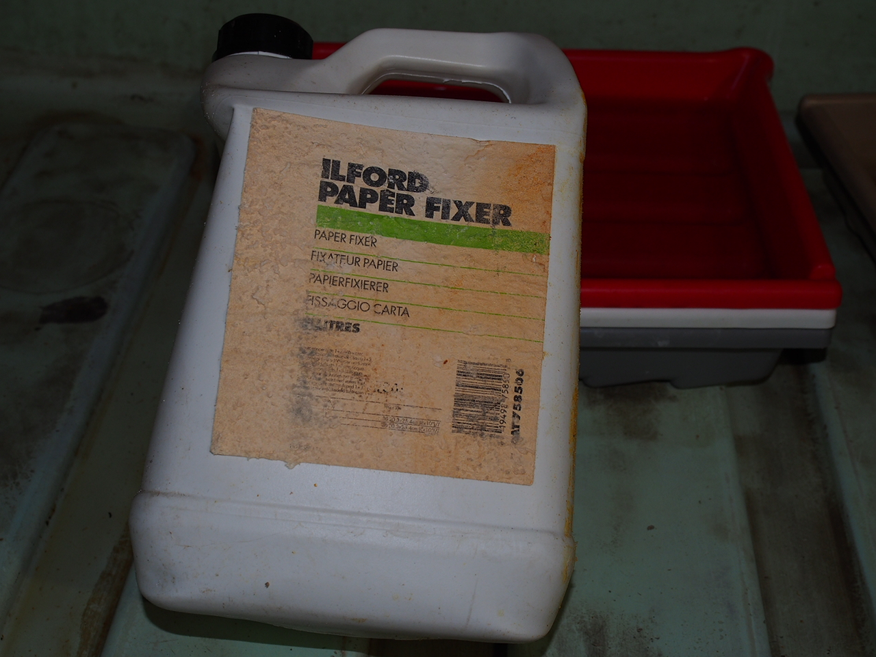

I have acquired a unopened 4ltr container of Ilford PAPER developer fixer not Rapidfix!
Does anyone have any idea why they would produce a fixer just for paper?
I will try it and use hypo check to verify its condition plus the twice clearing time, for film, which is usually about 1 minute.
My question is curiosity driven not technical.

Correction it is Ilford paper fixer not Ilford rapid fix.
I'll fix this before long!

"Fixed" that for you.
I'm guessing that that was designed for the Ilford print processors - and must be really, really old!

Great, we know know it's a fixer, not developer we're speaking to so no confusion there.
As to why Ilford makes such a product, I'm sure someone has the scoop on that.

I expect the label would refer to Ilford Imaging, rather than Harman Technology, which would mean that that is at least 20 years old - not likely to be usable.
Ah...not too quick. It might be. I've seen *very* old jugs of Ilford fixer pop up (same age as this) that turned to be perfectly fine, still.
OK, but what's more important is to verify if there's any sedimentation or cloudiness. Before opening it, shake the jug vehemently for a few minutes - really hard! Then pour out some of the concentrate into a plain glass beaker. The liquid should be absolutely perfectly clear. If there's any cloudiness or flakes drifting in the solution, it has started to 'sulfur out'. If it's perfectly clear, do a clip test to see if it clears rapidly. If so, use without reserve.

If there is anything at all like precipitate, particles floating around in the concentrate, or deposits on the inside of the jug, then the fixer is dead. You could use it for 100+ rolls of film and underfix and ruin them all; or you could spend $40 on a jug of new fixer and save all that money you would have wasted on film :smile:

I would only consider using it for RC contact proof sheets.
I think you are correct.
It came with some other old darkroom supplies I purchased from an older newspaper photographer from central BC.
The rest of the purchase was much newer including some Ilfosol which still worked as it should.

I think the fixer is the same as Ilford RT2000, for machine processing use.
I opened the jug and the chemistry is as clear as a bell.
I then mixed it at the suggested, for RT2000, 1:4 and dropped in a piece of unexposed film.
It cleared within 30 seconds.
