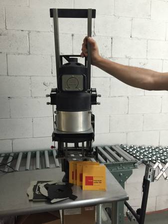

I wish I could answer these questions with confidence, haha. Here is a picture, I am still awaiting a reply!
Thats a nice looking startup enlarger , get your feet wet and see if you like printing. Then you can find a good deal on a more significant enlarger.
QUOTE=Sceptic;1953780308]I wish I could answer these questions with confidence, haha. Here is a picture, I am still awaiting a reply!
View attachment 115382[/QUOTE]

I agree with Bob, that D2 will be fine for getting your feet wet, the price is certainly right.
This is fixed condenser, the condenser is set up for 4X5, meaning that when printing in smaller formats the condenser project a cone of light large enough to cover a 4X5 so it take more time to print 35mm or MF. If you are printing 6X9 ought not be much of an issue, but could take much longer times to print 35mm.
As mentioned color heads do not use condensers, some enlargers use mixing boxes of different sizes for different formats, although I have D3 I don't recall if the D2 or D3 use different mixing boxes. I had a Durst 606 with a color head that came with 2 boxes, one for 35mm the other for 6X6.
Otherwise the D2 is a very good enlarger, you can print to floor for 16X20, well made, you can still find parts, alignment does not take much time.
BTW, on second glance, it does appear to have a baseboard, you will need to make one or mount to the very sturdy work bench.
Are we looking a gift horse in the mouth?
Its free , it will work, it may excite, the OP can then move up.
