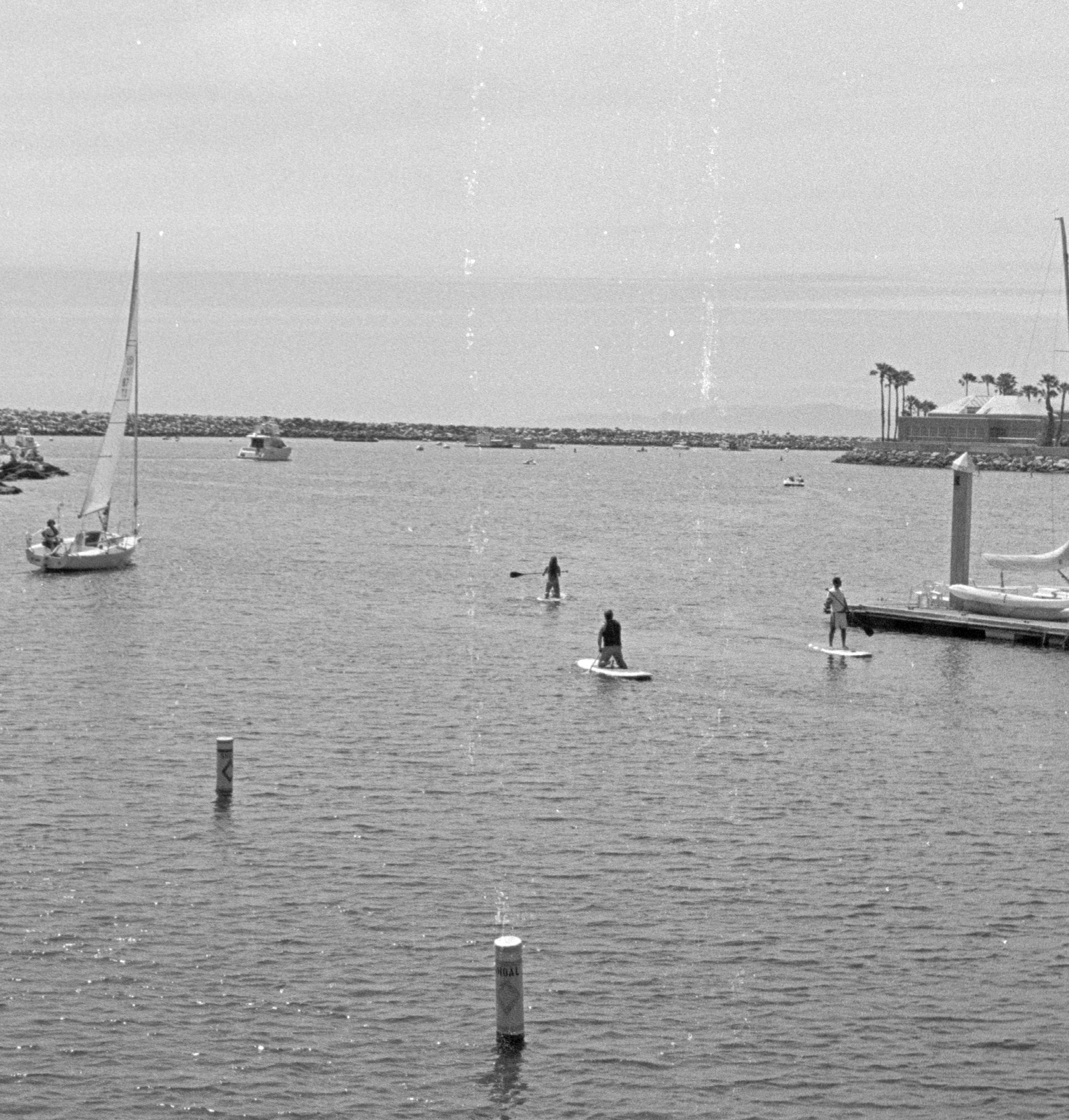

Man, it seems I'm having the worst luck. My kids asked me to teach them about film photography and developing. So I broke out all my old gear got some new chemistry and started teaching. Now both of my kids have successfully developed their own films (and made a few mistakes also). Every roll of my own I've messed up in one way or another. This latest error I am perplexed by is these kind of wavy railroad tracks down the middle of the whole roll.
Now this is my first time developing with the Patterson tank with twirling agitation instead of my 15 year old jobo which I was doing inversions with. But I just don't see how the spinning agitation can account for these marks. The Patterson reels did seem easier to load at first but then became more difficult in the last 8-10 frames of the roll of 36.
I've attached a 100% crop of one of the frames. This was TMax 400 developed in D76 for 10:15, followed by normal stop, fix, hypo, wash, photoflo. I used the spinning agitation according the cues from the Massive Dev Chart app. There are 2 or 3 frames near the end of the roll that also have some liquid marks.

Well it looks like my photo was downsized when I uploaded it. But I think you can still see the marks I'm referring to.
koraks
Nov 29, 2018
22,284
Europe
Drying marks. There's a couple of things you can do:
Wipe them off with a soft cloth or tissue paper; they're on the shiny side of the film, so if you make sure not to scratch it, you'll most likely be able to get rid of them.
Next time you could try distilled water for the final wash.
Or wipe the shiny side of the film immediately after hanging the film up to dry so that there are no droplets on it. Again, a soft, preferably lint-free cloth can work. Don't use a squeegee.

Derek - First thing I'd try is to go back to using inversion agitation with the Paterson tank (if you have the snap lid) and abandon the spindle. I've never done spin agitation, just a couple of gentle full inversions with a half-twist each cycle, every 30 or 60 secs whichever is appropriate.
I think creating a random flow of developer across the film is essential, and this is tough to do if you're just spinning the reel.
It also helps to ensure the reels are clean and dry before loading. If they have been in storage for awhile, I'd take a toothbrush and hot water and give them a good scrub. If they're damp or dirty, 35mm film will tend to drag as you get towards the end of spooling the roll.

I don't wipe or squeegee the film after hanging to dry and have never had any problems.
Lucky you. I do. At least with 35mm. When using distilled water for the last 1 or 2 washes, they're minimal, but still there, albeit very faint. With tap water, they're generally quite pronounced. Wiping the excess water off the shiny side of the film fixes it. No problems with 120 or sheet film.

That looks more like muck and debris on the negative rather than a problem with development or poor agitation, which usually manifests itself as bromide drag -- which is dark lines leading from the sprocket holes -- and sharp edges or patches of less-developed or undeveloped areas where the dev didn't go. In your image, the sky and water look evenly developed so I think your agitation technique is fine. Undeveloped areas show up on prints as black patches and on negatives as clear patches.
You can easily clean your negatives in a dish or bowl of lukewarm water with a few drops of wetting agent; just enough to make a few surface bubbles with your fingers but not enough to make a foam. Soak the negs for a few minutes then very gently rub the surfaces with a soft, wet and clean thumb and forefinger to remove the muck and debris. You could also use a soft, clean chamois or other non-fibre-shedding cloth.
When you're finished, hang up the negatives to dry in a dust-free space. Don't use squeegee tongs or draw the negs through your fingers unless you want some lovely scratches to print (bt;dt!).
Also, be careful how much wetting agent you use; it's easy to over-estimate the quantity. As I said above, you need just enough to make a few surface bubbles with your fingers but not enough to make a foam. Excess wetting agent tends to leave greasy marks and smears on your negatives.

With respect to the spin agitation, the Paterson instructions say to use it only for the first 30 seconds of development, and to use inversion agitation thereafter.

The photo Flo solution I used was 5ml to make a 1 lite bottle. I probably used filtered water when I made it not distilled, will try that the next time around. I've always been pretty hesitant to touch my negs after hanging them. And this time I didn't, but had never seen these kinds of marks before. Now that you mention it, the previous roll my son and I developed we did try using a squeegee because I saw some bubbles hanging out while drying. And come to think of it those were the cleanest BW negs I've scanned since we started up again.
Also now that I think about it, this was the last of the photo Flo in the 1 liter bottle, maybe something settled and contributed to the mess on my negs. Is it a bad idea to mix up a batch ahead of time like I was doing? It looks several months to get through that one liter bottle.
It only took several months to go through a one litre bottle of Photoflo?
How much film are you processing!?
My last 8 ounce bottle lasted for years!
My current 16 ounce bottle should do the same.
I've never seen or used a 1 litre bottle.
You can mix up very small batches at a time, but if you store them, mould will grow in them unless you take steps to prevent it. That may be where your problem comes from.
Here is what I do to permit making up a stock solution ahead of time: https://www.photrio.com/forum/resources/making-and-using-a-kodak-photo-flo-stock-solution.396/

I don't see a good reason to keep working stock photoflo around. Just mix in the required amount of concentrate in the amount of final wash water you're going to use immediately.

I rarely will keep a bottle of working solution Photoflo for more than a few weeks, even if it hasn't been used. Scum and other nasties seem to form after awhile, and it's so cheap that there's no reason to take the risk.
