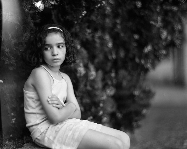

I own a Pacemaker Speed Graphic with Graflok back. I mainly intended using the camera with an Aero Ektar 178/2.5.
I focus with the ground glass. By the way, thickness measures:
- Ground glass: 1'54mm
- Fresnel: 1,78mm -> Between the gg and the lens

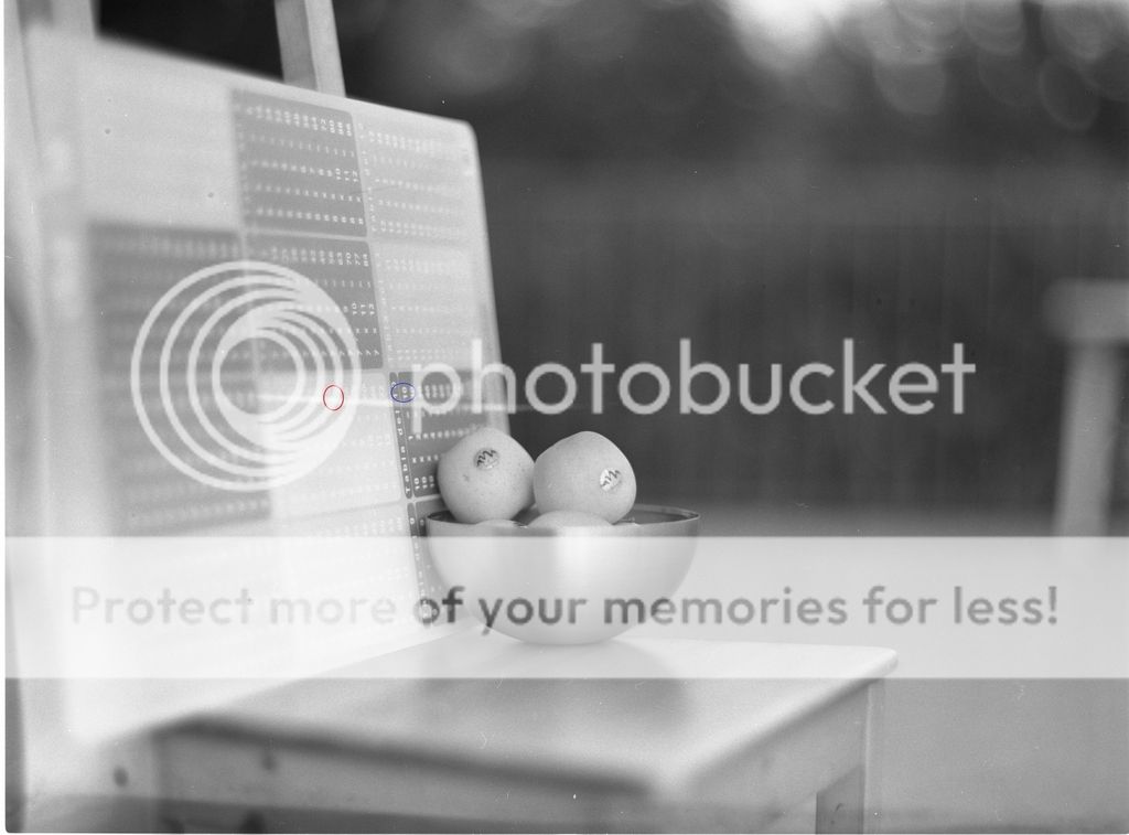

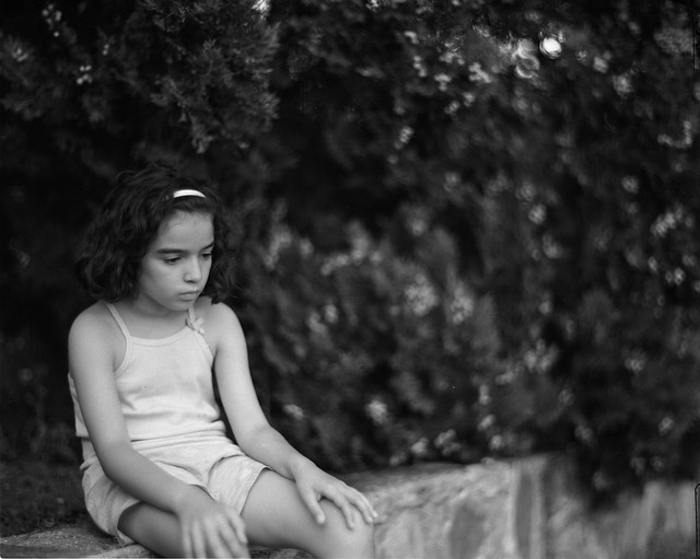

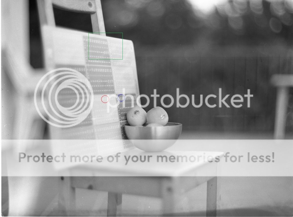

I've spent a lot of film just to achive four or five focused pictures (two of them in the gallery). So, I think I've a problem.
This two photographs should have the focus on the red circle ... but, as you can see the focus is on the blue one.
1.
2.
What do you think?
Thank you !!

If the actual point of focus is further away than the point on the ground glass, the ground glass is too far from the lens (or, more precisely, further from the lens than the film). If the geometry of that camera assumes the ground glass is on the lens side but is installed the opposite way, that would create this effect.

Couldabin, Pacemaker Graphics delivered with fresnel lenses were designed to have the fresnel between the lens and the GG. The likely but not absolutely certain problem is that the GG is in backwards, with the ground (matte) side facing the photographer, not facing the lens as it should be. This is easy to check for.
Film holders are pretty well standardized and were/are industrial products made fairly well. Every time a question like this one comes up people suggest that the film holder is not to specification. I don't recall an instance that didn't involve an early MPP camera -- these beasties required non-standard film holders -- where a film holder that didn't match the specifications was the problem.

If the film focuses behind your GG image (as in your example) the film is too close to the lens. The film either is buckling in the film holder or the ground glass needs to be moved closer to the lens.
You can use the thin lens equation to see how far off you are. Without doing the math it looks like about 0.3mm to just less than 1 mm (assuming 150mm lens).

Reversing the orientation of the GG will move the apparent focus distance by the thickness of the GG -- closer or further, depending on its initial orientation.
