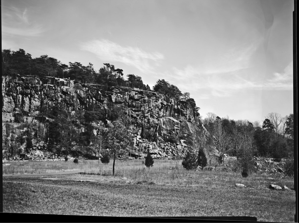

This is a quick and dirty scan on an Epson V700 I borrowed of the Anitec N2C / News 2000 film speed attempt at ASA3--seems MUCH better than my other guess of ASA 50. I'm guessing 6 is about right.
I developed in old Dektol 1:9 (mixed nearly 6 years ago!!!!!), so my test is very unscientific. I developed by inspection under a red safelight, but pulled it out after 1 minute 10 seconds. It was my first time ever developing any film by inspection.
I didn't bother to scan the ASA50 sheet. Even after 4:30 in the Dektol, there was barely any image.
EDIT: the photo was taken at Rocky Face Mountain Recreational Area, Alexander County, North Carolina, USA. Pre-Anniversary Graflex Speed Graphic, Ektar 127mm.

Nope, no filter used. There is enough of a pictorial contrast that I would take a chance using some more of this film.
Also, there is some mottling in the upper right corner, which I attribute to my poor handling.
