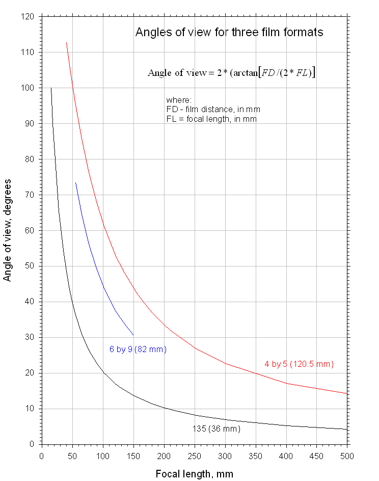

For a dimension d (whether short side, long side, or diagonal), angle of view = 2 * arctangent (d/2 / focal length).
Equivalently, d/2 / focal length = tangent(angle of view /2).
This iswhere the non-linearity comes from. It's close to linear for small angles (long lenses).
The diagonal of "6x9" (really 2.25 x 3.25") is about 100mm, this explains some of the discrepancy in the first post.

Here is a graph showing the relationship between film distance (by film format, along the long dimension) and angle of view.
Your measurements make sense, if 4 degrees difference is noticeable. In any event, the 101 mm should give a narrower angle of view than the 40 mm on their respective cameras The angle of view for a 101 mm lens on a 6 by 9 (82 mm on the long side), is 44.2 degrees. The angle of view for a 40 mm lens across 36 mm is 48.5 degrees.
