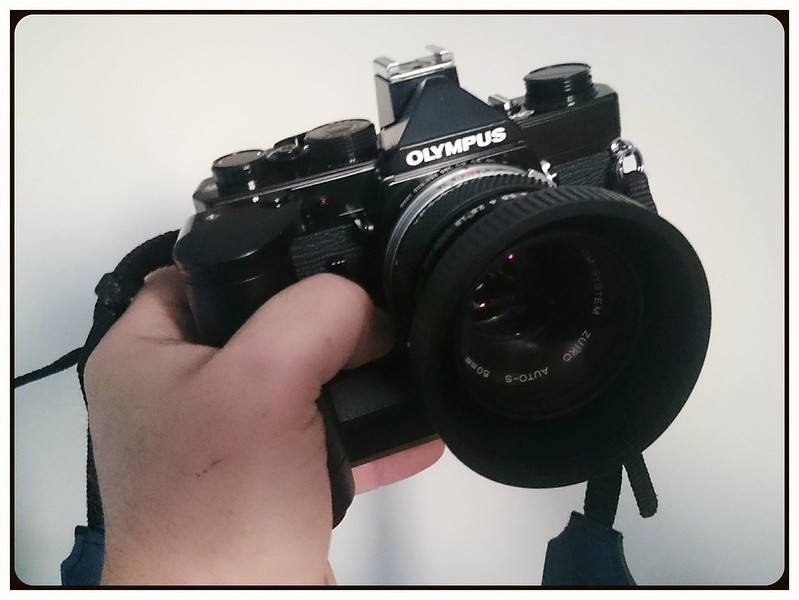

I had a shock this week when I took my Olympus OM 1n cameras (one black and one chrome) out to check them over. I realised that I have owned the black one from new for 30 years this year ! The chrome one was bought second hand shortly after I acquired it's Black sibling. Time has flown by, but these cameras are in pristine condition and have never let me down. I will be shooting them very soon when work and life in general permit me some ME time. I had forgotten just how nicely tactile they feel with a certain solidity combined with rangefinder like size. This may be the time to rest my other cameras (Nikon,s) and give the OM,s some outings.

OM-1n: 97% coverage with 0.92 magnification and bright screen. There are brighter screens than stock who are identified as 2-x and expensive.

Have you had the foam in the pentaprism housing replaced yet? If not, you should seriously consider doing so before it turns into a mess of sticky goo and ruins the viewfinder (this is exactly what happened on my otherwise very nice OM-2n black). It is a time bomb ticking and it would be a shame if it would ruin an otherwise very nice camera.

Yes, the viewfinder is huge.
The series 2-x screens aren't for the -1 or the -2 and -2N. They are for the -2SP and all -3 and -4 to compensate for the semi-transparent mirror. They gave about the same brightness as the series 1-x in the later OMs.
If the Series 2-x are used on the OM-1 and -2, you'll need to compensate exposures in manual mode. Auto works correctly on the -2 and -2N as these have the auto cells in the bottom chamber.
Once the foam deteriorates and causes a mess, it will no longer do any more harm.
Once removed, you only have to clean the pentaprism and it will be like new. :smile:
Yes I have.

The foam turning to goo and eating through the paint and aluminizing on the prism is not as dire as many make out. My oldest OM-1 has a damaged prism and after cleaning and feathering the edge of the damaged area I can hardly see the effect of the area with lost aluminizing looking through the viewfinder.
You can pull the prism out of a junker OM-10 and put it in an OM-1. The OM-10 prisms are always good because there was no foam above them.
Mark Overton
Unless that OM10 is a complete junk, I wouldn't sacrifice one.
I see many kids these days using OM10 as a learning tool.
As said above, you only need is to clean one.

Having done both the replacement and the repair on the prism, I strongly recommend the repair. Just feather the edge of the silvering with a polishing compound like Simichrome or toothpaste.
