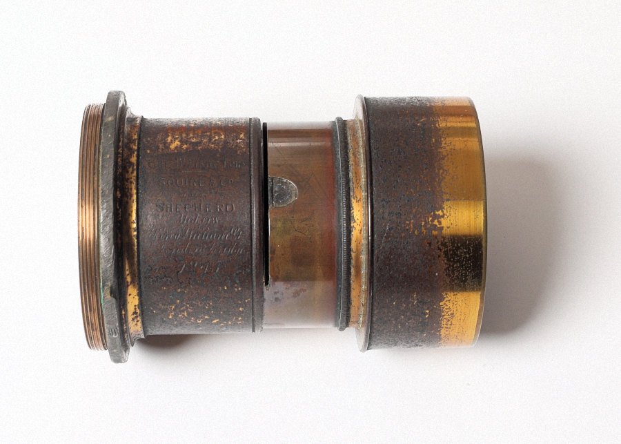

I've been given a 1920s Lantern slide projector, it's pre-1926 as the main lens is a 12" Aldis-Butcher Projector lens. Butcher finally fully merged with Houghton in 1926, also I have the original owner's Lantern slides and title slides indicate lectures in 1926. This is not a home projector it's designed for large halls, and the photographer was a member of a large photographic society in Birmingham (UK) and lecturing at others. It's a 1920s projector.

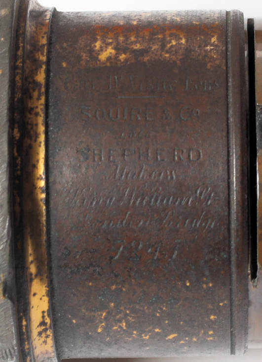

Now to the enigma, the second lens is very much older (50-60 years) and a 6" Petzval. It's missing the focus pinion and has a slot for Waterhouse stops and the internals for the stops in the barrel, but the focus sleeve doesn't have the cut-out to allow focus with a stop in place. There are some clues.
It's in need of a clean, but clearly says Carte De Visite, Squire & Co, Sheffield, so it was not a Projection lens.
When J.H. Dallmeyer introduced the Rapid Rectilinear lens in 1866 many companies were left with large unsold stocks of Petzval taking lens. I have a few Petzval lenses, this isn't particularly swirly compared to others.

Wasn't early Petzval lenses often refittet with a slot for stops? If so, this might explain the missing cut-out. Charming little fellow, by the way.

It says Shepherd.
It might be quite early petzval.
There are some references to Squire (retailer) and Shepherd (lens maker) on the web.

You are right I misread it as Sheffield, it is Sheperd which could date it to the 1850s, Waterhouse stops were introduced in 1858. So @lobitar is probably right that the slot for the stops was added later.

Now I've been able to decipher the address which is 53 King William Street, London, this dates the lens to 1856-67, by that point Squire were the manufacturers of Shepherd lenses.
It has none of the usual Petzval swirl which is unusual.
