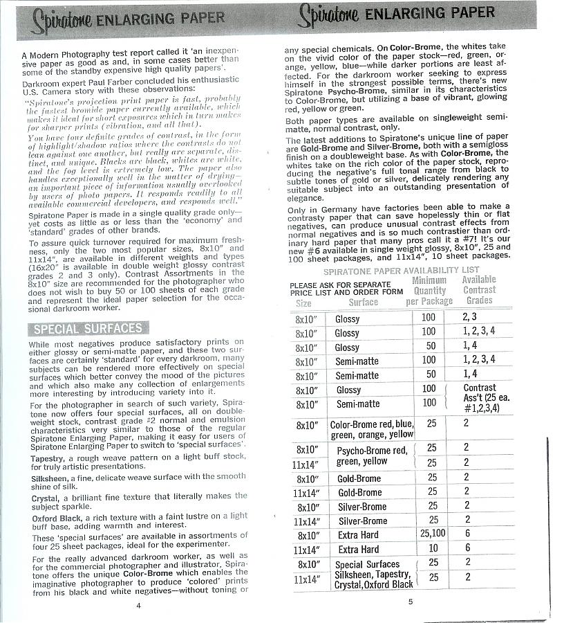

Stephen,
Don't recall an Ilford paper, but sure do remember a "Spiratone" paper, similar to what you describe.
Spiratone, (a loooong gone store/mail order shop) had two items, one was called Color-Brome, the other called Psycho-Brome, (hey it was the 60's-70's).
See the attached jpg file from a catalog of the time period (read towards the bottom of the page).
Back in the 60's-70's I had tried it, and back then I probably thought it was great. Ironically, a few months ago I found a print I had made on the red paper, and lets just say "my taste as changed" and threw it away because it really looked like garbage!
Towards the bottom of page 5 on the jpg scan, they mention Special Surfaces, "Silksheen, Tapestry, Crystal, and Oxford Black". Now those were papers!, they were great.
Anyway, like I said don't recall Ilford, but this I do.
Ira

I have come across a package of the blue paper - Spiratone Color-Brome Enlarging Paper. I tried using regular B&W enlarger and chemicals and it came out black. I was using a safelight, so I was wondering if this is ok. Any suggestions would be great.

I never heard of an Ilford paper like that, I used quite a lot of Kentmere paper on various metallic & coloured bases, and still have some left in the UK, along with some prints.
There was another brand available which I never tried but I think was made for Pal in Germany, coated by by EFKE, this is probably the Spiratone product.
Unicorn57, welcome to APUG. It sounds like your paper is fogged. Try processing an unexposed strip in total darkness, don't expose it to the safe-light either. That will tell you if the paper is still useable.
Unicorn57
It's possibly the material manufactured by Argenta, and I believe these may have been orthochromatic. Try using a dark red safelight and it will probably be ok.
Unicorn57
Hello,
As you may have read from all the previous posts, this paper has got to be at least 30 or perhaps even close to 40 years old. Any paper that old will have fogged to some degree depending upon storage. A white based emulsion paper would show up as grey, the Color Brome blue paper, along with the fog might come up more black than grey.
Using regular chemicals is fine, but I really suspect that the issue is really more the safelight issue.
What color or safelight type did you use?
The paper made for Spiratone as well as much of the paper at that time was a bromide paper. Recommended safelights at that time were greenish-yellow Kodak OA. Agfa paper long gone, as well as other long gone brands, always stated OA filters. If you were using a safelight such a OC, amber color which is used for MC type papers it should have worked, but it could be that the Spiratone ColorBrome did require that yellow green OA filter.
