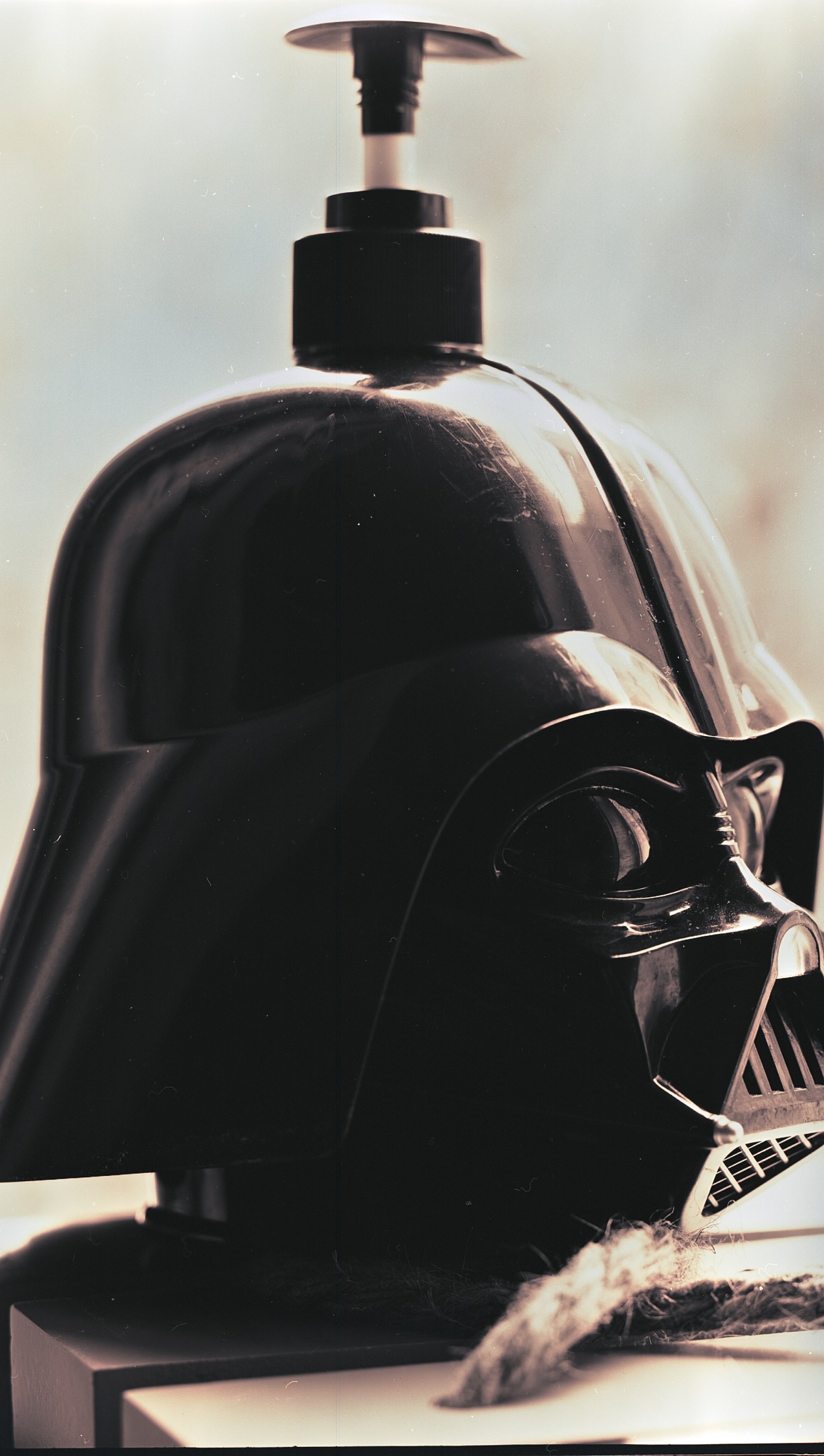

I'm using the Universal Amidol Developer recipe I found in the recipe section.
It's a very interesting article, and you have also some development times you could use as a starting point.
At the moment, I am using it with Wephota FO5, but later I'll try it with Wephota Ortho 25 and Foma200 and I'll post some results.

As promised, this is a result with UAD (negative scan).
Film is Wephota FO5
I like it very much.
