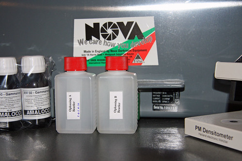

Unfortunately by the disappearance of the Amaloco plant in Ommen, Holland a lot of products are gone.
Also the High Definition (non-staining) AM50 (60ml) developer from Amaloco. The content of this developer: Pyrocatechine, Sodiumsulfite and Sodiumhydroxide.
It's a High Definition surface developer 1+29 in dilution.
I would like to have a replacement for this developer.

Beutler recepture:
A:
1g Metol
5g Sodiumsulfite
B:
5g Soda
both filling up to 100ml water.
For 4 films (1+1+10). Costs Eur. 0,30.
For such a big difference what is in fact the same I will soup my films in my own brewery :smile:
Thanks to Tom A. (from the R.F.Forum) who could provide me more different data for the Beutler High Definition developer, I could extrapolate some suitable developing time for the (new) Rollei Super Pan 200 film:
Super Pan 200 E.I. 160 in Beutler for 9:30 Min. at 20 degrees C. Slow agitation.
