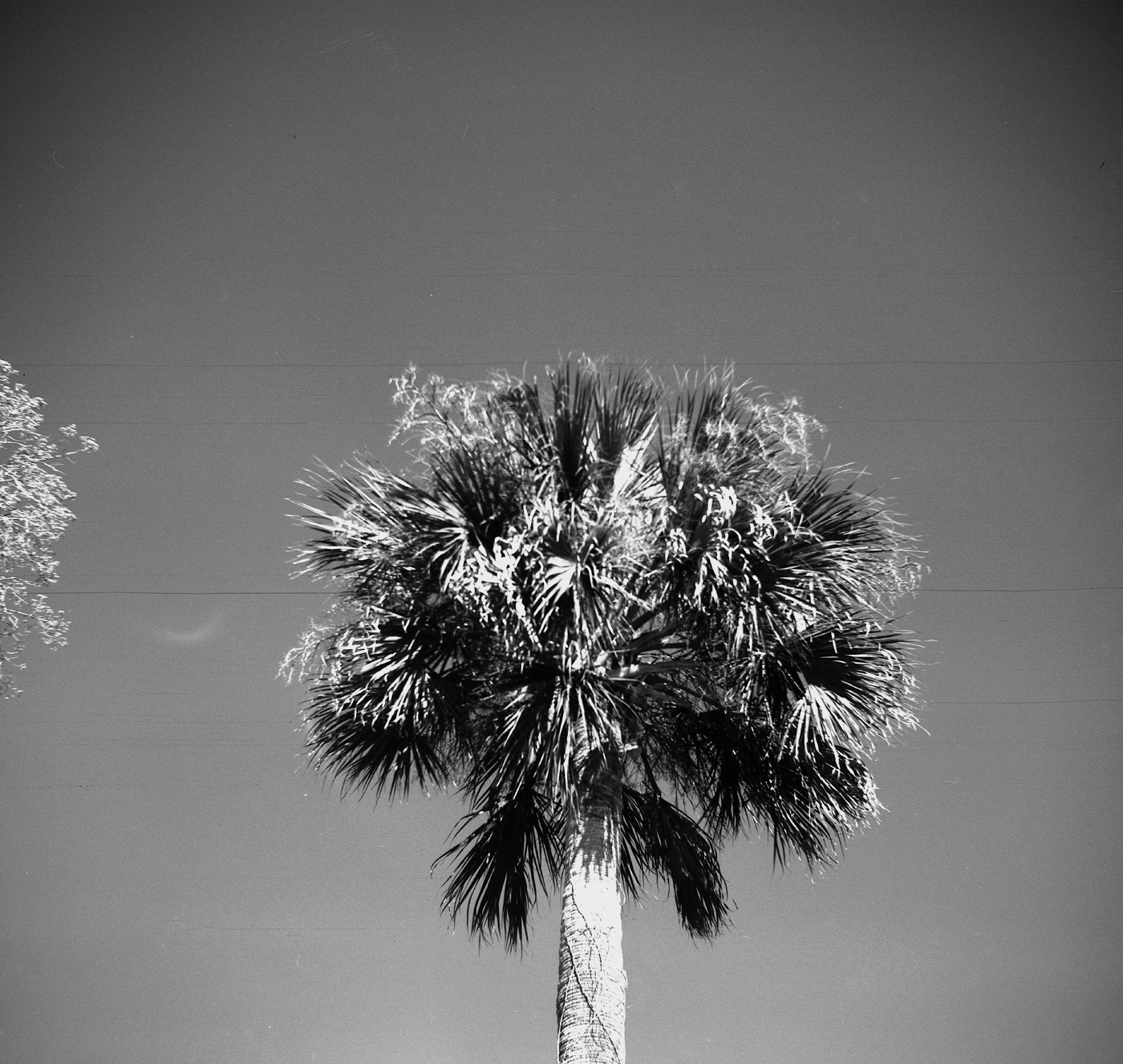

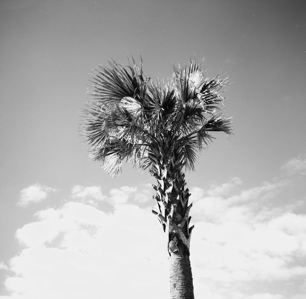

I haven't developed much film lately, and there's a problem now. The top corners of outside shots of skies are darkened. At first I thought it was my hood vignetting, but it has happened on two different cameras. If it were the hood, wouldn't the bottom be darkened in the corners too? The two photos below are from two different cameras, and both were developed in different developers. I'm wondering if I'm being too vigorous when I do my inversions. Or something. The strange thing is that it's not happening on every frame w/ skies, just on some.

I am not sure how you over agitate to get vignetting? And I do see darkening in all 4 corners of your 1st photo so that could still be the hood.
I use continuous agitation quite a bit and don't see that result. I have also used vigorous and gentle intermittent agitation with nothing of that sort.
I think a more complete definition of your process may be needed before a cause can be identified.

I see vignetting in all four corners of your images. Over-agitation does not result in corner vignetting - oversized/inappropriate lens hoods do. You may want to check your lens shade sizes. Its nothing to do with your film processing.
When I agitate, I turn the tank completely upside down and then back up again, while giving it a slight rotation. That's one cycle per second and I do five cycles per minute. That and the empty space in the SS tank give the film a big old healthy agitation, and I've never seen anything like that. Also done continuos agitation with a motor base and plastic tanks with no problem.

Take two identical shots; one with the hood and one without then examine the two negs. That seem a sure test for the hood.
As the others have said I have never seen vignetting caused by over agitation - why would the developer be able to confine itself to the corners rather than simply increasing contrast all over the neg?

It could be the 1/cos4(angle off center axis) loss in the corner of the lens. Is is a wide angle lens?

The bottom photo only has dark corners in the top, and the top photo has much more vignette at the top compared to the bottom. Seems to me that if it was the hood, wouldn't it be equally dark in the bottom corners too? I'm just guessing on the agitation thing, as I can't figure out how else the hood would only do the top corners. I use a swirley motion on agitation. It could be uneven development? I'd better run a roll in a camera that I know never vignettes and see what happens. Weird.

Over agitation does not cause the appearance of vignetting. Since it is an abundance of developer it causes overall density and contrast increases depending on developer and film. Your problem is not over agitation.

Its your lens, camera or enalrger I don't know which.
A very simple thing for you to do is take your image in photoshop or similar and increase the contrast greatly. You will see the vignetting in the corners, both bottom and top very easily and also see the curved inner shape leaving a circular central area which would never be caused by agitation in all four corners like that.

It is very useful to do two things.
Look at the negatives - like on a light box.
If the negatives show the effect. Remove back of camera and look through the camera. Otherwise you have an enlarger or scanner problem.
Filter too deep, hood too deep, five will get your four horses...

May I ask what camera you used to shoot these with?
Judging by the scratches, square format, and vignetting the first image looks like it may be from a holga or toy camera. If thats the case, vignetting is fine.
Also what is your agitation scheme? What developers did you use? What films did you use?
I don't think that you are agitating too vigorously as I don't see any surge marks but the frequency may be too much.
