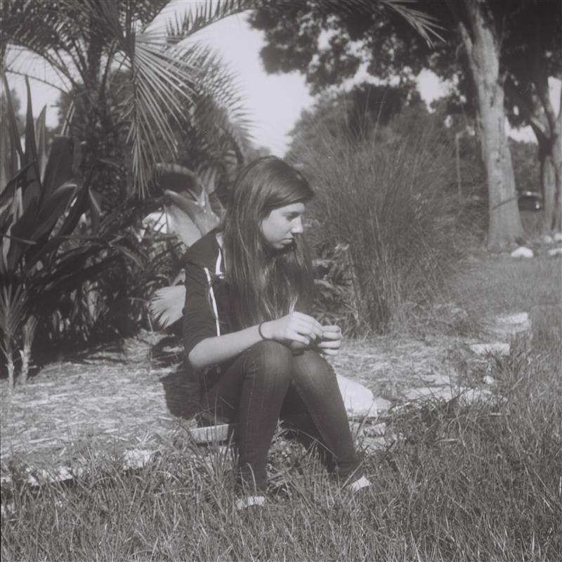

I recently got a cool old Ikoflex 'coffee can', and I'm trying to figure out if it's me or the camera/lens. I can't seem to get a sharp image, so I'm hoping you guys can help me figure out where the problem is. Lens is the Zeiss Novar 8cm.

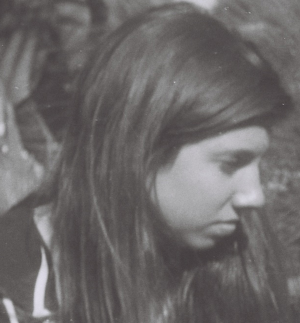

I had my reading glasses on for this shot, and I focused on her face as best I could. Full image and a 100% crop from a 10"x10" scan:
Thanks for the help!

The grass in front of her feet looks sharper and more contrasty than the grass right near her feet, with the sharpest part being nearest the edge of the frame.
Was this wide open? Does the camera show any signs of ever being opened up? Little marks on edges of retaining rings or anything of that sort?

I agree with post #2, the grass just in front of the subject is the sharpest point of focus.
Test the focusing system by making a temporary ground glass to fit the film plane as the film will be when correctly loaded. The gg can be glass or plastic with transparent tape on one side, strips adjacent but not overlapping, tape goes toward the lens. With the camera on a tripod loupe focus either the view screen or the temporary gg on a fine detail subject such as news print or a map pinned flat to a wall 6 to 10 feet away. Check the focus of the other with the loupe, it should match the initial focused screen. A mismatch is corrected by changing the position of the view hood screen. Taking lens has to be focused forward of the focus point of the view lens- raise the focus screen by putting shims between it and its mount; taking lens focuses reward of the view lens- lower the focus screen bu removing shims from the between the screen and its mount.
Inspect the camera carefully for proper lens mounting of both the view and taking lens. A shim may have been left out of the view lens to body mount during cleaning.

As Fixinator pointed out, the shot you have posted here is front focused. Easy to ck to see if it's your technique or the camera by going through the steps above.

As for the above photo, it wasn't wide open, but was either f/8 or f/11. The aperture doesn't have stop clicks, so once I take the reading on my (old Sunset Unittic) meter, I kind of range it based on where I think I need to be.
