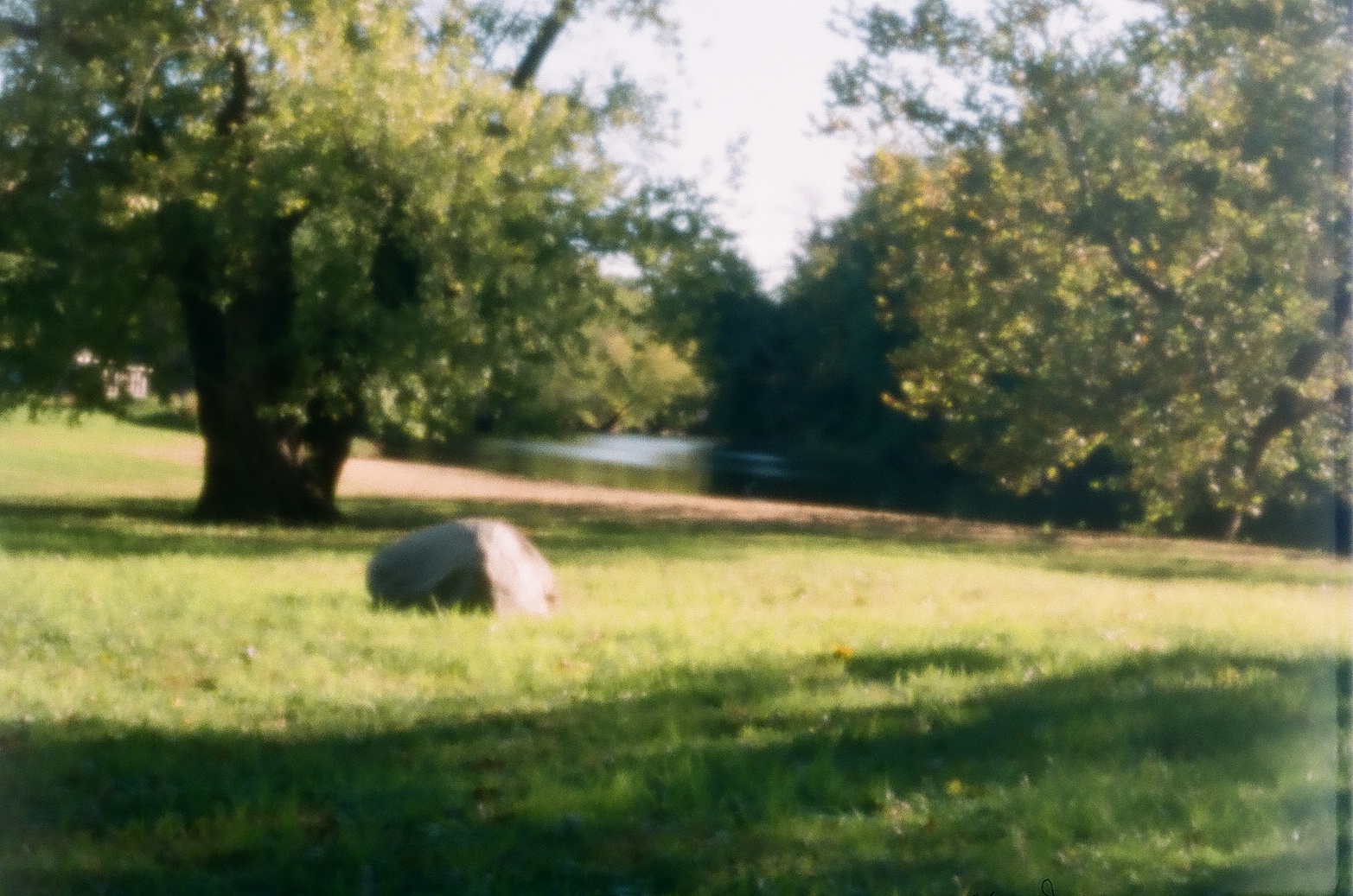

The trouble I had with bracketing the exposure was the latitude of the photo printing shop. The CD they returned showed passable photos while the negatives showed a wide range of exposure. A plus or minus 2 f stops bracket was automatically corrected by the CD making machine. Yes you could tell the difference in exposure and color shifts, but they were all usable digital images. A 2 stop bracket on a 3 sec exposure was 1 sec to 12 secs.
Being new to the idea of Pinhole photos I decided to take the easier albeit more costly route of commercial development. I sent in the film and they returned the negatives and a CD of the prints.
My alternate goal was improving resolution, I am after soft focus, not fuzzy focus. I also prefer make my own pinholes and smallest I could get so far is .356 mm (.013). The end result was the 35 mm format needs too much enlargement, which magnifies the fuzzy focus. So now I am restoring a 4x5 view camera, which opens another can of worms, as I will be processing my own b&w cut film.
The view of the Tippecanoe River is about as good as I could do in 35 mm.
