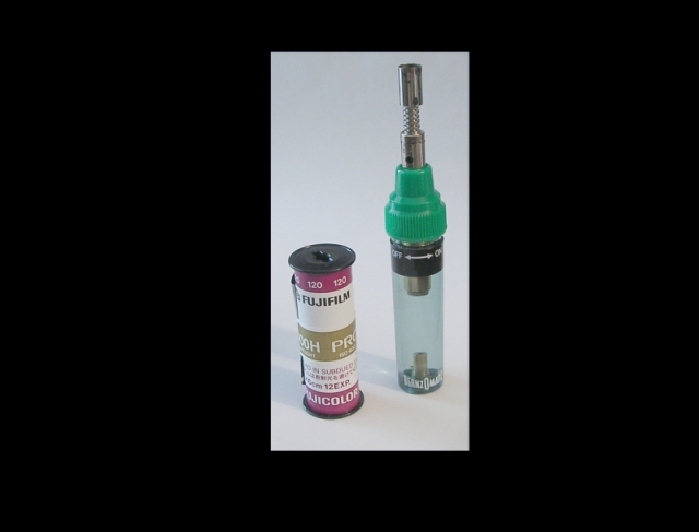

I use Butane in place of Protectan (Butane + Propane) - my disposal system is a BernzoMatic Mini Torch (for soldering), available at Loews, Home depot, etc.
A three - five second burst is adequate. Butane refills (for butane candles, cigarette lighters, mini - torches) are widely available.

I have used Ed's Butane method for several years now, and have not had a problem. I have changed all my chemical bottles to dark glass with "O" rings in the screw on caps. Take care where you store the torch when not in use. My dark room is in my gargage where I keep my other tools, but it is really not a good thing to store in living quarters.

Any inert gas may be used for this purpose, propane, butane, nitrogen or similar. The idea is to provide a barrier on top of the developer to exclude oxygen. I too use Tetenal Protectan. It may seem expensive but the restricted valve supplied with it means that it is extremely economical in use. I find a can lasts me a year or more. The draw back to using gas from a canister designed for a blow-torch is the rate of delivery can be high enough to expel your developer from it's container. This is messy, I write from experience.

Gang ... GANG!!
There seems to be an assumption that I recommended a LARGE "blowtorch" to deliver a burst of Butane. Not so.
Attached is an image of the BernzoMatic **MINI** Torch (No - NOT the item made by FUJI - the OTHER one).
Precise metering - refillable - and Butane cartridges are inexpensive.
