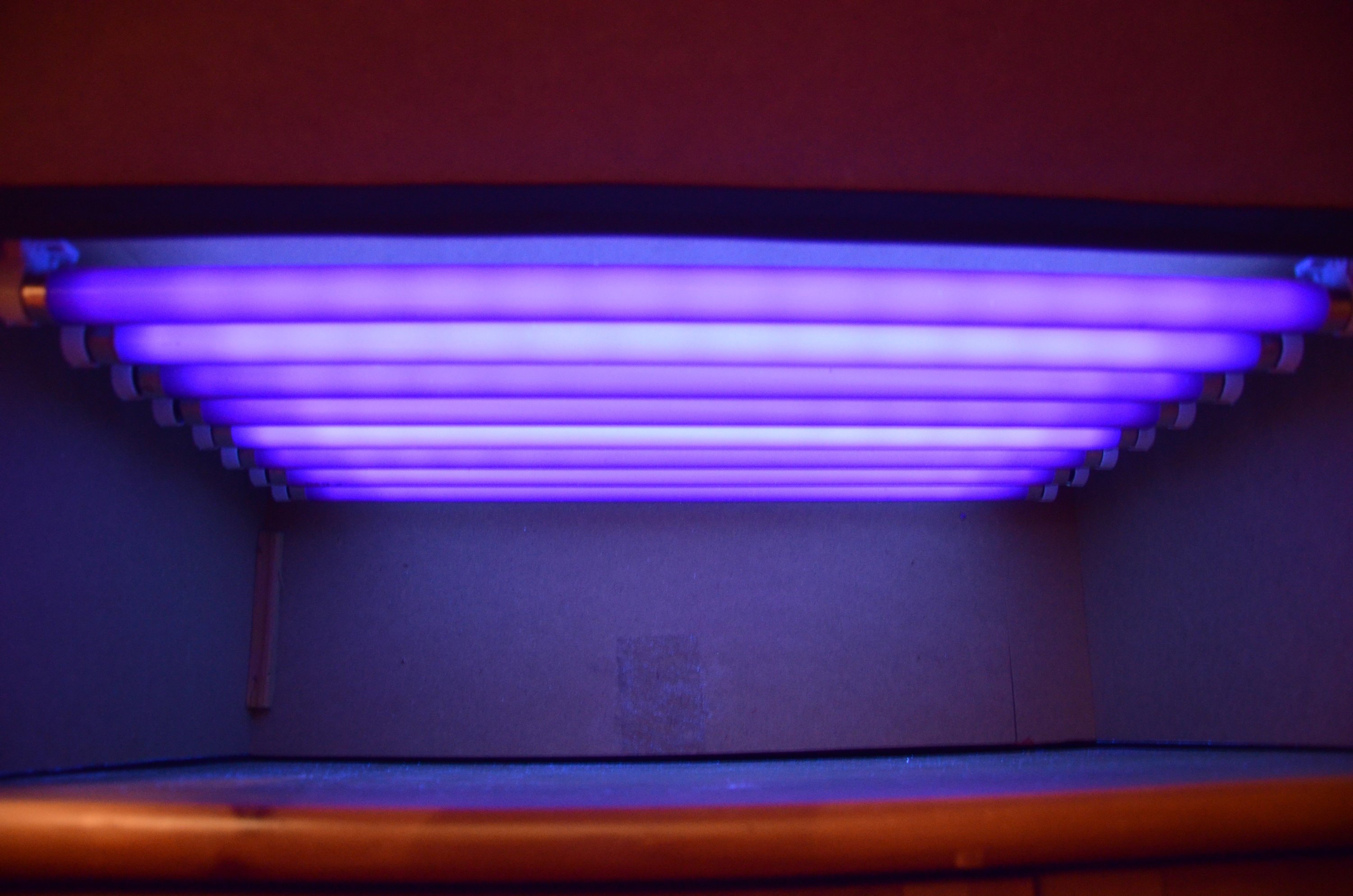

Another thought on the timing - I'd try two things. One: move the lights closer to your printing frame. If you're hitting an hour with the lights at 6", moving them to 1.5" would get you into the under-15 minute range. I get 6-24 minutes times with platinum/palladium prints depending on the exact emulsion mix I'm using and the density of the negative with my lights about 1.5" from the top of the frame. Two: I've experienced that double-coating tends to slow my exposures down- if I single-coat, I'm somewhere in the 6-8 minute range, double-coating is a minimum of 12 minutes. Double-coating with platinum in the mix can run me up to 24 minutes. I don't know how fast argyrotypes are relative to platinum/palladium - they could be a slower, less-sensitive emulsion than Pt/Pd, so an hour could well be in the reasonable exposure range.

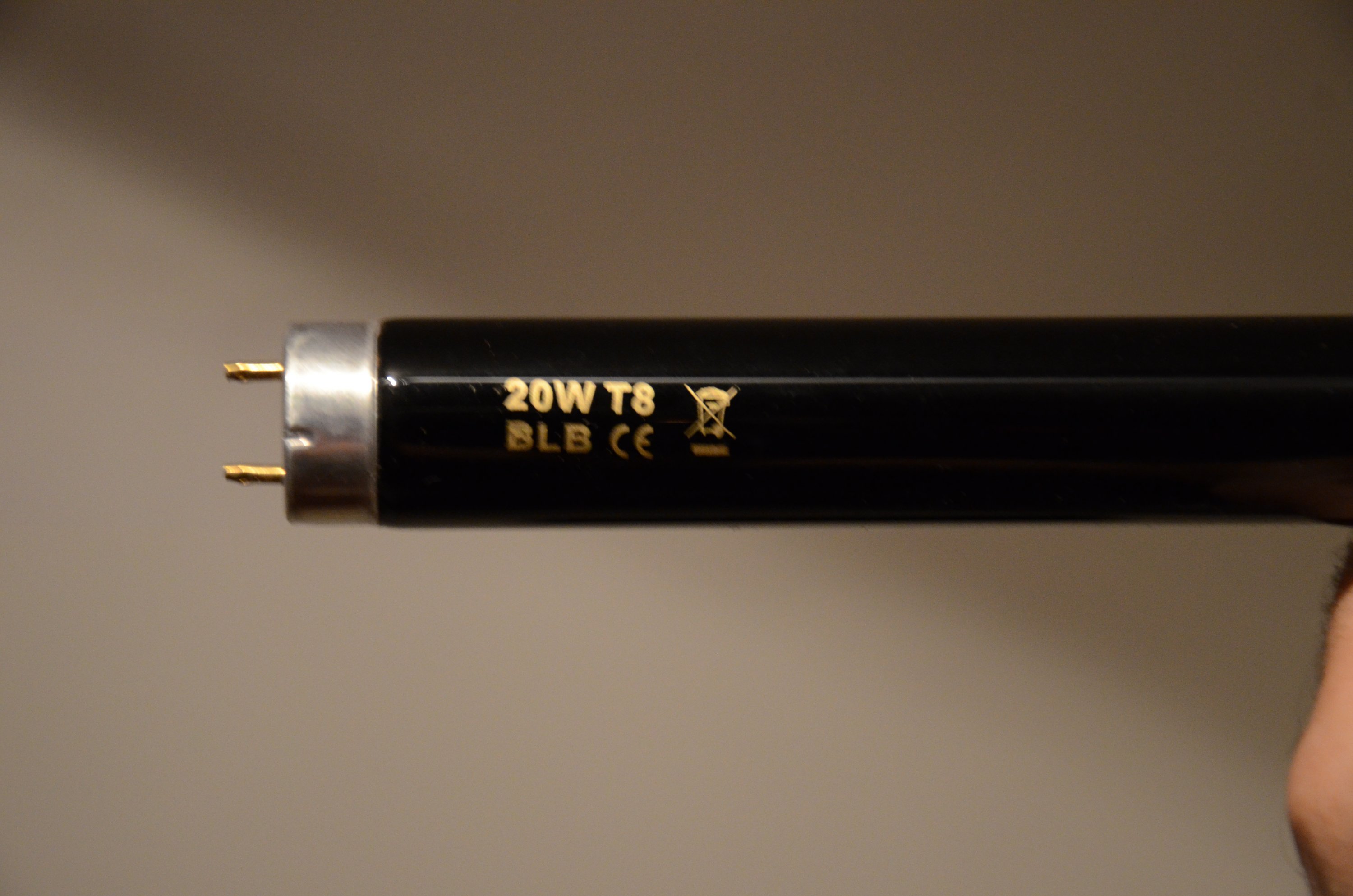

Hi Dibbd and many thanks for coming back to me.
Your experience looks interesting especially as i've had doubts about the tubes i bought too. I got them from eBay and they are unbranded so i am wondering if they're all they're cracked up to be. I've also been through my wiring with a multi-meter but, not being anything like knowledgeable about the workings of fluorescents, i picked up a voltage at the tube fitting that cycled once between three readings - something like 300V, 180V and 0V where it settled. I had read on line that tubes run at about 700V but i never got anywhere near that, nor did it stay at a constant operating voltage. I gave up after that as i had no idea what i was looking at. Anyway, the tubes and my bank in operation are shown below:
You can see some variance in tube luminosity but generally, they're all on!!

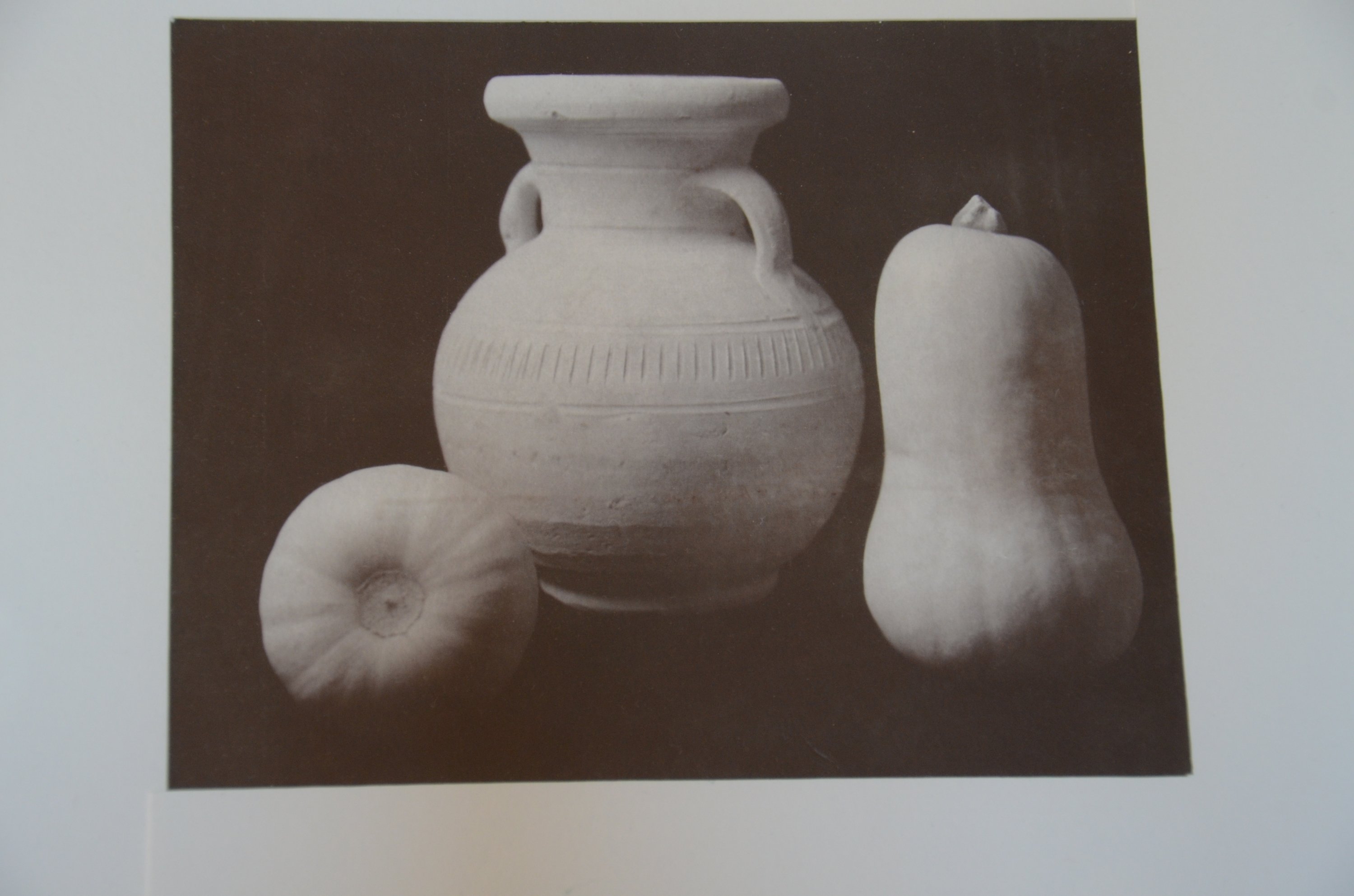

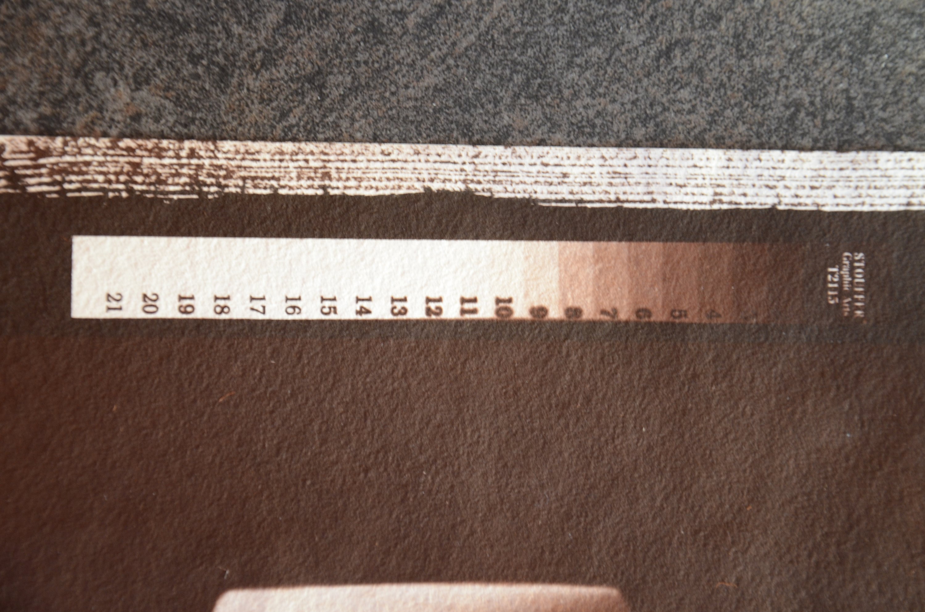

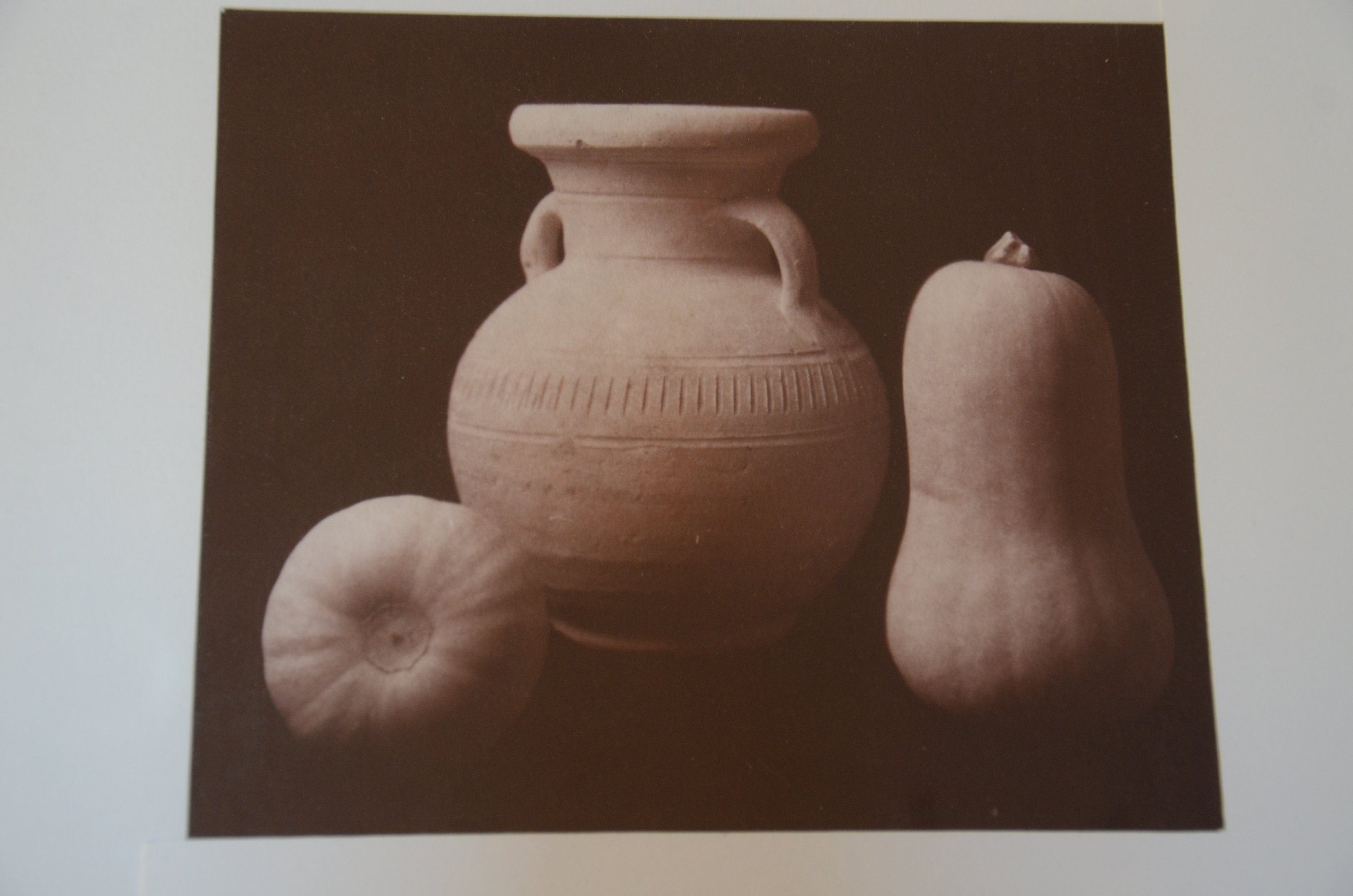

When it comes to exposure, i took your advice TheFlyingCamera and lifted the printing frame nearer the tubes - down from 6" to 3.5" - reducing the exposure time to 30 minutes from 60. I'm not sure i could go closer than 3.5" as my tubes are about 3/4" apart and the gaps may begin to show as uneven light? I also used one single coated sheet and one double coated.
The results were interesting in that:
  • the single coated sheet has much less detail in the shadows than the double-coated but a more or less equivalent Dmax (although i don't have a reflection densitometer so i'm only working by eye). Not what i would have expected
  • the single coated sheet also appeared darker all over with darker highlights, once again not what i would have expected
  • the single coated sheet came out a much warmer brown (burnt umbra from my watercolour days?) whereas the double-coated sheet was close to a conventional chlorobromide paper; no idea why there would be such a colour shift - the double-coated paper also processed quite badly with grey patches where something appears not to have processed properly (see an example above the righthand squash in the second image - squash itself is not blotchy as it appears in the image, that's a factor of a quick digital photo)
I've attached examples to illustrate my results, including the Stouffer wedge from the single coated sheet showing nothing north of step 11. The negative i used had a density range of 1.4, much less than recommended for these processes.
Single-coated paper image:
Double-coated image:
Single coat step wedge:
