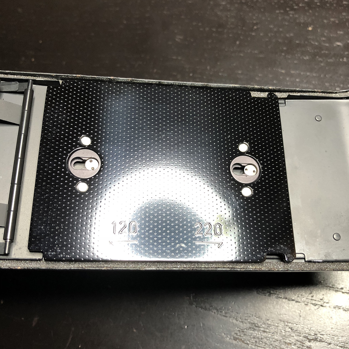

I've loaded film but I have a question about it.
This one, doesn't have the red 120 arrow on it. It has a red dot and it is to the left of all the pics I've seen of the inside of the P67. So does the 120 film arrows line up on the red dot?
I put the arrow where I thought the red arrow would be on new ones, and the counter went past 0 before it stopped cocking.

This one, doesn't have the red 120 arrow on it. It has a red dot and it is to the left of all the pics I've seen of the inside of the P67. So does the 120 film arrows line up on the red dot? ...
IIRC (Pentax 6x7 non MLU) there where two marks/dots - a green one on the left (120) and a red one one the right (220) ... :unsure: Maybe it will be better to pay a visit to Mike Butkus and take a look for the manual.

Well, I made the experience that the exact starting point, speaking in millimeters, is not really important.
The camera, in my case a second generation Pentax 6x7 with mirror lock up, auto senses the starting point of the film, sometimes it is further to the start of the film strip,
sometimes it is slightly further back and I have barely any room left on the film strip.
There has never been the case that the last picture touched the end of the film, I always had some room to fit a film clamp.
I've attached two pictures of the inside of my camera, does yours look different? Which version do you have?
By the by, I bought my smc 4/55 from Japan, it was in perfect condition, looks unused an the seller also threw in express shipping free of charge.
That was my second purchase from Japan without any problems.
