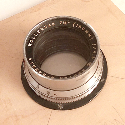

Wollensak lens.jpg Yes I know. I've been cautioned and chastised in other groups but I want to build an instant camera to use my stockpiled Fuji 100 utilizing the body of an old broken Polaroid Big Shot and my (currently barrel mounted) Wollensak 190mm Raptar ƒ4.5 lens. I have mocked it up with blue tape and it works wonderfully and incorporates the focusing two step with the camera's built in viewfinder. I DO NOT want to by a different, or better, or smaller lens. I'd like to use pieces I already have.

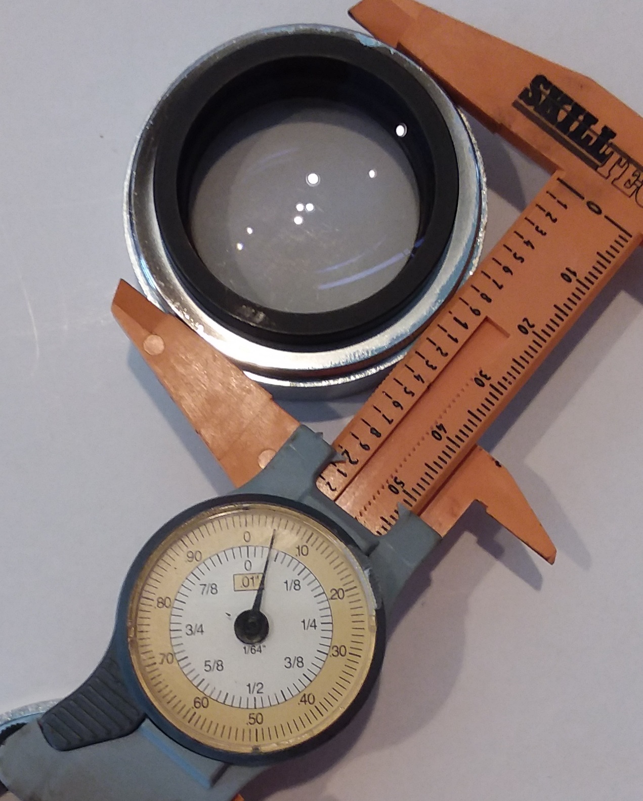

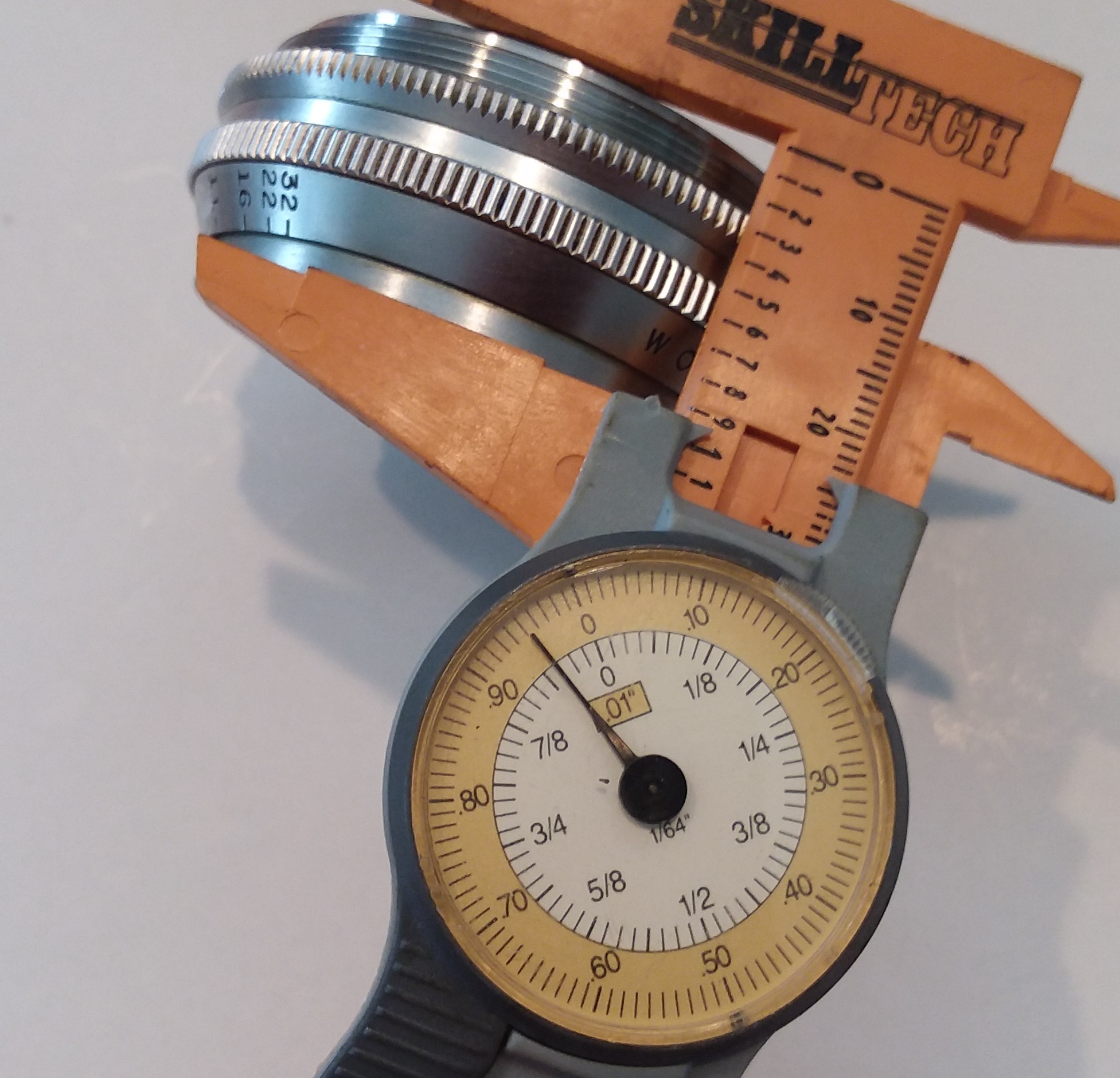

But I do need a shutter. I have been told its a Alphax No. 3, and also a No. 4 but even with the catalog posted by Camera Eccentric and info at lensn2shutter.com I really can't tell. I don't want to drop a bunch of money on something that won't fit. I really don't want to drop a bunch of money at all. The outside of the mounting threads measure 2 3/32 inches with my H. Freight plastic calipers.
