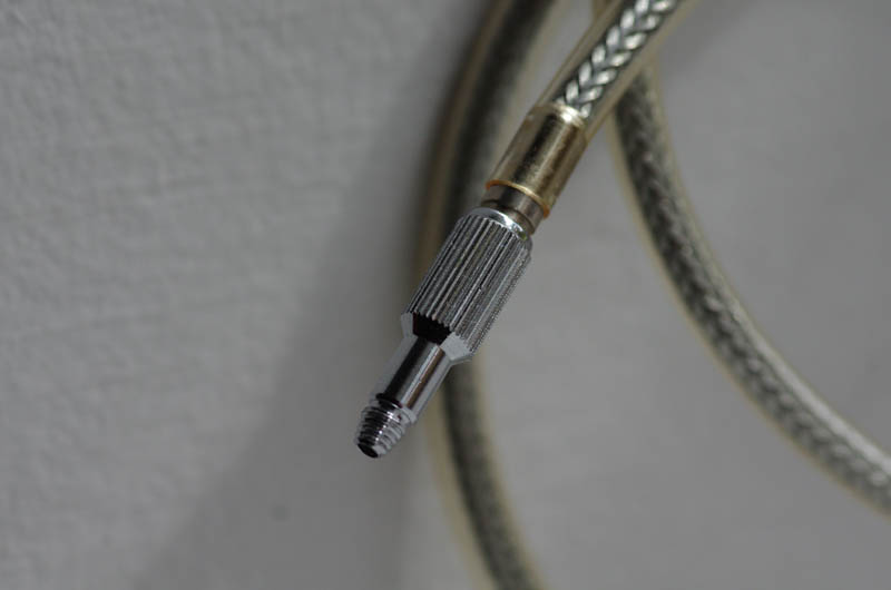

Right then, bit of an odd questions:
I purchased an Alpa style shutter button, like this:
http://www.ebay.com.au/itm/251389779421?ssPageName=STRK:MEWNX:IT&_trksid=p3984.m1439.l2649
To used on my Graflex XL. It does not fit, far too loose, the thread of the shutter button rattles around in the Graflex.
So basically, other than glue, or maybe building up the thread to accept the Alpa shutter release, is there any other type of 'thread expander' I can use?

I believe Alpa cameras have a non-standard version of the thread, I do have a regular tapered thread release, but it's pretty much junk, it fits, but that's about it. I was hoping to use this much more handsome Alpa style one. I had my suspicions that it may not fit, but I took a chance.
So I would like to consider ways of making it fit, after all, it's just a metal pin with a button on top in a little cone. I've seen thread adaptors, but nothing which look like it would fit. I don't mind making something myself (or at least trying), but if someone else has ideas or thoughts, they are most welcome.

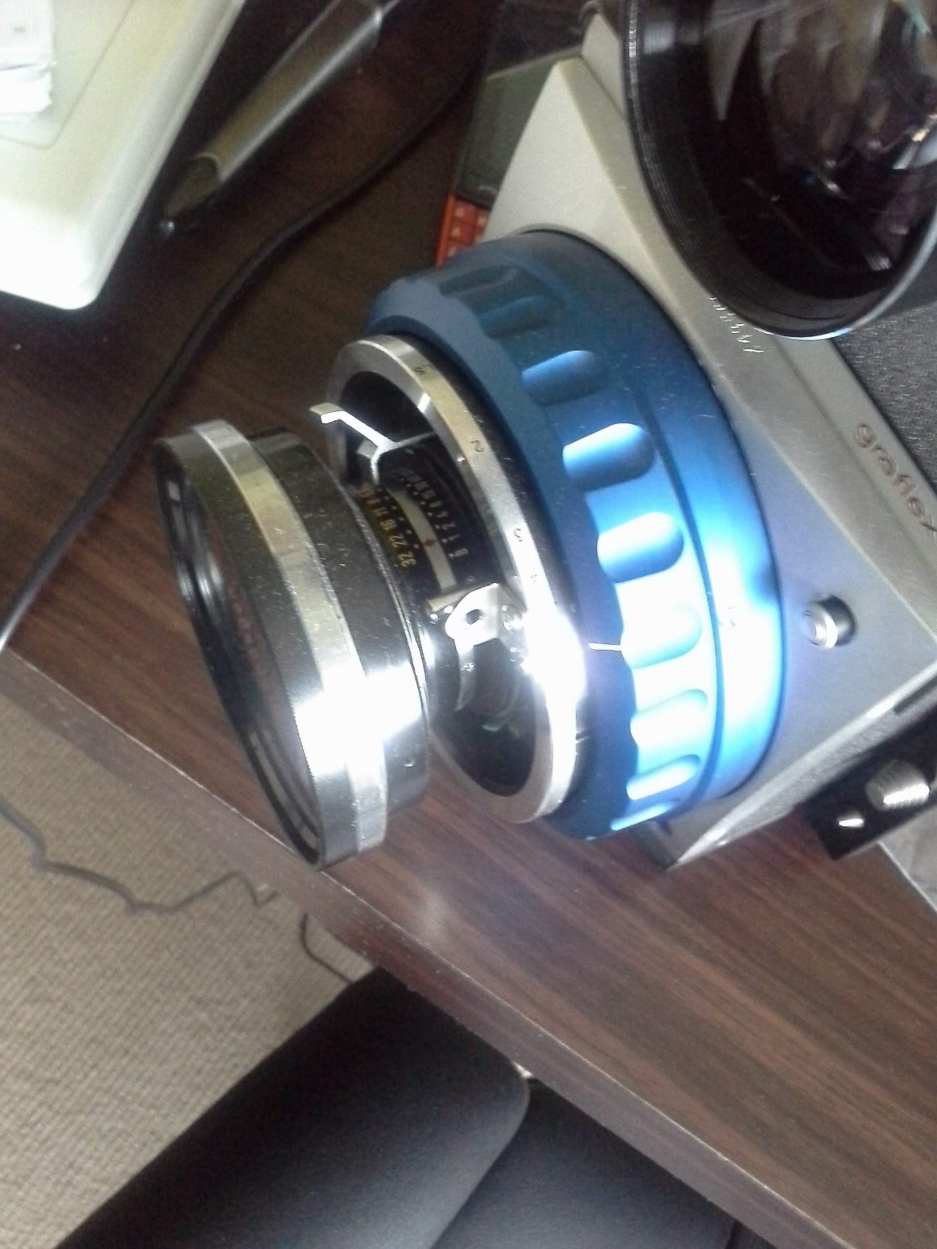

I have attached a picture showing as best I can the location of the shutter release thread mount.

Thanks for the image. As I thought, not part of the camera, part of the lens assembly. The 58/5.6 Technikon for some Linhof Technikas is the same lens with the same infernal #00 shutter and same cable release "socket." You might want to ask Bob Salomon at HP Marketing whether the official Linhof part is still available.
