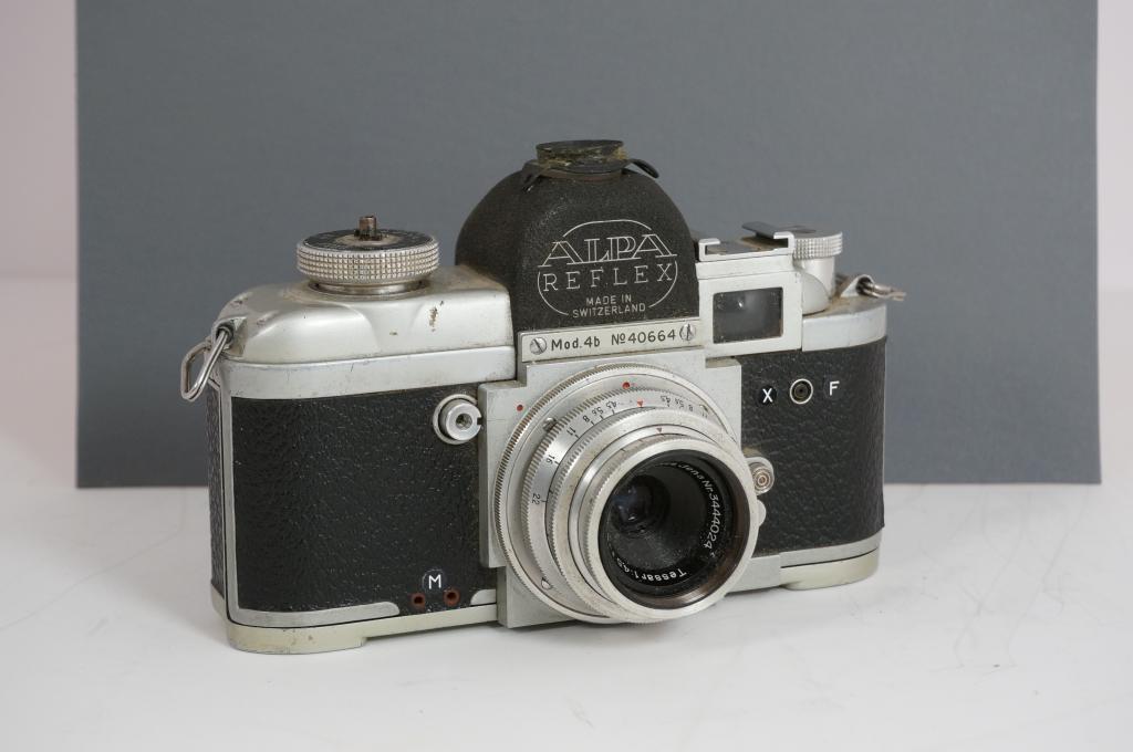

I've recently been given a bunch of old camera gear amongst which was this Alpa Mod. 4b. Its not working, the shutter is stuck half open, and it needs a few parts. Anyone know of a shop that can be recommended to take this on? I'm thinking its probably beyond my current skill level and the camera is I think worth a bit of an investment.
Radu Lesaru at 3R Camera in Flushing, NY is the only Alpa repairman I know of. He's done great work on my Alpa 11si—very conscientious guy, very reasonable prices.
Excellent, thanks sjeffg, that's just the kind of recommendation I was looking for!

Thats alright, I'm certainly not in this for the money! I like weird old cameras and I like to use them. Profit really has nothing to do with it and fixed up or not I'm not planning to sell the Alpa. I've already received a reply from Radu at 3R and his CLA price is acceptable. Once he has the body he can tell me what is wrong with it and I'll decide on whether I'll have it fixed or not. If not then it will become the only non working camera in my collection, just cause its so cool looking. :D

Yeah the prism is odd, and very small. I cant say what its like to view through however as the shutter is stuck open and the mirror doesn't come down. The camera also has a standard optical viewfinder. The winder should have a lever but its missing from mine. Its a weird duck too as it operates from front to rear. When at rest the tip of the lever is forward on the camera and pointing near the prism. It winds across the front and I guess around the back but I don't know how long the stroke is. Fortunately, Radu at 3R Camera has the required parts. Once this thing is back in my hands I'll shoot a few pictures and post them up, probably in the 35mm forum.

The wind lever did not exist on type 4a, but was added to the 1959 type 4b. Since yours is one of the first 10 or so made it would have the clear perspex type lever and not the later angled metal lever.
The hood at the top is not a prism. Th 4 was the only Alnea with a direct view ocular and no prism.
Your Tessar is not listed among available optics at the time, so if it has a fixed or a factory mounted adapter-Alpa mount, it must be a prototype like the much later Distagons and Tele Tessars.

Well the Alpa has returned from its trip to New York and it looks wonderful! It wasn't at all cheap to get fixed, but there was a ton of stuff wrong with it including stripped screw holes, shutter curtains, and numerous internal parts. I had a chance today to shoot a couple shots and hopefully will have time for more this week, I'll post some later.
The camera went to 3R Camera in Flushing NY. Radu did a fantastic job on this, it was a lot of work, and I wouldn't hesitate to send him another camera in the future.
