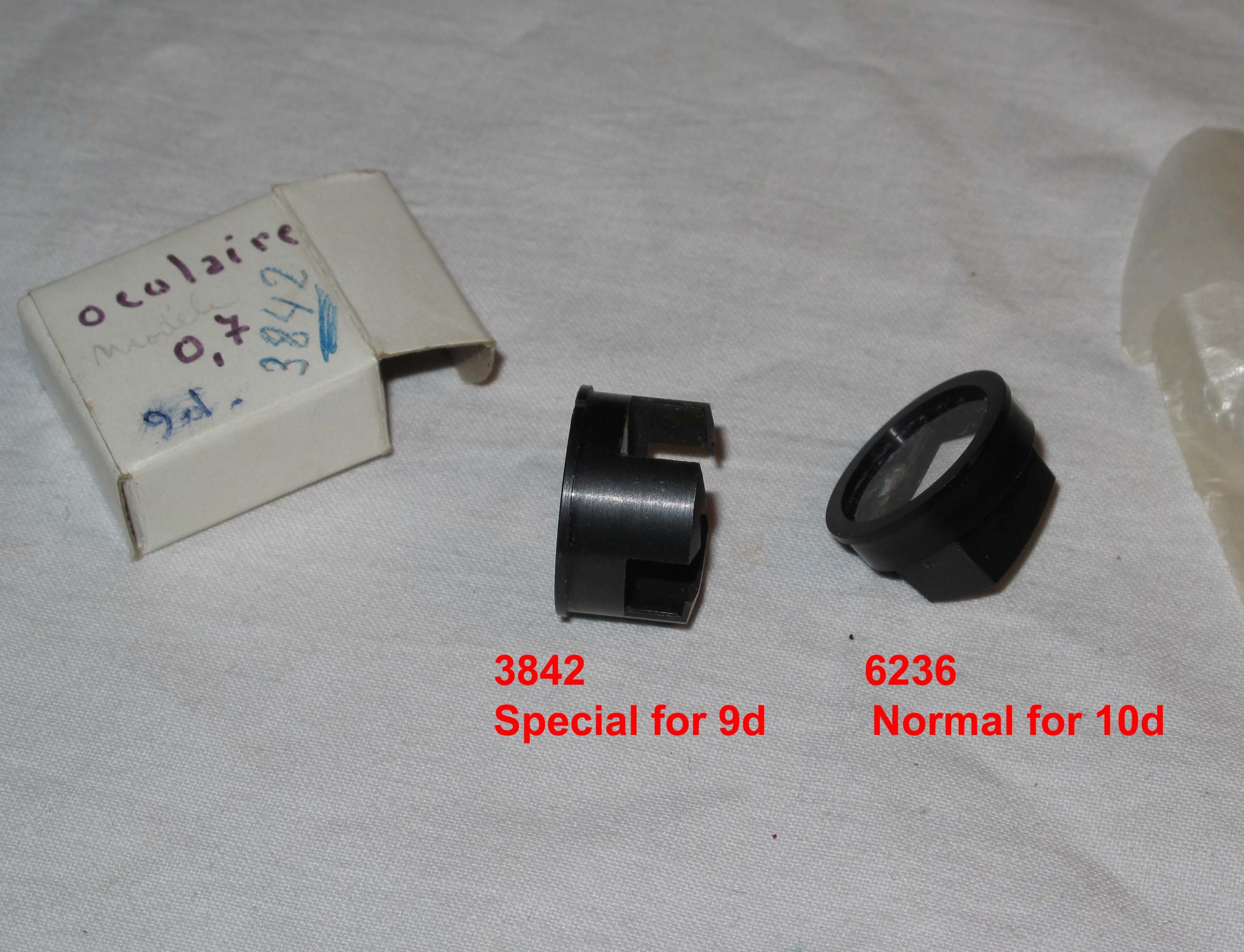

ALPA 10D Ocular Eyepiece
The ocular eyepiece is the glass eyepiece on the outermost part of the viewing system.
I've attached a photo of them.

Thank you! So basically it slides into the viewfinder.
portocar
Apr 11, 2013
yes. look at your viewfinder. you will see a black ring around it. That is the outer part of the ocular eyepiece.
AgX
Apr 5, 2007
29,973
Germany
I know, but did not know any eyepiece that could be interchanged, aside of exchanging complete viewfinders. Thus it is an interesting design.
