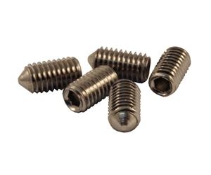

I bought shelves from Home Depot, then put 4 of these captive nuts in each corner:
Then I put grub screws through those and use an Allen wrench to adjust each corner from the top.
I was wondering how you did that. I was going to attach a much larger top anyway so I'll incorporate adjust-ability as well.
