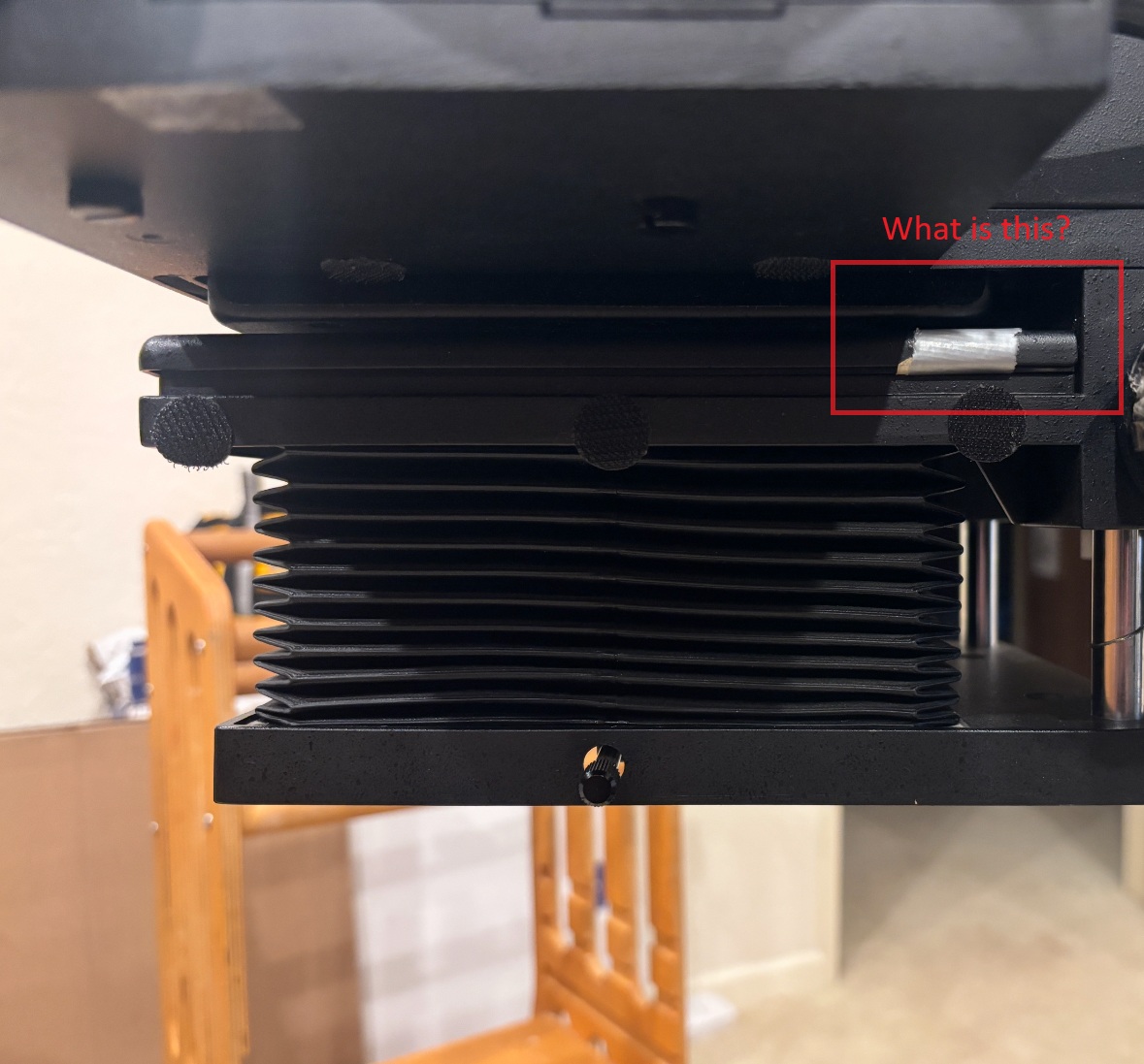

Hard to capture a photos, but here it goes.
The plate below the bellows is slightly tilting upwards (clockwise) relative to the upper metal surface on top of the bellows. If you measure the vertical distance between the corresponding edges, the two left edges are closer by 2mm or so.
I know this isn’t the way you align an enlarger. That simply stood out when looking at it. I haven’t actually been able to print something yet - need to find a big enough cart to roll it into my bathroom.
I called the fellow at KHB and he didn’t seem troubled by that. Said the actual negative and lens stages (inner parts) are very hard to misalign.
The negative and lensboard are ALWAYS parallel in a correctly aligned enlarger. Unless doing perspective control (intentional or unintentional). So, remove the tape.
Sorry I didn't get back in here with any timely advice. everything said above seems good/proper advice, and I too would get that tape gone and see where you end up.
