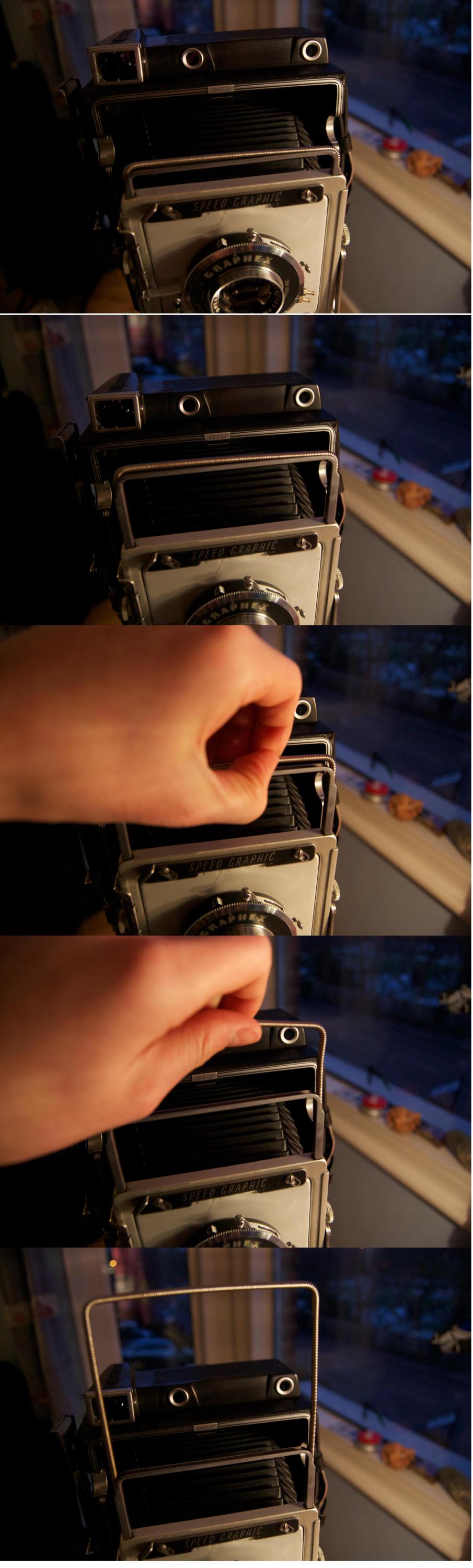

reciprocity
Nov 16, 2011
27
London
Hi,
altair is it the metal frame of the sports viewfinder stuck or is it the wire frame which pops out of the metal frame?

Reciprocity: thanks, that's an excellent picture, btw. On my Crown, its the wire frame which is supposed to pop out of the metal frame that is stuck. I can't do what you show in the photos you attached. :sad:
