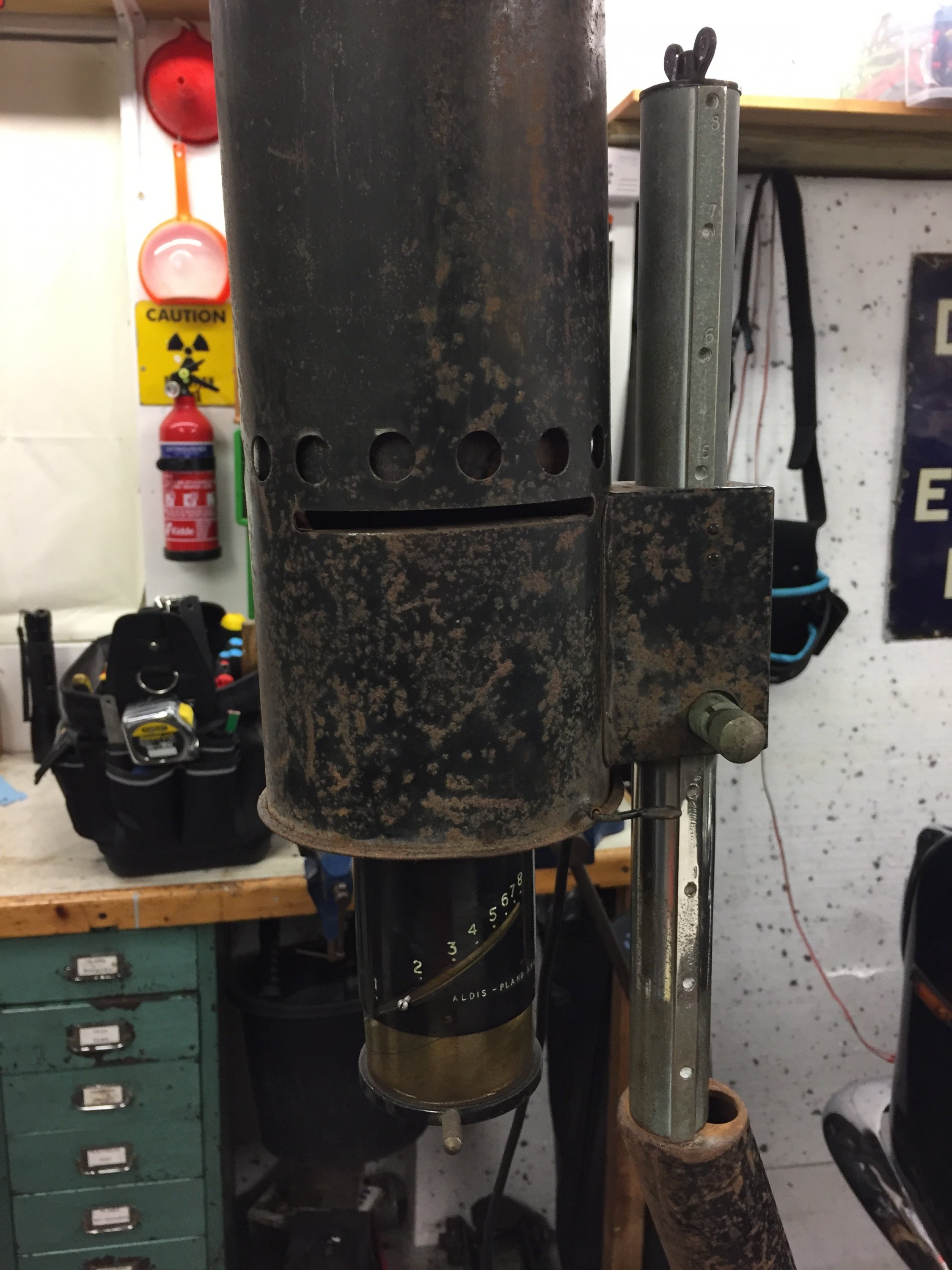

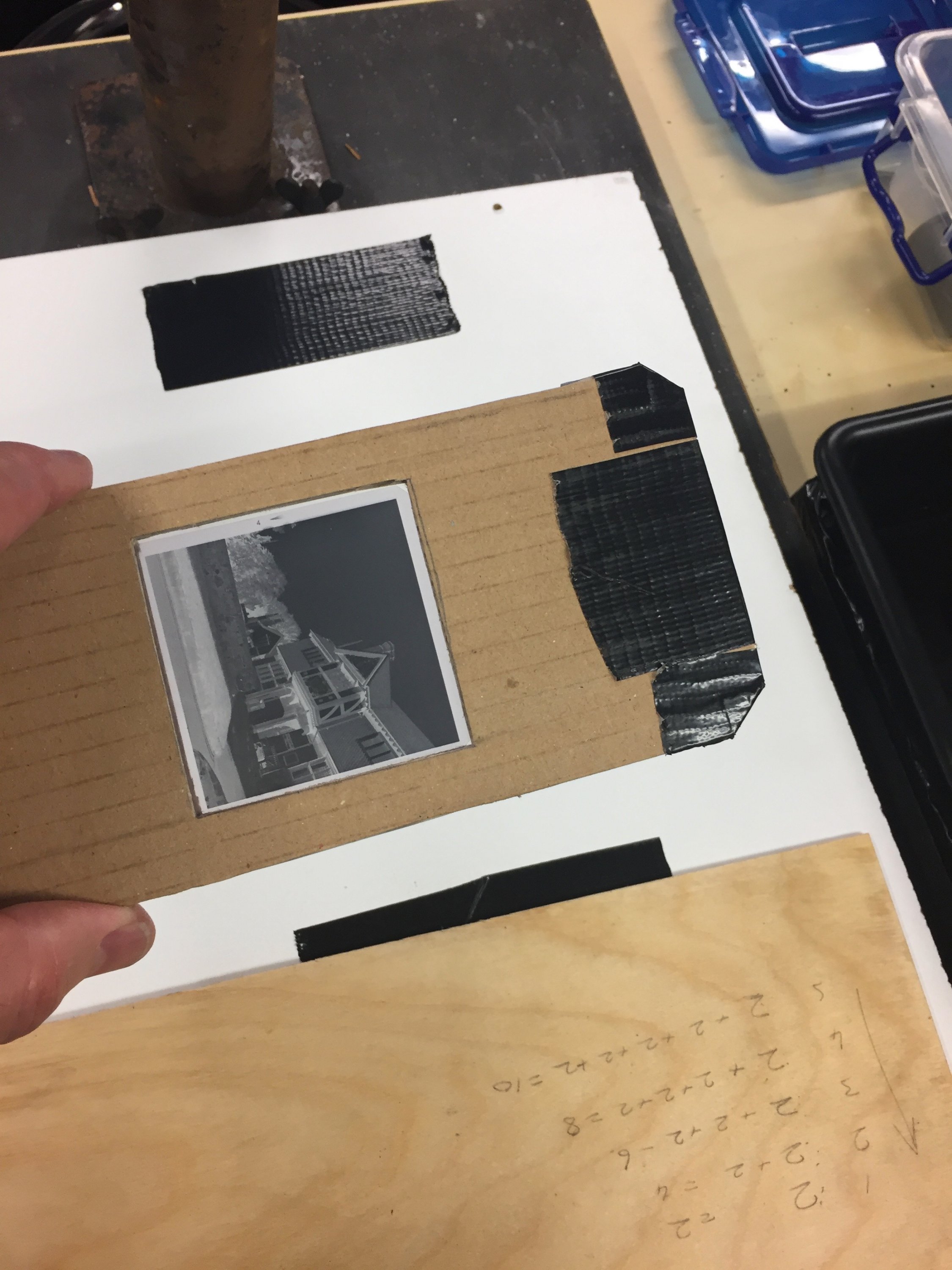

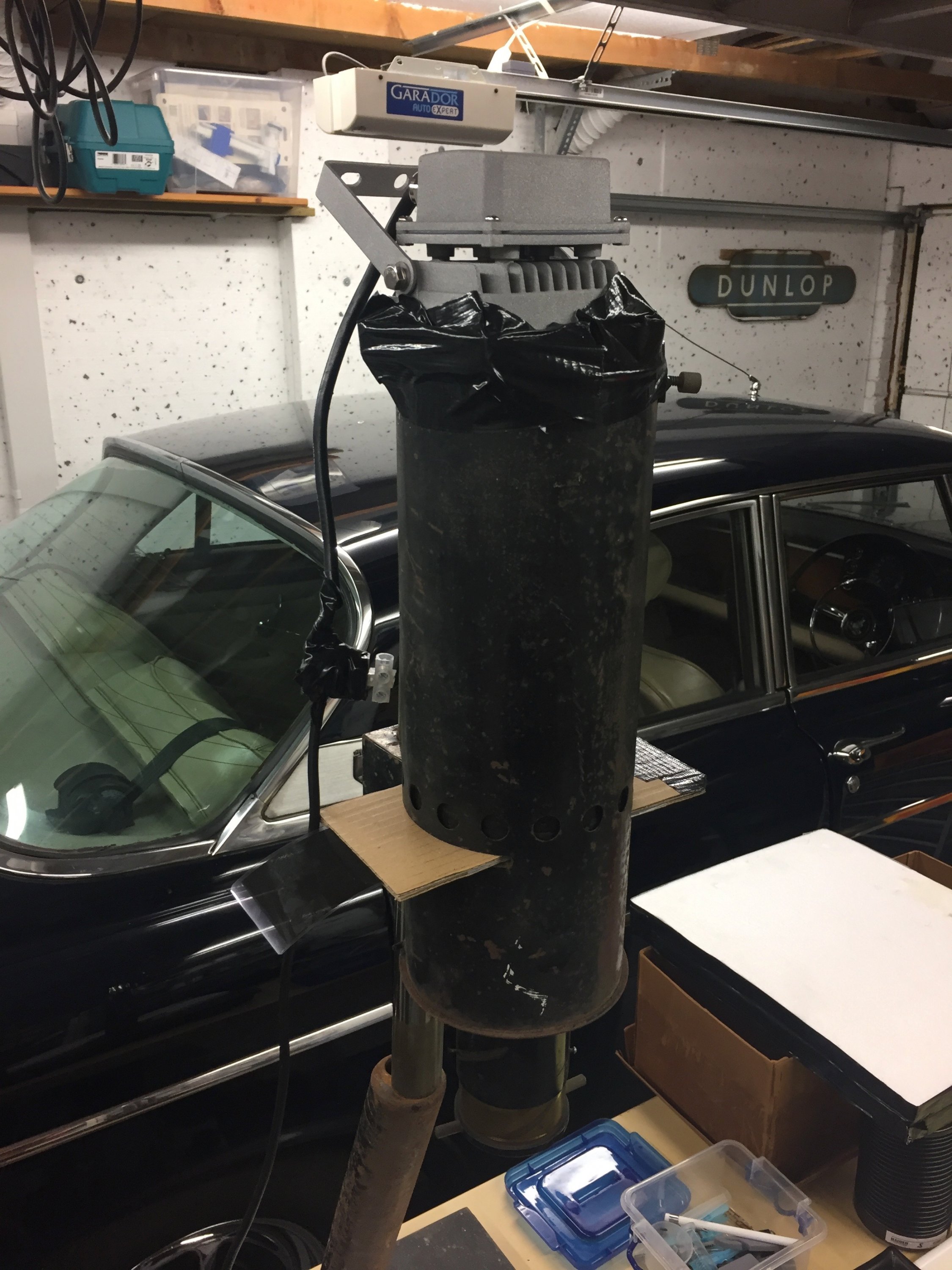

I am a recent returnee to film and have collected a few medium format cameras and a 4x5 MPP MK8 over the last year. I am developing my own B&W films but don't currently have a darkroom. Instead I have managed to make one half of my garage sufficiently light proof to do contact printing after sun-down. Knowing about my new hobby a friend of mine recently gave me an ancient Aldis-Ensign enlarger. I am not sure how old it is but I'm guessing pre-war. After cleaning the optics and bodging a light source with an LED flood-lamp and a quickly fabricated negative holder out of cardboard and an acetate negative film sleeve I managed to get it working at the weekend. It is of course very crude with no iris on the lens and no filter holders but it made surprisingly good prints from 6x6 negs onto multi-grade paper.
I don't plan to use it as a serious enlarger but I'm itching to restore it. Does anyone know anything about these devices? How rare is it? I haven't seen one like it for sale on the bay of dreams or elsewhere else for that matter.

After starting this thread ages ago I have now got some pics of this ancient enlarger. I got it working by gaffer-taping an LED flood light to the top where the bulb holder goes. I improvised a negative holder from cardboard, a negative storage sleeve and gaffer tape (again!). Result, two reasonable prints on Ilford Mult-Grade... I don't know what to do with this enlarger. It is probably quite rare but I would never use it in preference to my DeVere 504! Does anyone collect these things? It would be reasonably easy to restore it.

Nice one. I have a much earlier Houghton King enlarger, it's horizontal rather than vertical, it has the Quarter plate condensers but could take a 5x4 set. Ensign was a Houghton Trade name sometimes just the Ensign logo was used other times the name as well. Houghtons worked with Butcher swho had business links with Aldis, buying Butcher and a few years later (1923) merging them to become Houghton-Butcher. So you frequently find Aldis lenses on Ensign equipment I have an Ensign Speed Roll Film Reflex with an Aldis lens.
It's work restoring your enlarger as items like this get lost otherwise. I might have an advert for your enlarger.

Thanks Ian, do you have any idea how old this enlarger is? It seems to be designed for 120 6x9 negatives which were popular from the 1920's (?) onwards. I have a lot of old family negatives which were shot with 'vest pocket' type folders of that era. I'm guessing this enlarger would have been sold to enthusiasts with this type of camera?
My guess is this is a 1920's enlarger enlarger, I think it's the one listed in a 1924 BJP Almanac Houghton advert, "Aldis-Ensign" vertical enlarger for electric light or gas, a fixed focus enlarger, there's no price or image, as being. The 8 positions for the head on the column and the similar 8 positions for the focus must be the fixed focus, not quite strictly the correct term.
Seems to be a budget enlarger as the similar format Butcher enlarger is very significantly more sophisticated and a lot more modern looking.
