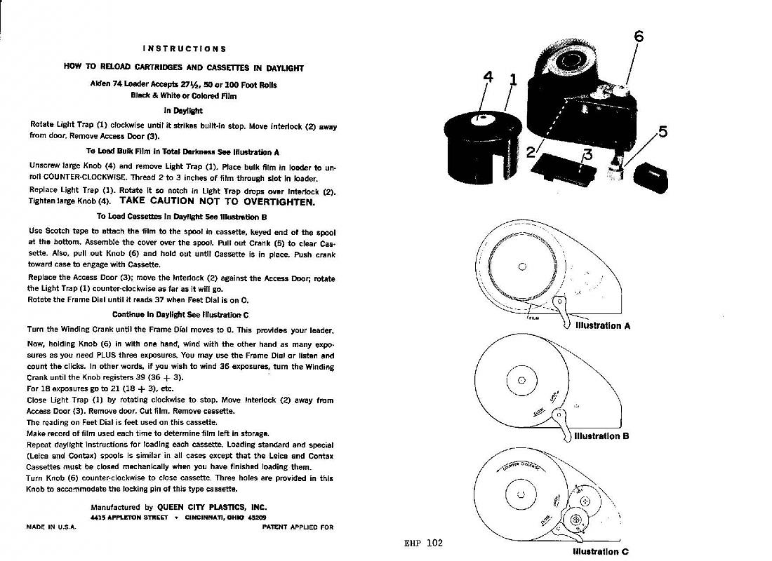

hallo
i´ve got a alden 74 bulkloader without instructions.
does anyone own them, and would be so nice to scan them for me.
thanks for help

I have been using the same bulkloader for many years and I have just dug up the instructions. It's all on one page and is being scanned as we speak. Honestly, there is nothing on there that you couldn't figure out on your own. In anycase, I will post it as soon as I figure out how.
Feel free to ask any specific questions though.
Here's the scan.
Just a few words of advice from my own experience with this bulkloader. I ignore the dials on the side of the loader, they are not accurate enough to be useful. I count the ticks for number of exposures and I start counting from zero. I also add 6 frames to each roll to allow for the exposed portions at the beginning and end of a roll.

hallo
thanks filmbug
fast faster filmbug :D
good light
thomas
You are welcome. I am just glad that I am contributing.
