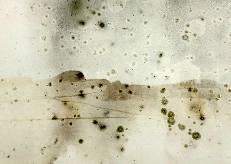

I found that the mixture made using albumen powder was very watery. It whisked into a foam easily enough, but had settled back to a liquid much more quickly than expected - less than an hour. I suspect this may have been a factor in the unevenness of the coating, so have decided to try a new batch using liquid egg white bought in a carton at a local supermarket. This commercial stuff has some guar gum in it, but my reading so far suggests that it shouldn't adversely affect the process (although how well the foam settles back to a liquid is a possible issue).

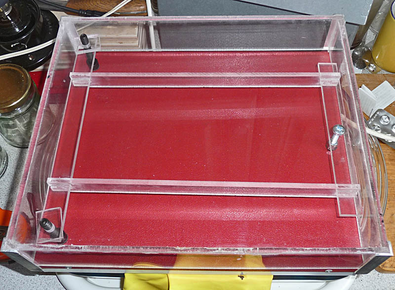

I have also made a plate dryer using a small 12x10" tray warmer. The add-on parts are made from clear acrylic and consist of a support for the plate (can fit one 10x8 or two 6x4s) which can be levelled, and a cover...
The main reason for this is to try and reduce the amount of dust that lands on the plates, both by covering them, and by reducing the drying time. When I did the first two plates above, I noticed some dust had settled soon after they had been coated (a handful of specks per plate), but that there are rather more blotches in the final images. If these are casued by dust, then the covered dryer should reduce their frequency (which would, in turn, strengthen the inference that they're caused by dust). The cover should also help to create an evenly-distributed warm environmant because it will tend to contain warm air inside.

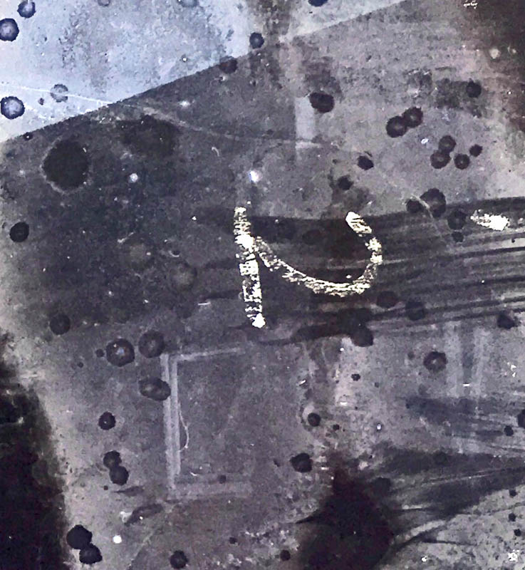

The result is a marked improvement over the first effort. Here's plate 3, with only the colour balance adjusted (it's photographed using a cellphone camera on an LED lightbox, and tends to come out blue) and size reduced...
I suspect the big swirly marks are traces of me moving the glass rod around what was probably slightly less liquid than was ideal. Still, a much more even coating, and better density. Unlike the first one, I could see the image form as the development proceeded. There is also a huge improvement in the blotches that the first attempt had. Some of the dark marks are just dark marks, but some, when viewed up close, are similar to those in the first attempts (dark, with a lighter bit in the middle). I'm currently leaning towards the view that they are caused by the inclusions I saw when coating
I had a close look at the coating before sensitising, and the surface reminded me of reticulation of a gelatin negative. Here's a close-up of a part of the above photo showing this...
I'm pretty sure this is heat damage.
Overall, I'm very pleased with the result this time - a big improvement.
