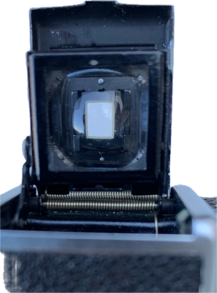

I have a very nice post-war Super Ikonta 521 6x4.5 that is fun to use with the exception of the viewfinder which is quite dark and difficult to use in lower light situations. It seems to be a problem with the front silvered mask element rather than the rear lens. Can I assume that the mask is not recoverable and I should hunt for a parts camera to replace it or is there some magic to "clean" the mask (I doubt that but I'm pretty ignorant of appropriate recovery techniques.) Or alternatively can I desilver the mask and just use it as a standard reverse Galilean without frame lines?

Soak the silvered glass in acetone. It will remove the tarnished silver. In my experience, the viewfinder on the 6x4.5 Zeiss cameras is so sloppy to begin with that within a roll or two you will adapt to the lack of the framing lines in the viewfinder (i.e. full viewfinder is pretty well equal to full frame negative).

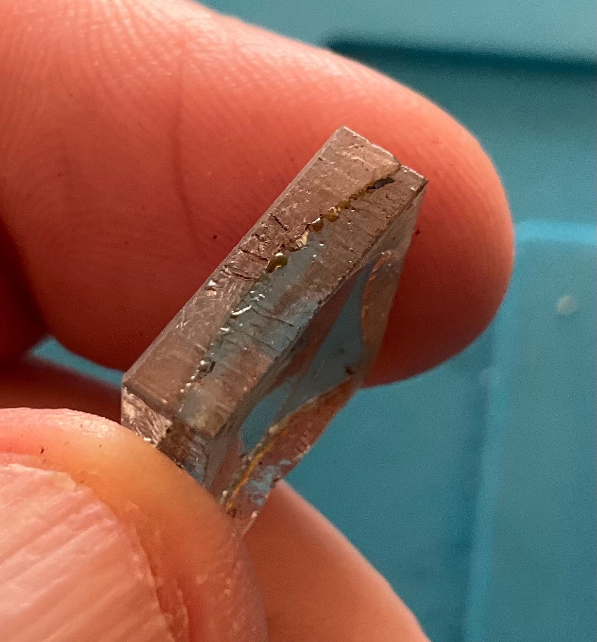

The front lens consists of two glass elements glued together (see photo) — if the acetone dissolves the glue as well as the silver what is the best way to glue them back together?

Will the silvering come with wiping with acetone? I know that I got it off fairly easily and that I didn't need to reglue the pair, but don't remember the actual steps. But yeah, it doesn't look like a good idea to soak the whole thing.
I've used Norland UV-curing optical adhesive for this exact same job.

I had to separate the lens since the silver layer I wanted to remove was deposited on an internal face of the elements. Those elements are now separated so now I need to gently scrub off the silver and re-glue. So far so good!

On Ebay you can buy very small quantities of UV optical adhesive. Even a kit that includes a UV flashlight. I may have actually used one when I did a finder like this? I don't remember.
And at Lowes there is a Loctite Glass Adhesive. I've used it successfully for smaller areas; it might work here. Acetone will dissolve it if it goes wrong (I think it is based on a super glue of some form).

I’ve ordered a UV optical adhesive kit from Amazon, should be here tomorrow. Seems like the major advantage of the UV over the super glue adhesives is that you have time to properly center the elements before the adhesive sets. In any case this is more of an experiment than anything else and I’ve already learned enough to make it worthwhile.

Cemented and installed. The inexpensive UV resin seems to be fine but time will tell. Very easy to apply, I cleaned off the excess with lighter fluid and Kimwipes.
