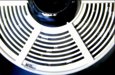

These air-bells are in a Paterson tank after a pre-soak, I found the only way of eliminating them was adding a very slight amount of Wetting agent - one or two drops (exact amount may depend on your wetting agent). the amount has to be minimal as excess may lead to foaming during agitation which can also cause problems.

Does this happen with stainless-steel tanks and reels? I've never had them, and I don't really rap my tanks either. The picture earlier in this thread shows bubbles on a plastic reel. Plastic is usually hydrophobic, whereas stainless steel is more hydrophillic; also, the stainless-steel reels are made of round material which maybe doesn't trap bubbles as much.
