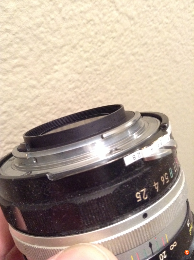

Here's his work. It's really not bad, and doesn't "destroy" the lens, IMHO. If I remember right, he was the original AI person for Nikon out of shop...
Mar 31, 2012
2,408
London, UK
Thank you! I'm sorry to say, but that is a bad job. He just milled the ring.
He didn't even used the original Nikon AI conversion kit. And there are still some repairers in the UK that have some of these kits left.
I wouldn't pay a penny for that lens, it is worthless.

Yeah, there are some people that still have the conversion ring... But not for this lens. Also, I'm sure that there would be a huge discount if I went to trade it in, but the way I look at it is it is a tool. I've always treated my cameras as such - not abusing them, but not hesitating to modify them to better suit my needs. I know it goes against some people's philosophy but I figure that none of my stuff is "museum quality." If it were an ultra rare example or mint I wouldn't have done it. It wasn't though; I paid about $25 for the lens and it has serious wear marks. It now let's me use one of my favorite lenses on some of my favorite cameras (like the FM2, with which this lens did not work).
Sorry for the rant, and I hope I don't come off sounding wrong, I just hate the mindset that your gear can never be modified - it's just gear. If milling it let's you get more use out of it, bully for you. I can see how some would not follow that mentality, but I don't think that should stop others if they so choose.
Mar 31, 2012
2,408
London, UK
No, you didn't!
Personally, I don't like modifications to original specs, not for a monetary reason, but because it robs future generations to appreciate the original article.
It was to bad for Nikon that the AI'd conversion kits didn't include the lens max post lug. It prevents an AI'd lens to be fully used with certain cameras. But, for an FE/FM series or even a F3, it works great.

I have five cameras with F mounts - two "F"s, an F2, an FM2n and a D200. The latter two don't accept non AI lenses, but my photomic head F and F2 sure do. That's why I wanted the ears on top - so that I could use that lens on all of my cameras and not have to carry duplicates of focal lengths simply because I'm using a camera that requires AI and a camera that doesn't. Also, while the coatings may be more advanced, sometimes that isn't always good. I know when I'm shooting portraits of my girlfriend she doesn't always want razor sharp lenses used... Also, I'm a big fan of cheap gear (in case it gets nicked or lost) and even though I'm into that lens for about $75, it is definitely worth it...
@Ricardo Miranda: Exactly! That's why I don't mind the conversion that's offered. I do agree that some things shouldn't be altered from original specs, but a 105 f2.5 is not a rare lens. If it were something ultra rare I wouldn't have done it, but this is a pretty common example... However, using this lens on all my cameras outweighs the "originality" factor.
