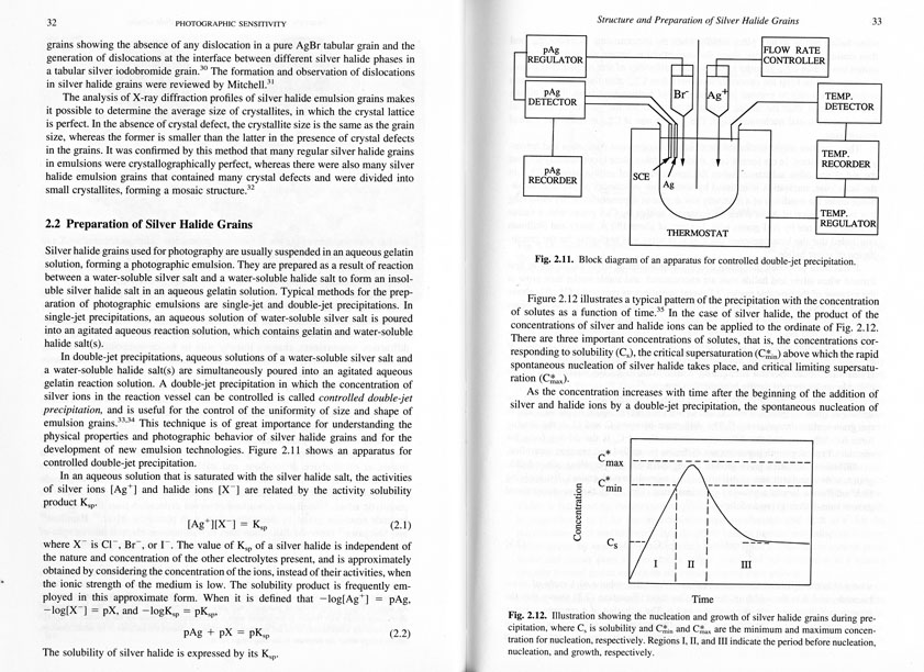

If you are willing and able to plow through the math and chemistry, I can recommend 'Photographic Sensitivity- Theory and Mechanisms', by Tadaaki Tani, Oxford University Press, 1995. Here's a sample page:
I just checked the availability of the Tani book on Abebooks. There are plenty of copies.
If you aren't yet familiar with www.abebooks.com, you're in for a treat. It has a particularly good keyword search engine. (Set a book budget, though!!)
