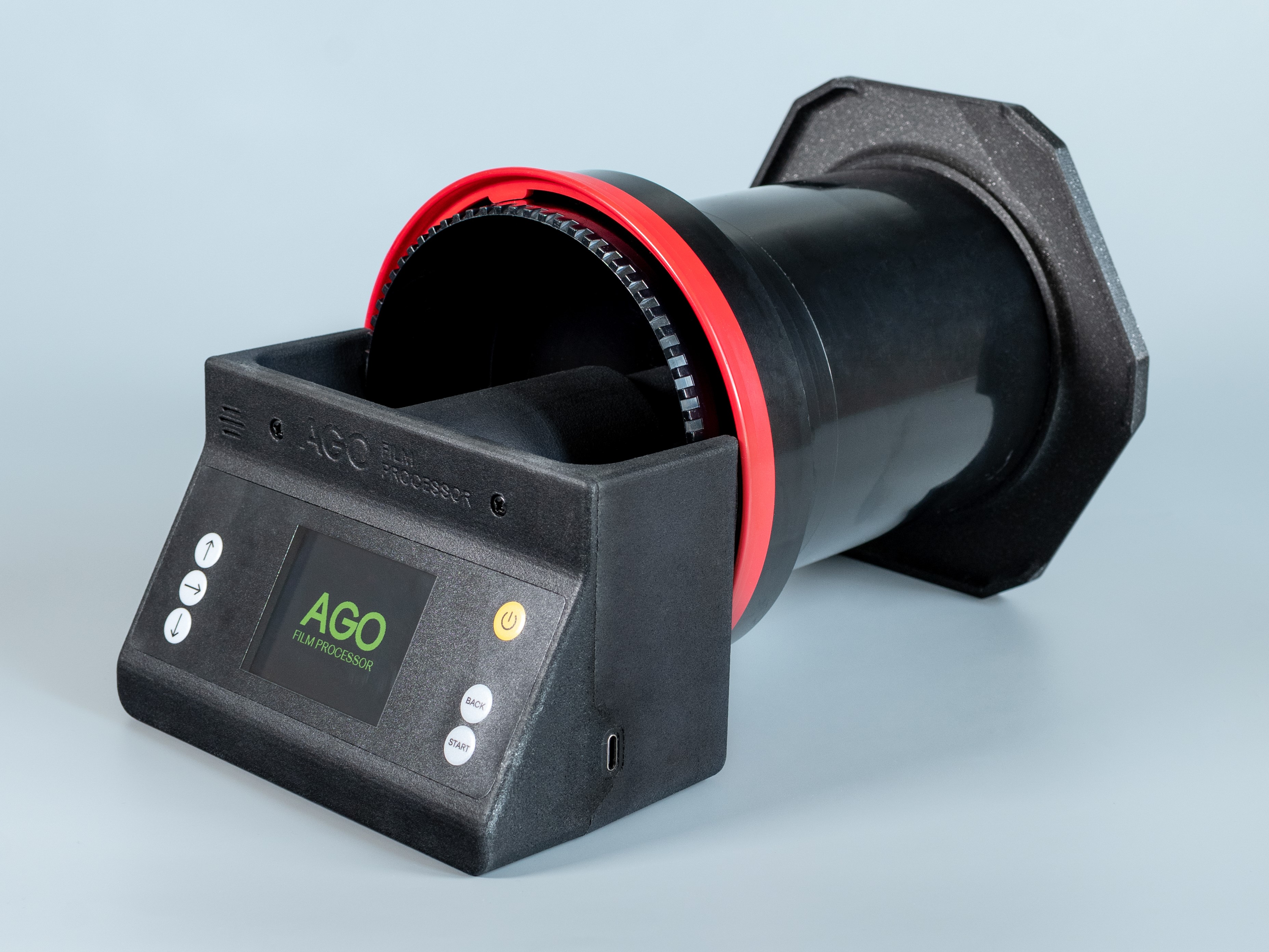

Hello everyone,
I am thrilled to introduce you to the AGO Film Processor, a product born out of over two years of development and my master's thesis. I embarked on this project because I noticed a gap between regular development tanks and the larger, more expensive processors like JOBO, leaving limited options for film development at home.
My vision was to create a processor with JOBO-like functionalities, but to make it compact and at an affordable price point. To achieve this, I chose the Paterson tank as the foundation and incorporated automated agitation using a small DC motor.
Almost like a processor all ready, but temperature control was missing. Through extensive research and collaboration with mathematicians, we developed an algorithm that compensates for time during development, taking into account the different temperatures specified in ilford B&W and Tetenal C-41 datasheets. This breakthrough allows for flexibility, such as a C-41 developer temperature can range from 30 to 38 degrees Celsius (86-100°F).
Few days ago we launched a beta sales campaign in Europe, offering approximately 30 units to individuals who are open to sharing their experiences with us. We invite you to be part of this exciting phase, where we can work together to refine and improve AGO further. Rest assured, all beta units come with a money-back warranty if they do not meet your expectations. Additionally, if any components malfunction or fail to perform as expected, we will promptly replace them or request the unit to be returned for us to rebuild and send back to you. While AGO has proven to be stable so far, we remain dedicated to addressing any unforeseen challenges that may arise.
To learn more about AGO at at https://vintagevisual.eu/.

Looking at the photo, my first thought was "how does this not leak all over the counter" -- and then I realized, the tank will be stationary, only the core and reels will rotate. 👍

I still wonder how it doesn't leak. I've never turned my Paterson tanks horizontal with any solution in them, but it doesn't seem like you could have much in there and stay dry with the way the tank mounts it mounts. It would be helpful if the OP would speak to this.
Wondering the same thing. I noticed that there is a kind of gasket on the lower half, but usually a gasket needs to be compressed in order to seal properly.
If it was like the front loading washing machines that have the drum at an angle so that it doesn't spill, then I would understand a bit better, but this is not the case.

To use it, the funnel in the Paterson tank needs to have three holes drilled in it - I assume to match how the unit connects to the tanks.
Yes, that is right. Like you do it with Paterson stick.

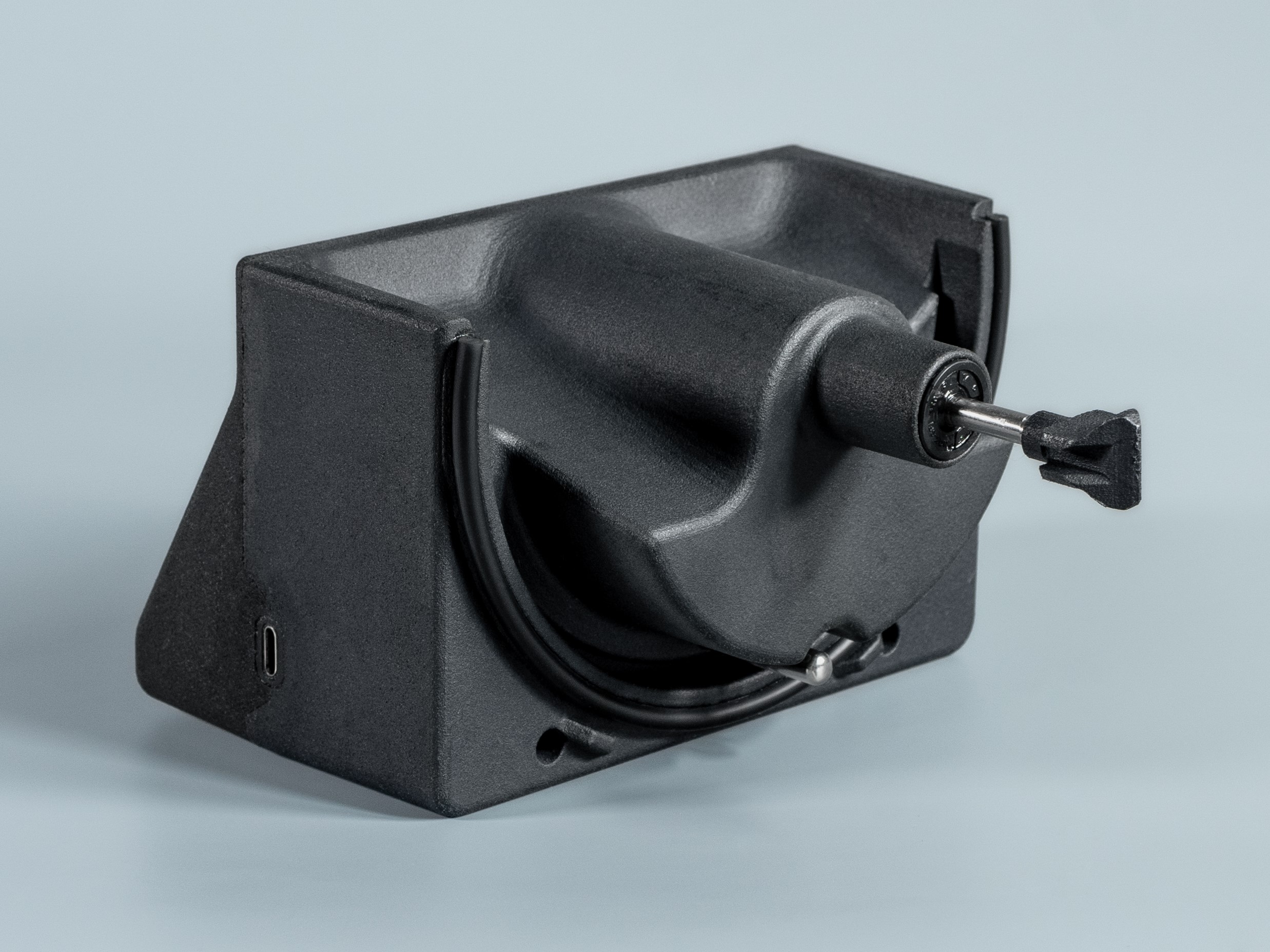

Thanks for asking. The processor has O-ring seal which seals it(look second picture). And you don´t have to fill it up all the way as it is rotary processor now, like JOBO. For instance 2 reel Paterson tank needs 350ml(11.9oz). This also saves chemicals compared where you fill it all the way full. These YouTube videos explains a bit How AGO works & Project introduction
That is correct, there are three holes, but this is to allow in vertical position to run chemicals to the tank so it can be filled up easily. Otherwise it could get in only through the center hole. This is also important to get temperature reading of the liquids for the temperature sensor.
Yes, correct. There is a gasket (O-ring) which seal it to Paterson tank, from the same inner diameter surface like Paterson lid. In a video you see how I attach it to tank: How AGO works

Where do you drill the 3 holes in the funnel and still maintain lightproof integrity?
Yes, it is still lightproof. I have tested by showing light into it and didn't have any problem with film. It is so because the holes are in upper part of funnel where light gets anyway. Also to mention, drilled funnel can be use in any situation, even if you don't develop film with AGO.
