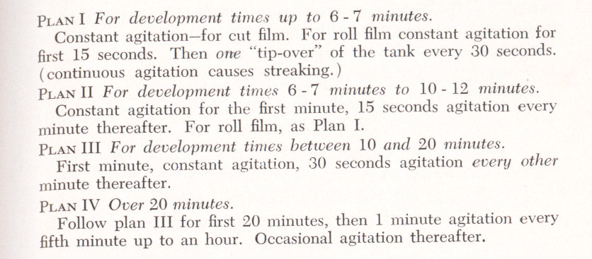

Everyone knows “Kodak Agitation”, and a key part of that is to agitate for five seconds on thirty second intervals. I have that in muscle memory.
But my plan has always been after a certain time, I switch over to five seconds on one minute intervals.
I want to say it’s fifteen minutes but it might be thirteen.
Does anyone know a reference for the plan, or should I just call it fifteen minutes?

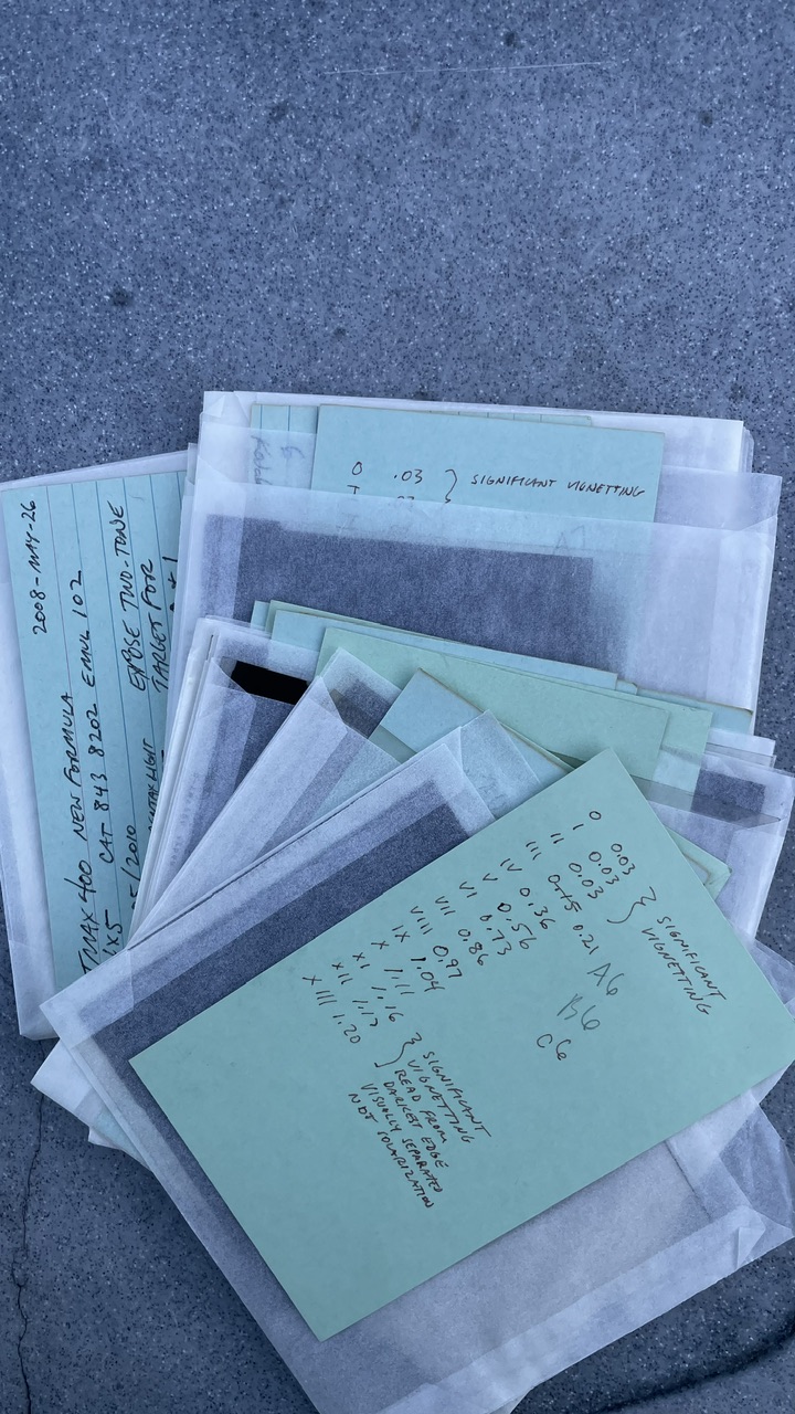

I found vintage green 3x5 cards with notes. This is the set where I tested TMY2 at EI 64 -- a fabulous speed to shoot it at by the way. But the card I’m looking for isn’t in here.
