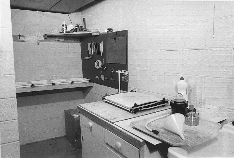

One of my first 'Professional' darkroom items was a brand-spanking new Patterson tank that I got in 1973. I followed the instructions which indicated to use the twist handle to help de-air the film and then put the lid in place and use inversion for agitation.
The SS tank was my brothers. We took divergent paths from the start. SS vs. Plastic; D-76 vs. Michrophen; TLR vs. SLR; Polycontrast vs. Kodabromide, etc.
