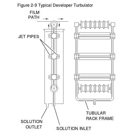

I apologize for not correctly understanding the notion of processor.
For me, it's something like a film developers, mini-lab.
The manual development dose I'm not using for notion of the film processor.
A pump to operate on a developing machine must be placed below the solution level (to be primed) and have a uniform solution distribution system in the cuvette.
A pump that pulls out the solution and puts it in one place will never have a uniform agitation for film.
Processing KODAK Motion Picture Films, Module 2Equipment and Procedures page 2-14
https://www.kodak.com/uploadedfiles...t_en_motion_support_processing_h242_h2402.pdf
