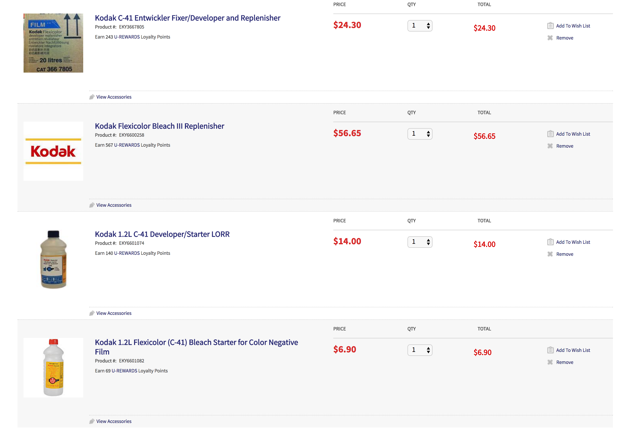

I'm interested in creating my own c41 colour chemicals, as opposed to buying the tetenal/unicolor, or similar kits. I would like to get away from using blix, as well as lower my costs. Am I correct that this is a good approach/should get me started? (see attached pictures)
I have stab left over from a unicolour powder kit, so for the time being I will just use that. But I suppose in time I will need to buy that separate as well.
I am also somewhat interested in buying the chemicals themselves, in bulk, and mixing myself, but I find that somewhat daunting and am not totally certain how I would approach that beast.
Thoughts?

I have a feeling you really mean that you are putting together your own C41 "kit" from individual, commercially manufactured and pre-made component chemicals, not "creating" your own chemicals.
"Creating" chemicals usually requires laboratory techniques.
It is a great idea - have you seen the sticky thread on just this subject? https://www.photrio.com/forum/index.php?threads/list-of-color-chemicals-and-where-to-get-them.79069/
Correct. Haha. I did take a look at the sticky. I'm a little bit concerned at the huge quantities, though. While I shoot a lot, it's still for personal use, so buying 12L of developer for example seems a bit crazy. Hence why I was looking around at these smaller packages. That said, I just noticed that the kodak developer I have showing up above makes 20L, so maybe I'm missing something. Will these chems last long enough for me to actually use them without going bad? How can I buy commercially manufactured, pre-made component chemicals individually, in quantities that make sense for personal use? In addition, I noticed you are in Canada. I'm in Alberta. Do you have any advice based on our location (where to purchase, etc.)?
