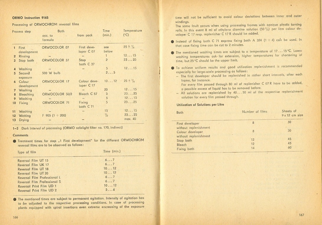

I have home the book of Orwo Formulae from ~ 1984-1985.
From what I remember, ORWO color processes (negative, positive and reversible color) use TSS.
Through 2000, when I was working at the Laboratory Mogosoaia (cine) TSS that I still had in stock by ~ 1990 shows all too bad (oxidized).
Make sure you find (you) TSS used to have a hope of a reasonable result.
ORWO 9165 process will give it to you.
George
James1
Jun 25, 2012
59
United Kingd
George, thank you for posting the relevantOrwo 9165 pages. I have the equivalents in German (from my 1983 book) but I've never seen these in English, and there are severa good hints as to processing which I can now try.
The CD-1 (TSS) that I have is new (few months, kept in sealed dark glass bottles) so hopefully should be OK - it was last time I used it!

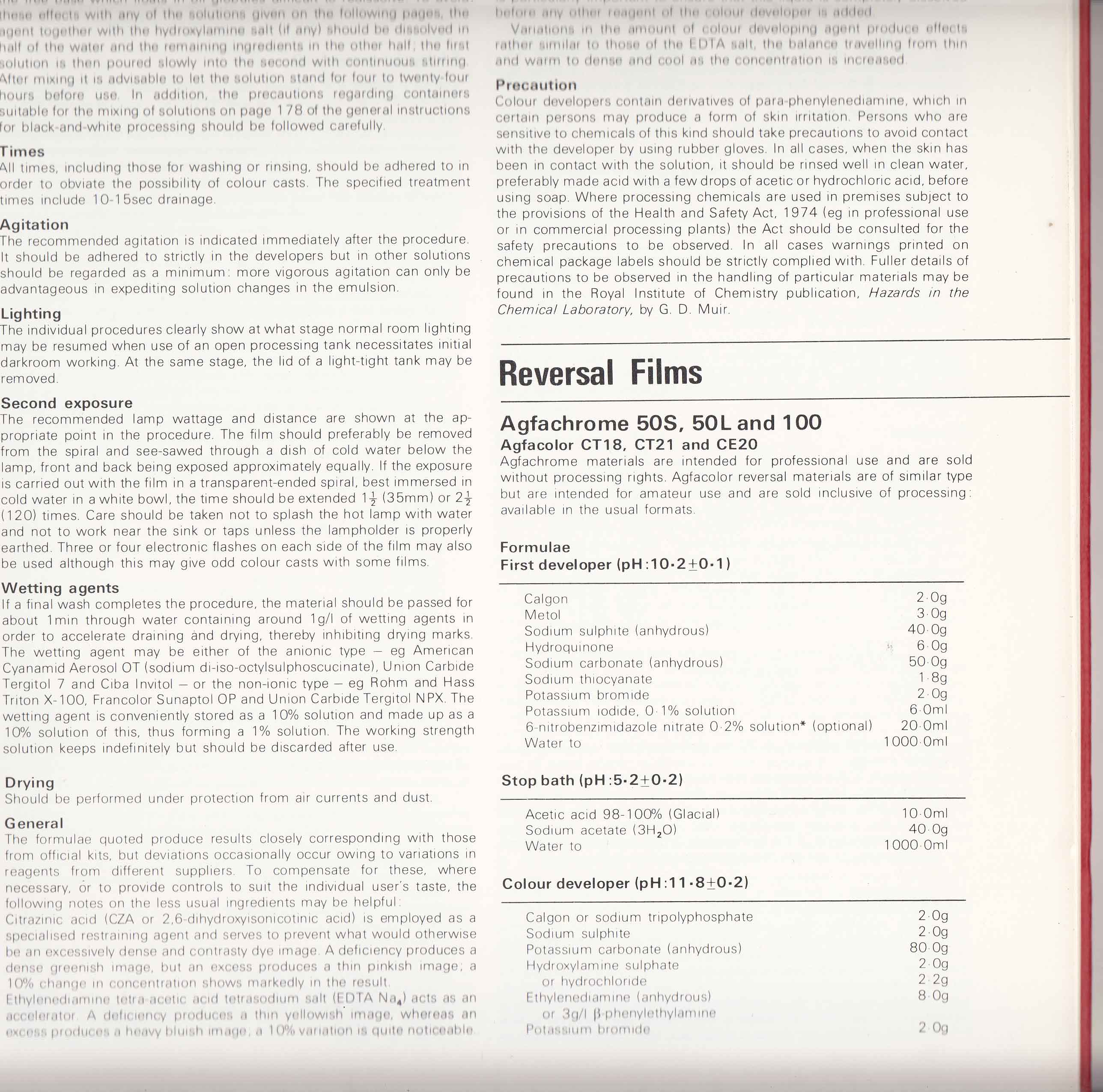

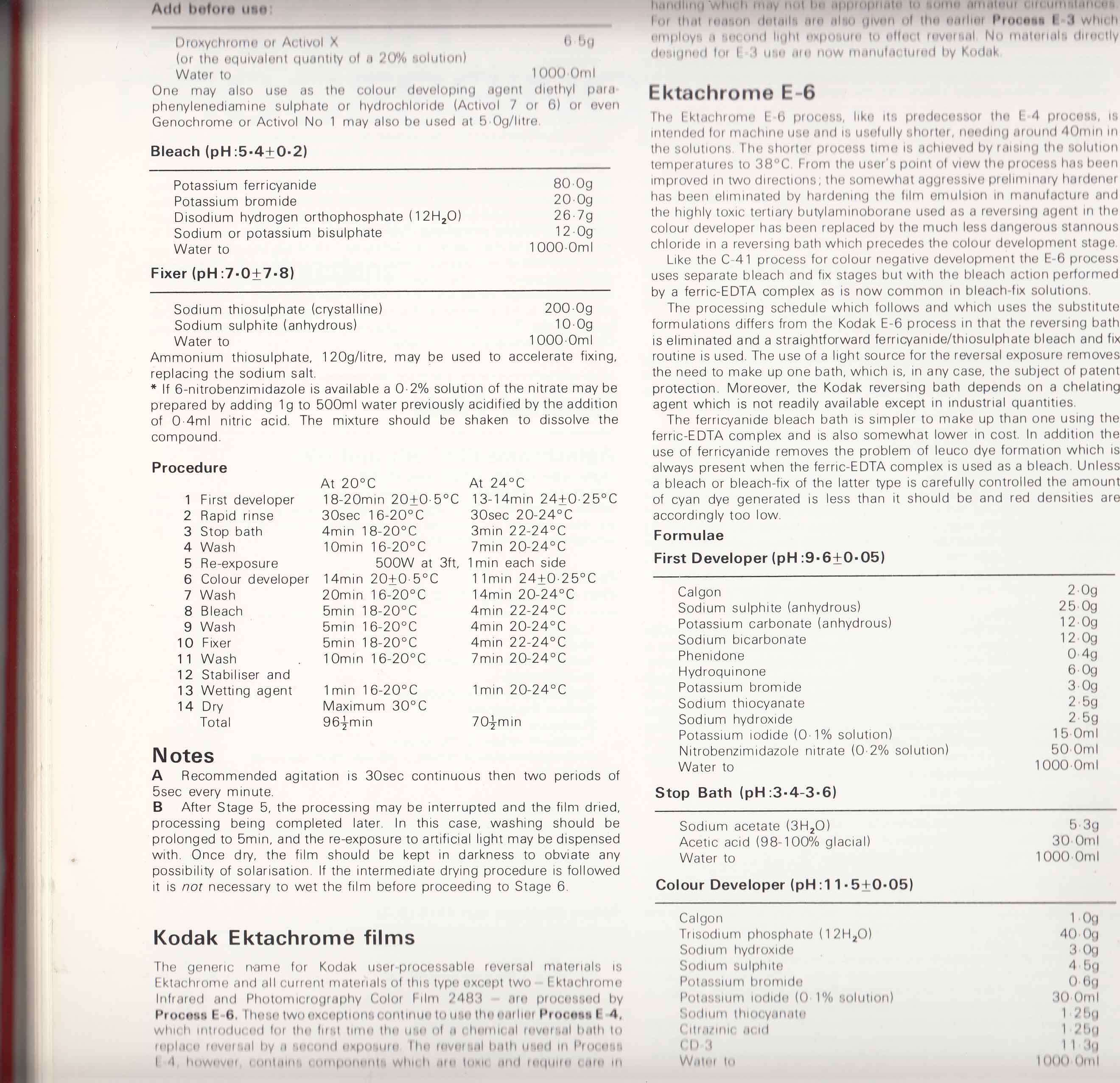

This might be of interest to you
