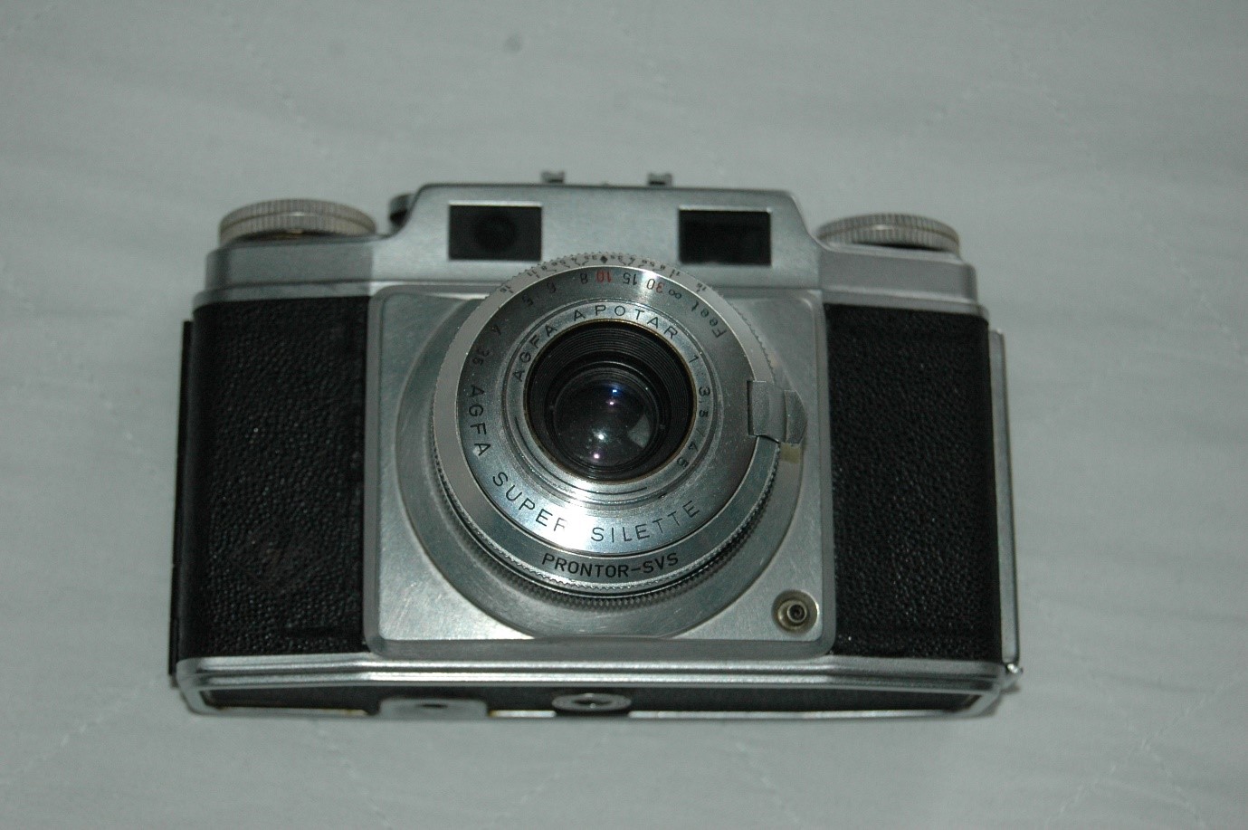

I have recently bought a Agfa Super Silette and would like your thoughts on it.
It is in very good condition, lens is Agfa Apotar 1:3.5 / 45 (Prontor SVS Shutter) which is clean & focus is smooth as butter !!
Case is good too.....
Film I am using is Ilford FP4.
Is there anything I should know or be aware of with this camera??
Thanks.

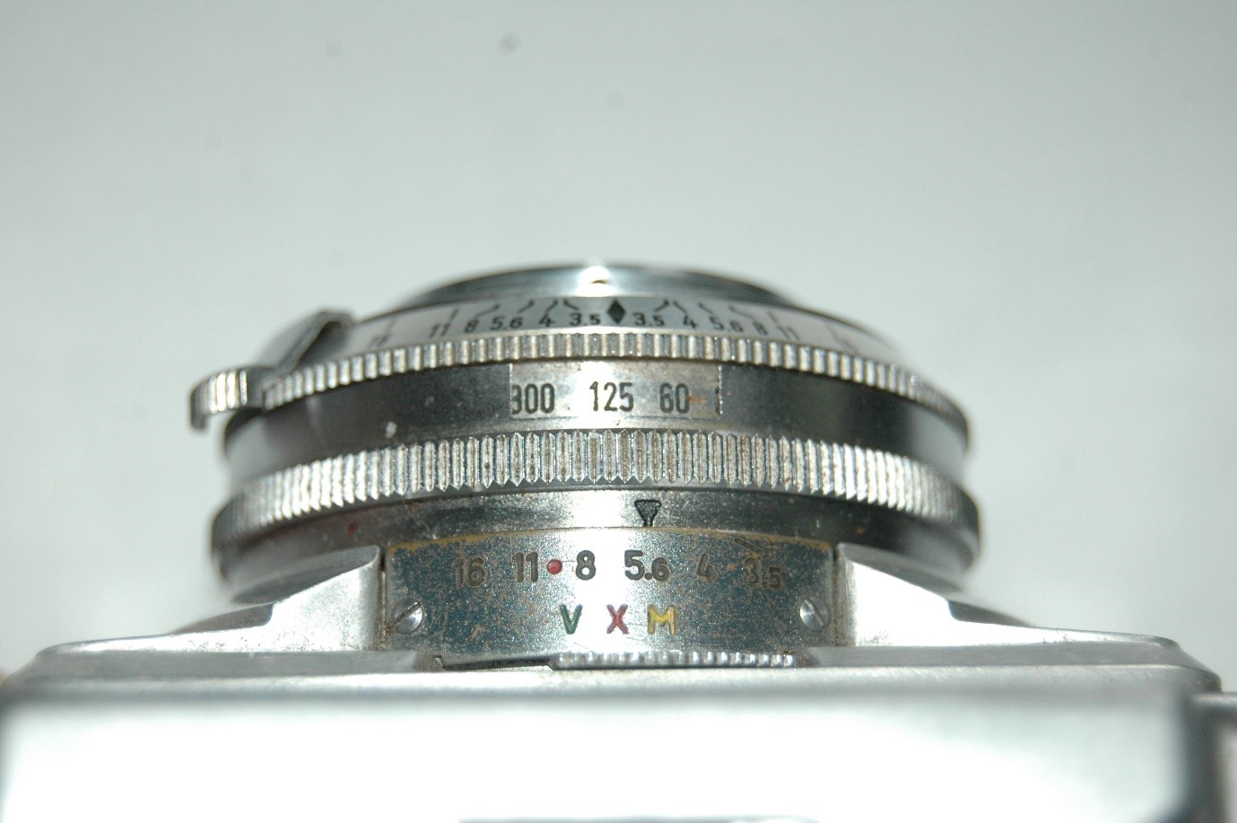

The Prontor SVS shutter is reliable, however it has a quirk in that the same mechanism is used for flash sync selection, M delay and the self timer. But I think the camera defaults to X sync with the self timer in use so not a problem (unless you are going whole hog vintage with flash bulbs).

Here are some pictures....
Thanks Nicholas, yes it is an earlier model - see pictures...

Also, if I did decide to use ye olde flash bulbs, how much of an issue would that be ?? (I have an old Agfa flash bulb flash unit I hope to use at some point).
