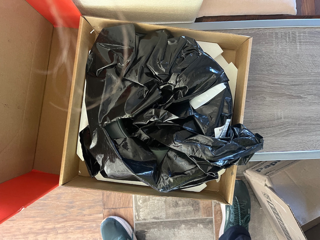

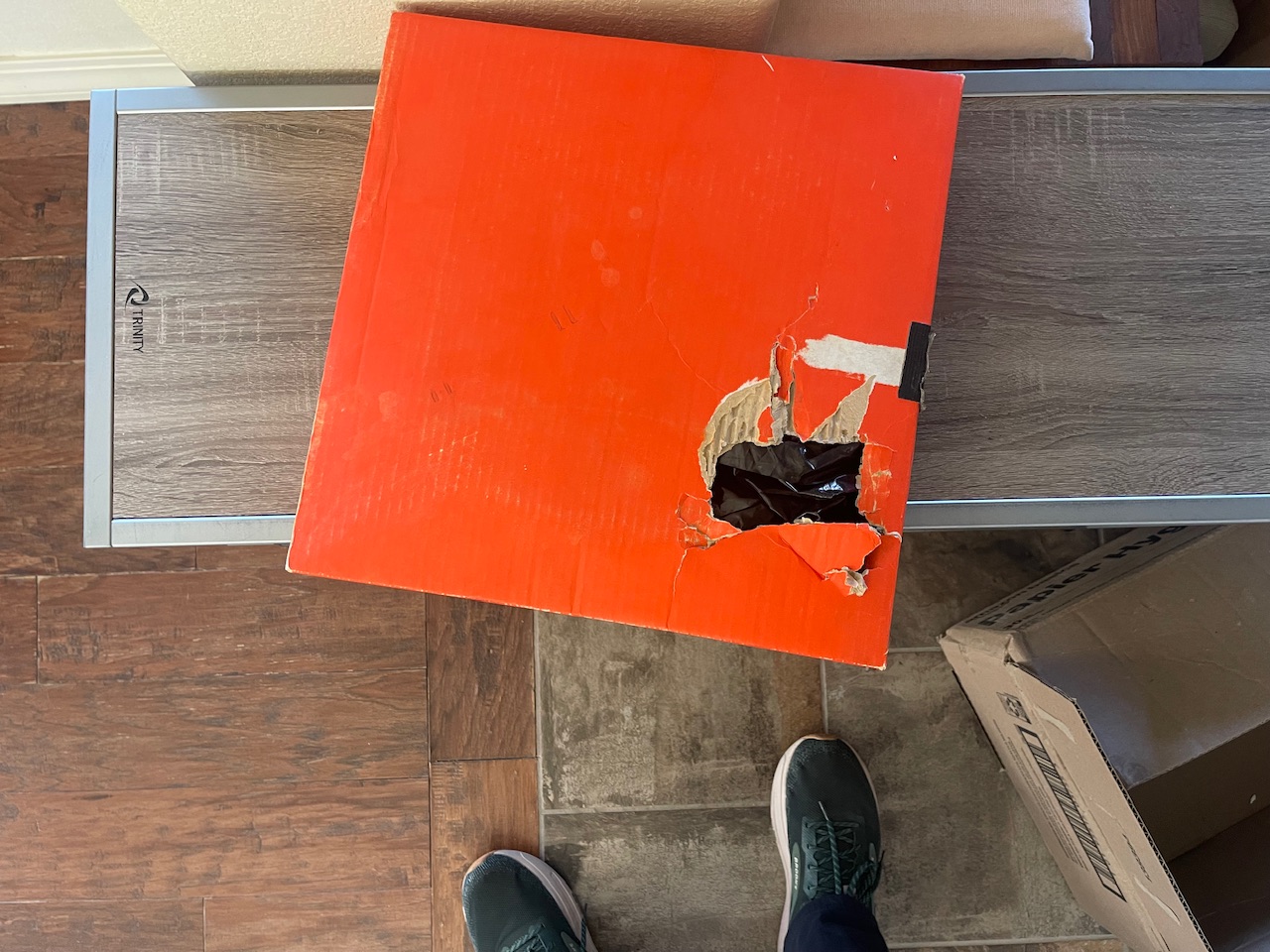

Ok yeah this film is fucked.
Don’t write it all off before you’ve tried it. I have received multiple bulk rolls that have been opened by customs or exposed to full daylight and I have saved most of them. The tightly rolled film keeps the light out and you should get good film after about half a dozen unwindings . One was 9 inch aerial plus x. The other was a bulk loader. When I opened the package I saw film flopping around inside the holder I shut it in a hurry and after two rolls I got film that was more than half good. It turned out to be Panatomic X. Later rolls were fine and that film hardly ages
A tight roll breifly exposed to light might have a chance, yeah. But unfortunately this film wasn’t in a tight roll when I received it, I don’t know if that’s how it’s normally packed but the roll was very loosely wound. It also wasn’t on a daylight spool, which is what saved that plus-X. That and the fact that the outer box also has a giant hole in it, not just the bag, made it exceedingly unlikely any of this film was salvageable.
