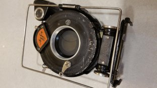

I have a very nice looking Agfa Standard folding camera and the focus lever is stuck due to the dried grease. I have read that this is a common problem with these cameras.
I have taken the front standard off the camera as an assembly, but now am not sure how to remove the shutter from the focusing unit.
Has another member done this work before and could share how this is done?
It would be nice to get this camera up and shooting again! :D
Thanks for the help.

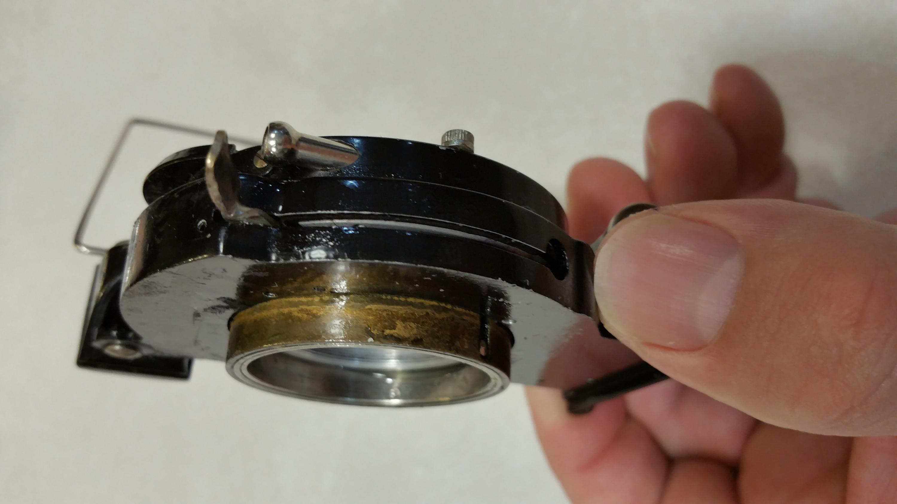

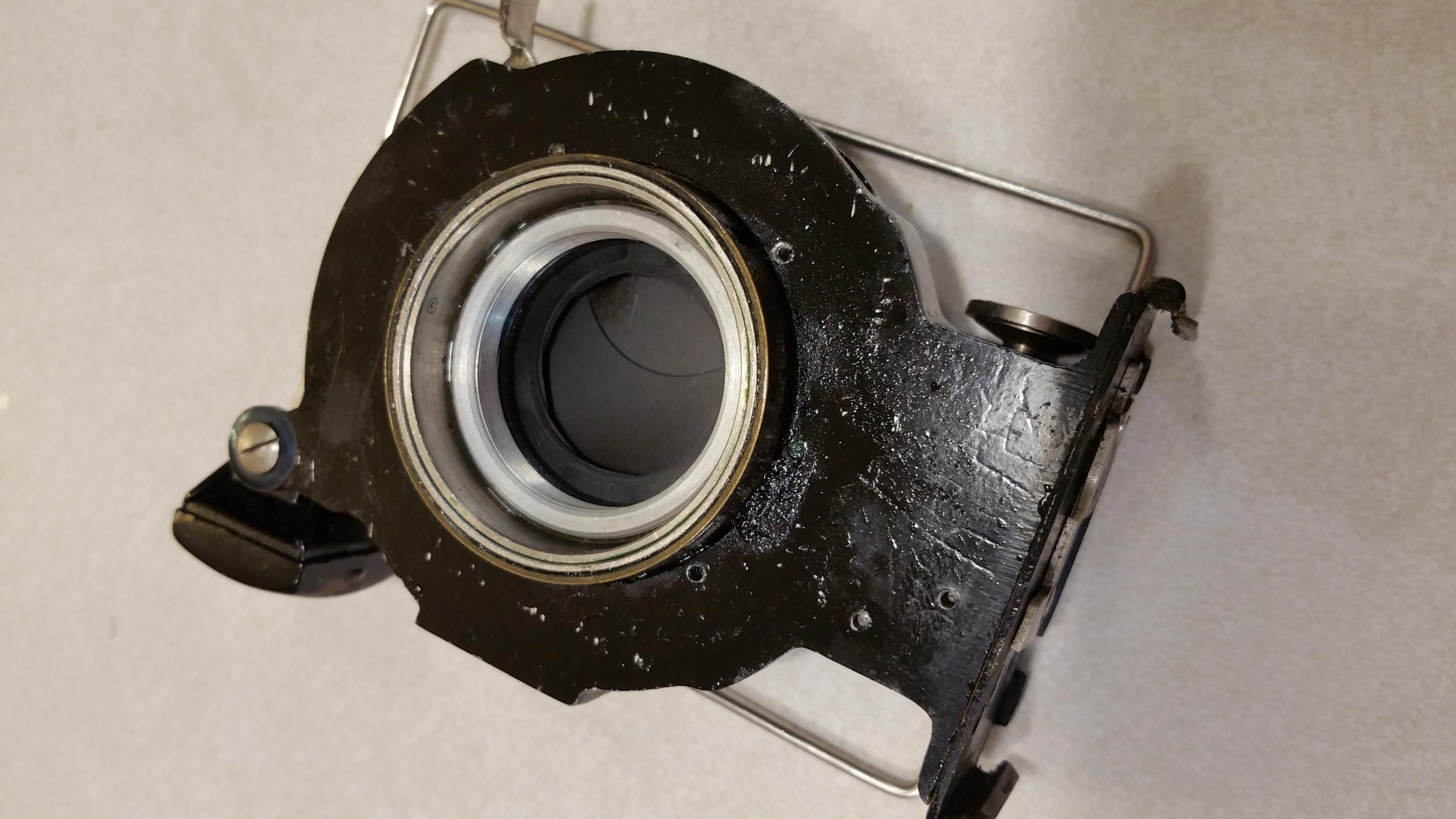

Here is a different angle of the same thing. Yes, I did remove the front and rear lens elements. But, where to go from here? The next step is not clear to me. No obvious things to unscrew.
It almost seems like maybe I have to open the front cover of the shutter and get to some screws from there to release it from the focusing unit?
attachment.php
I have some Ronsonol fluid in areas in back that appear to be stuck. Tonight I would like to get it apart after it soaks today.
Seems like a mystery so far.

What you are calling the focusing unit IS the shutter housing. To get at the gummings, you need to remove the front plate which is held on by the Agfa logo at the top, the shutter release lever and (probably) three screws.

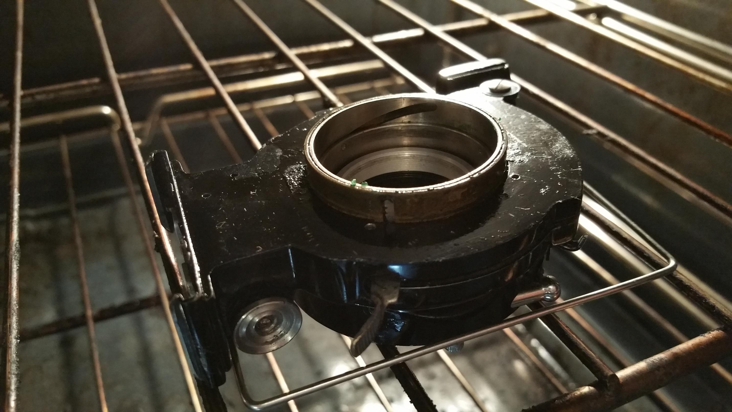

The focus is now free! Following advice of using some heat, I baked the shutter at 180 degrees for 10 minutes, basted it and made to sure to turn it evenly. I added some salt, seasoning, etc......
The grease thinned out and I was able to move the focus. Most of the old grease is now cleaned out and now ready for fresh lubricant.
I will leave the shutter alone since it is working consistently at all the speeds. The lens elements are clear and scratch free. I hope to get this camera up and shooting soon!
