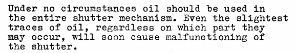

also the manufacturer manual is at https://learncamerarepair.com/product.php?product=86&category=2&secondary=35 note that it metions oil in this image copied from the book.

Thank you Charles. I will review this information with great interest. Like Nicholas I have a few failed repair projects in my past so it really doesn't take a lot of reminding to convince me that paying someone is usually the better part of valor. Though I am naturally a bit of a skinflint I really don't mind spending my money when it is appropriate. This camera and lens is definitely worth rescuing.
As for oil, I shall immediately ban it to the garage and not allow it near my cameras. 🤣
